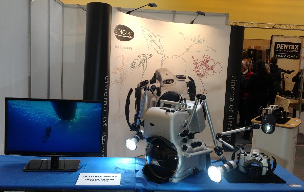

  7. Well, here is the first picture :-)

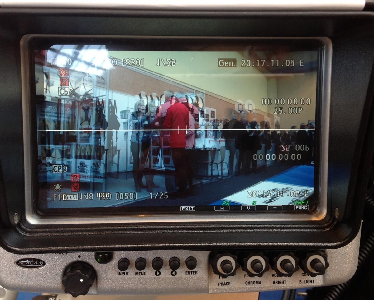

  8. Here is the full control and editing 3D monitor
    Edited by SEACAMFRANCE
