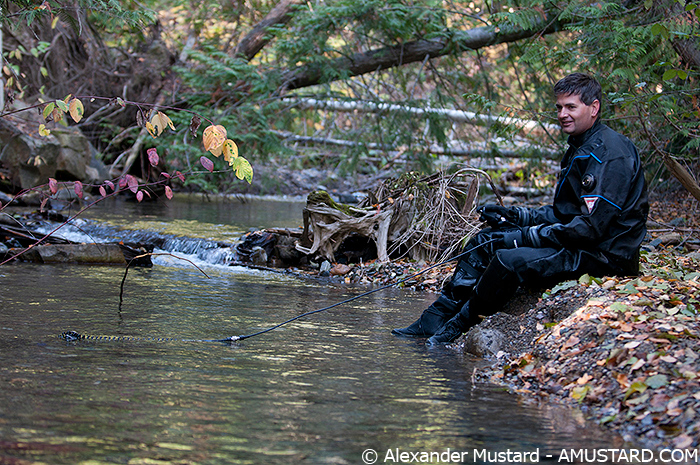

  3. Here is a photo of the Aquatica remote trigger that Liz mentions, being used by Todd Mintz on our salmon shoot a couple of years ago:
    One of the first lessons you learn from any sort of remote or pole cam photography is that if you can possibly be in the water with the camera - then be in the water.
    Alex
