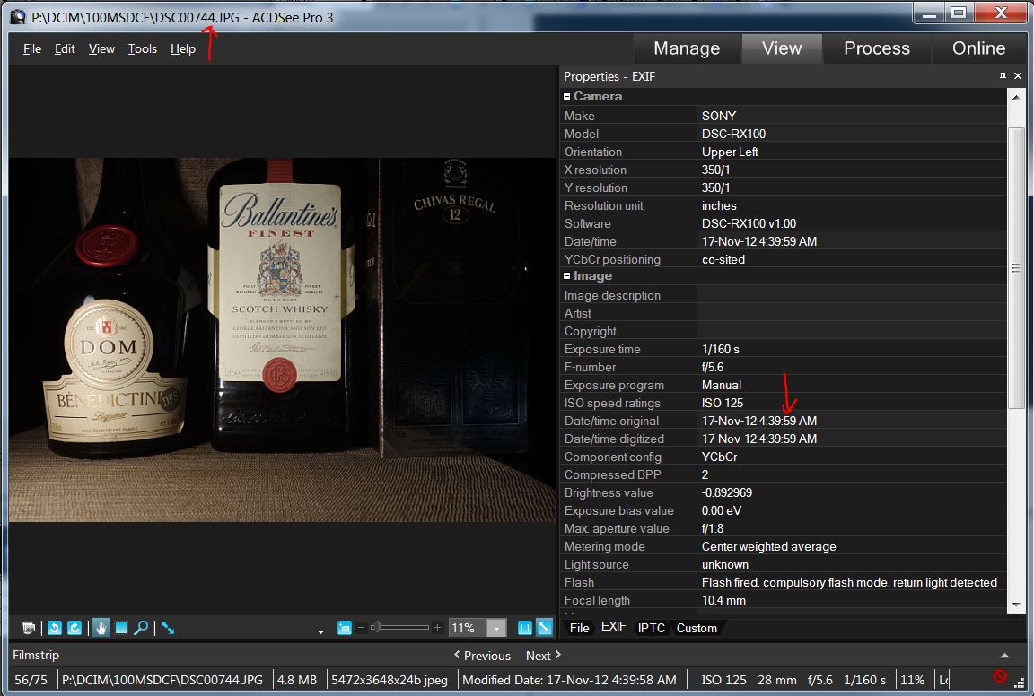

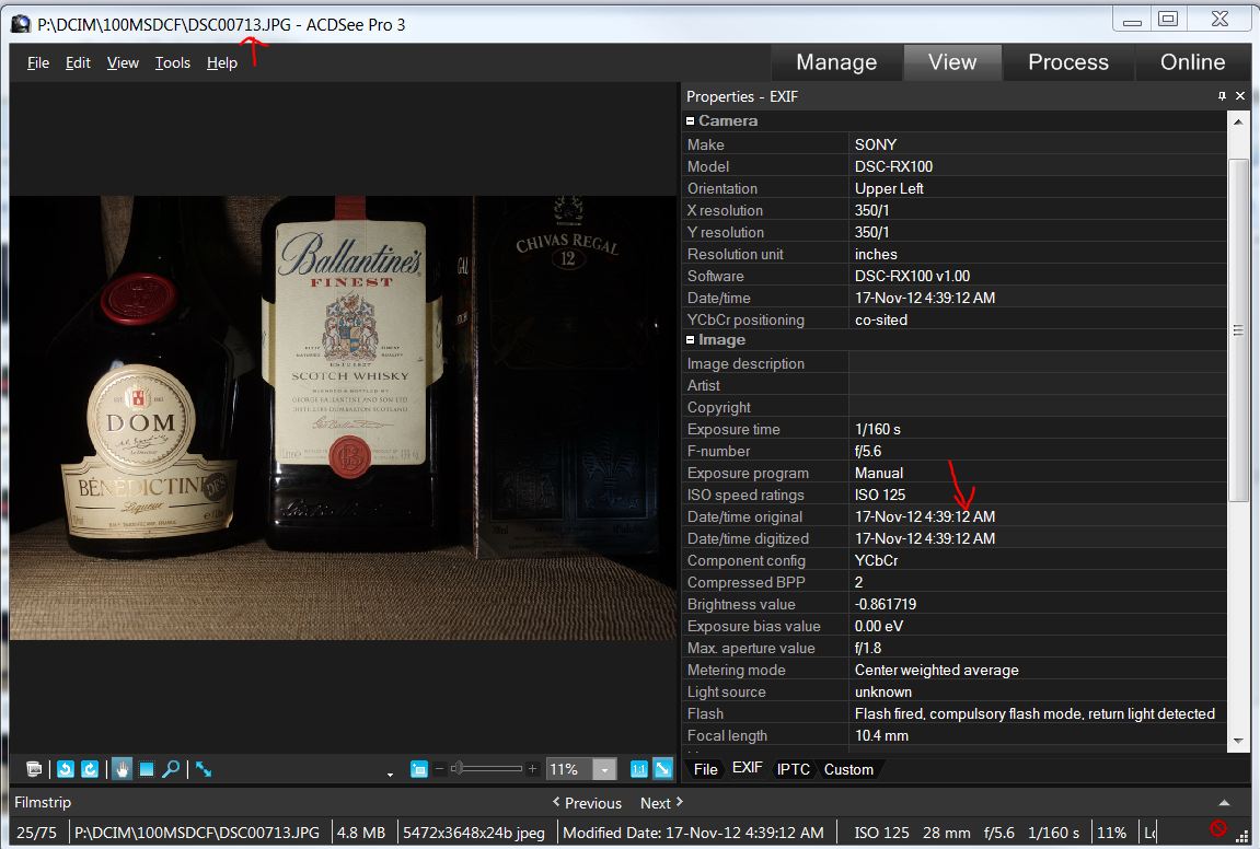

    A favor for you Oskar, I took the trouble to test specifically for you.
    Parameter :
    Camera in MANUAL MODE, 1/160sec, F5.6.
    Focus mode made manual for faster allowed shots for this test.
    Object/target is static
    Inon Z240 in sTTL mode. If I go FULL POWER on Z240, I will go blind !!! doing this test. Anyway I am testing RX100 and not the strobe. Battery is fresh in Inon.
    Possible delay/cycle RX100 could give to user for flash operation :
    AA. Preview setting, how many seconds ?
    BB. Focus mode
    CC. Battery not fully charged
    DD. Setting of RX100 flash. I set to FILL flash
    121, you have the RX100, its odd that you believe what people say in SB without testing it ?? Just fire the camera with flash and that's it, without or without external strobe it makes no difference since RX100 strobe is what we want to test.
    If a user has a crappy external strobe and get delay, too bad.
    Come on, I am not an UW photographer but I use my logic a lot.
    How can a master strobe called RX100, which can not communicate with external strobe ( slave ) and can only fire thru fibre optic as a command to trigger a slave/external strobe, get delayed by an external strobe ? The only way the delay occurred is because user/tester did not see flash fired from the small FO window of the housing and only looking at external strobe behavior and assumed RX100 did not fire. So when a faster recycling external/slave strobe being used and user/tester felt that the delay is reduced, it is then assumed the problem lies with the master strobe aka RX100. Hello ??? Fiber optic triggering is a one way command to external strobe, there is no handshake, no verification whatsoever an external strobe could instruct back to master strobe to alter the behavior or performance of the master strobe.
    Video : To see the real live test. 48 seconds. Only 48 MB. My boss would want me to prove it , if he is the one asking the strobe re-cycle question ha ha ha.
    https://rapidshare.c...n Z240 test.mp4
    Photos of photo files, for those with slow band-with for video download.
    The average is approx 1.548 seconds per cycle. 48 seconds divided by 31 cycles. 31 is used and not 32 because the count down starts with 1st firing recharge cycle which is not part of the total 48 seconds test duration.
    If under 2 seconds is slow for a baby sized camera, I probably am more UW photo dummy than I thought. I thought 2-3 seconds recycle is decent for baby sized camera with no capability to reduce flash power like Oly EM-5.
    Enjoy...............
