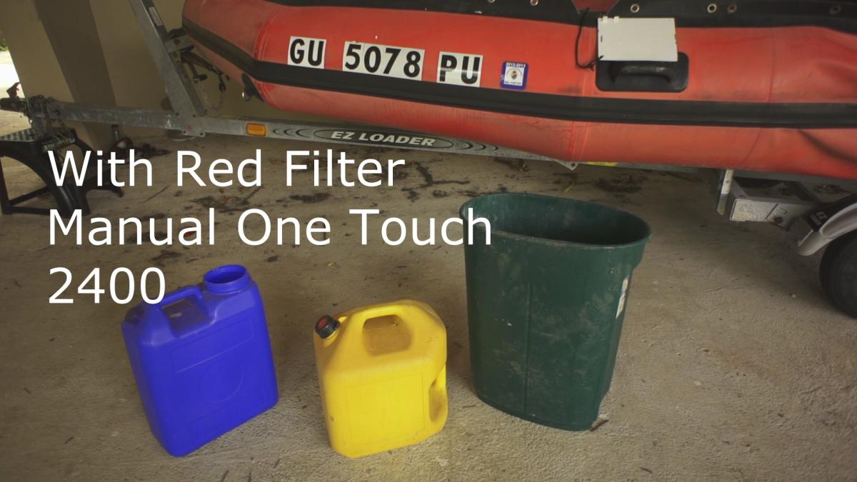

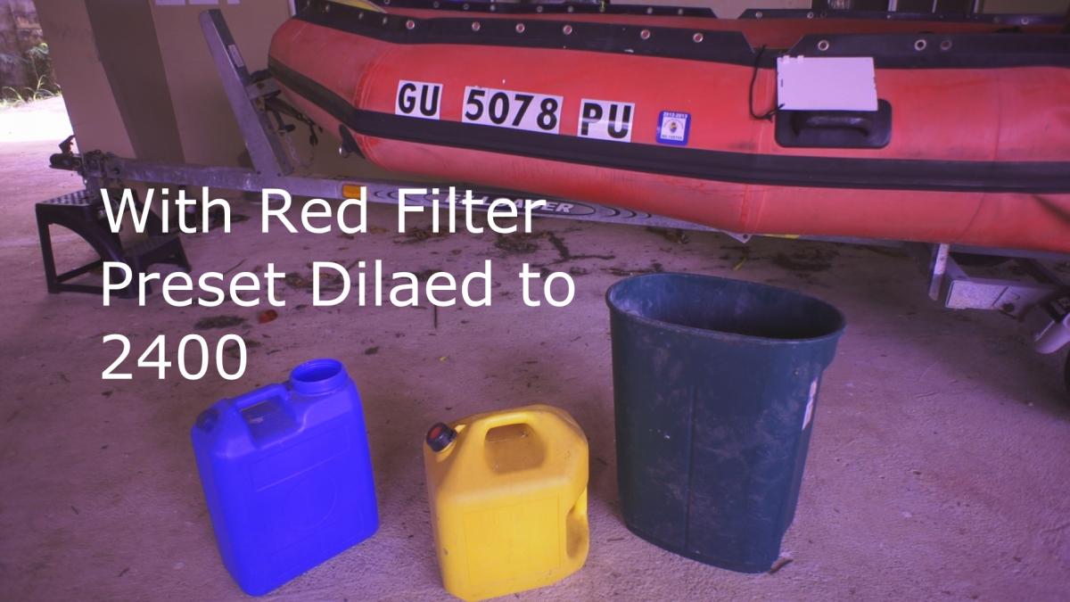

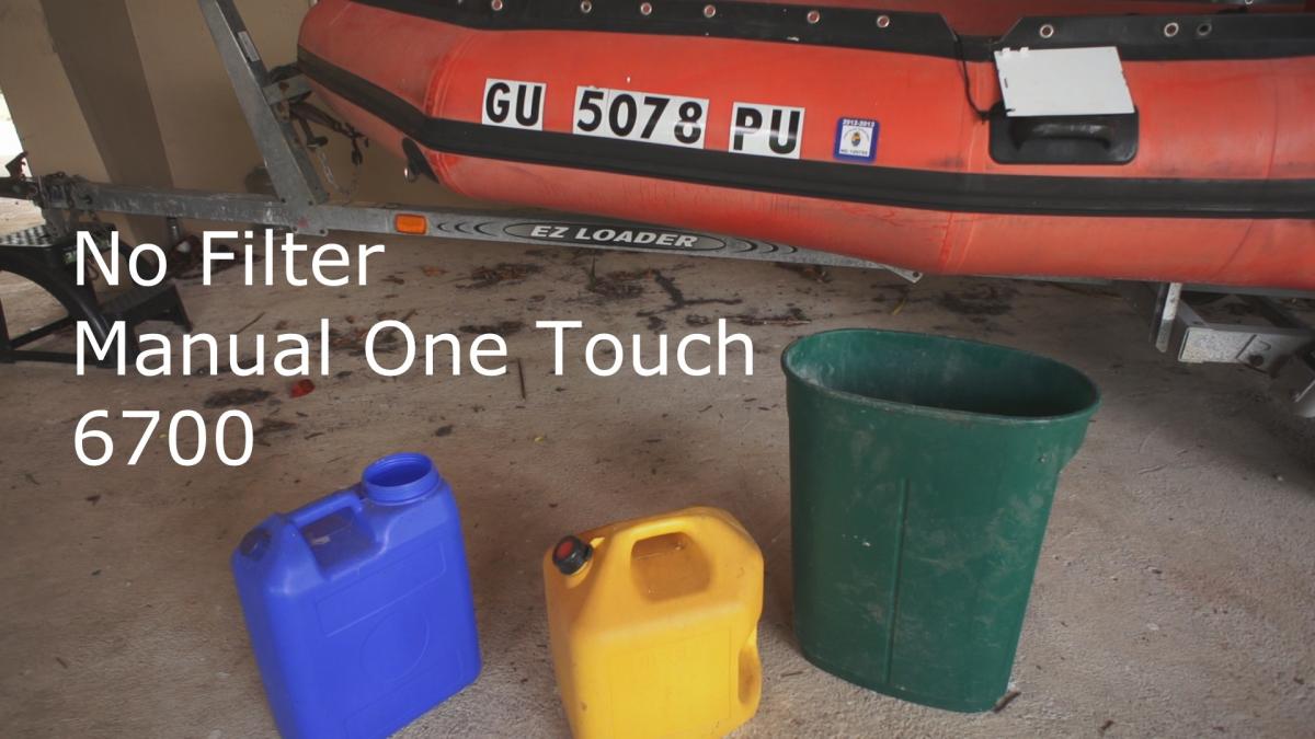

  16. Sorry I can't answer your question thani, I can only add more questions to the mix for now. Your observations reminded me of something that I discovered while setting up my camera on land the other day. I always run through the functions of the housing at the home just to make sure everything is working correctly. While doing that (with my red filter on), I noticed a big difference in the look between the manual white balance and the preset white balance with the same color temp dialed in. I just recreated those results in my car port using a white slate and some colored bins, with and without the red filter. I'll attach some screen captures of results below now.
    As you'll notice, the two white balance methods produced what look to be identical results without the filter on the lens, but radically different results with the filter on. So the camera is clearly doing something differently with the manual one touch method, where it can manage to compensate for the extreme color change caused by the filter. With the preset, the camera does NOT do the same thing, and isn't able to compensate for the filter. I imagine it's the same at the surface (or shallow water), and then at depth. With a manual white balance it can compensate for the color change caused by the water, but it does not compensate the same when the temperature is preset. That explains why I am able to get good results by manually white balancing in shallow water, but like I mentioned, the manual white balance just won't work at depth, so preset is the only choice I have.
    So the question seems to be, what is the camera doing differently between the two methods, and is there a way to get it to do the right thing at depth?
