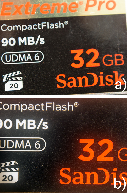

    I just did a quick test with the 12-50mm and my Subsee and found I got LESS macro magnification with the lens's macro mode i.e. 43mm (example a, below) then I did without access to the macro mode, but with the lens zoomed to 50mm and my Subsee in front (example b, below).
    Both photos taken at minimum focus. Not this is a larger CF card (see the D800 lag thread!) and not a SD card. BTW the Subsee shot was 3.2 seconds handheld!
    Guy raises two good points against using a Subsee or similar.
    First that it might degrade image quality. Certainly cheap dioptres do so noticeably, but the Subsee is very good optically and I don't see this as an issue here. Many, many underwater photographers use and love their Subsees (or similar) and everyone is impressed by the image quality. But choosing a good brand is important and I have tried plenty I wouldn't want anywhere near my camera!
    Second that screwing them on and off is a pain. One of the things I have praised Nauticam for is the fact that they have screw threads as standard on their ports, and they wouldn't do this if people didn't use them And second, as i just said, many underwater photographers use external dioptres very happily on everything from compacts to SLRs, often carrying several strengths on caddies on their strobe arms.
