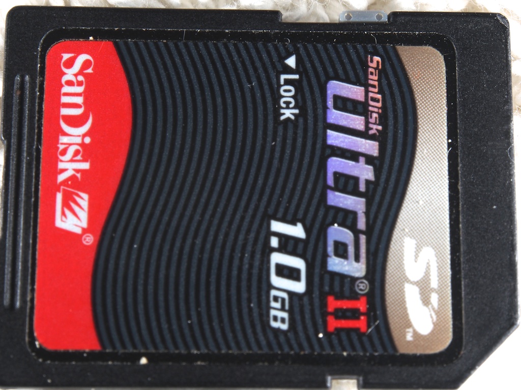

  1. Here is the proof: 24x35 reproduction. Full-on 1:1 in 35mmm format. Just AMAZING.
    Hey Ryan, your crew at REEF is the best! I could not be happier with the system and the time they took (hours) to put it all together for me in the store.
