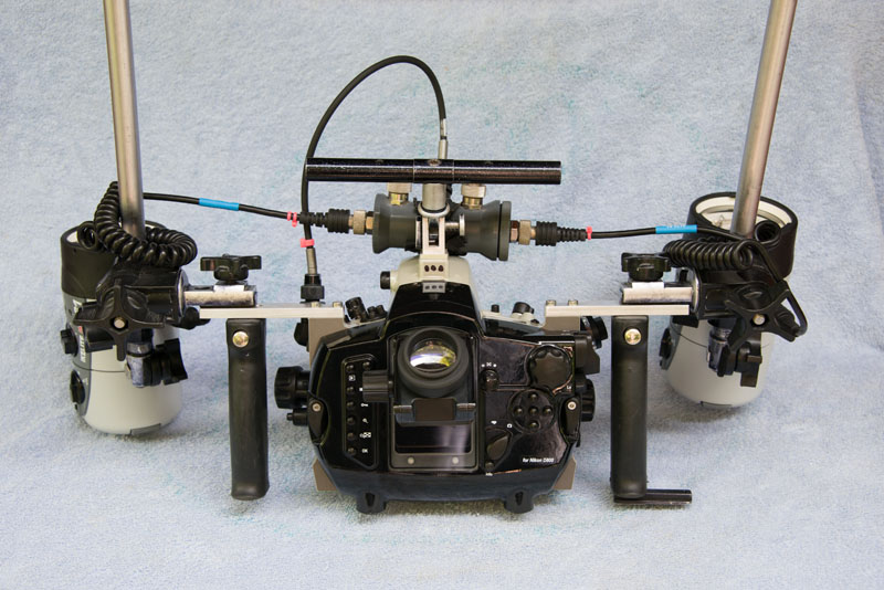

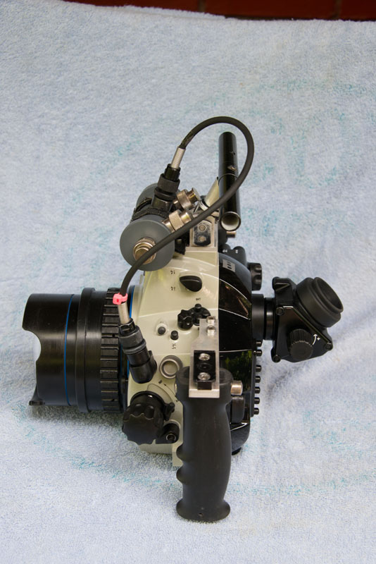

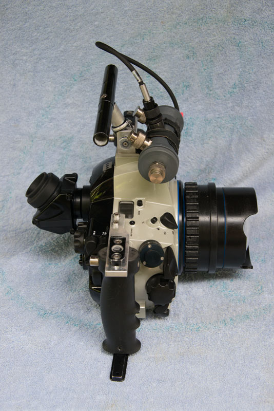

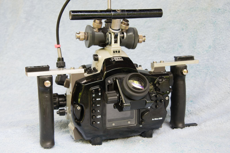

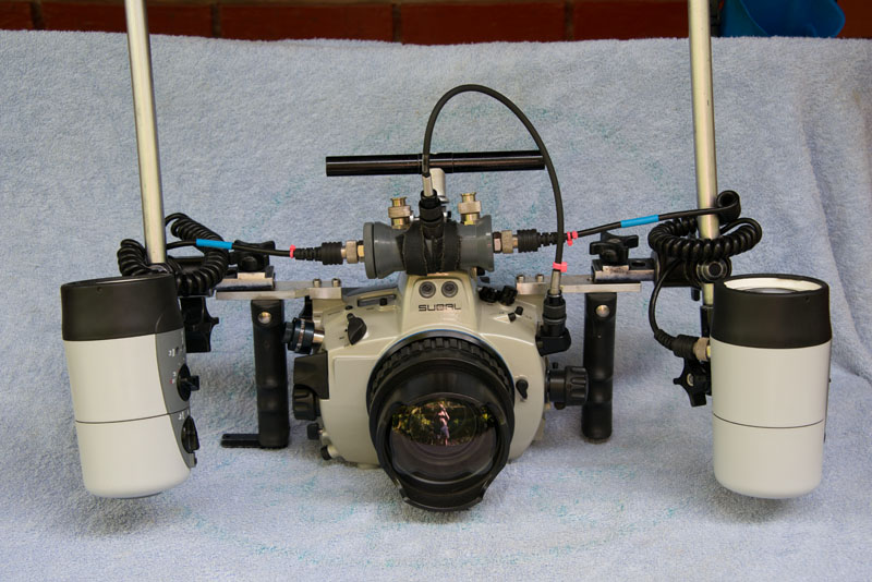

    I've washed up on Australian shores and am now settled into an operational base in Adelaide from which, when the weather permits, I'll go diving. I also have more regular connections to the internet and WetPixel.
    Addressing your questions about my strobes. I use two very different kinds of strobes. Hartenberger 250's and Ikelite 161's. I use both on iTTL with Nikon cameras. I shoot virtually everything on TTL from fisheye to super-macro because once you know TTL it greatly increases your chance of getting a well exposed picture on the first try. The Hartenberger strobes are considerably larger and heavier that the Ikelite 161's but have the advantage of a full-power recycle in under a second, maybe about half a second. So I use those mostly as "special purpose" tools when I expect to be shooting larger or faster moving animals. For my day-to-day shooting I now use the Ikelite 161's.
    Recently I upgraded to Ikelite's new Lithium Ion power packs which are excellent - lighter, more flashes per charge and faster recycle times (Ikelite says under two seconds for a full-power recycle). I just finished a Komodo cruise. On the cruise I had two housings - one set up for macro with the 70-180 and the other with a wider lens and dome port - either 24-85, or 17-35, or 16-35, and appropriate dome. I used that set-up for schools of fish and reef scenes. Attached to each housing were two Ikelite 161's. Over the nine days we actually dived, I did 26 dives, 19 of them with the wide-angle lens housing. Dives averaged about an hour and over the 19 wide-angle dives I shot 623 frames. I never had to recharge either set of battery packs the whole cruise. The battery capacity check on the strobes after the last dive indicated that I still had enough power for additional dives and shooting. The wide-angle camera's strobes had been turned on for at least eighteen hours, had provided 623 TTL flashes and still had more capacity. What more can you ask for?
    I use my strobes with traditional wire sync cables, because I already have those and because I feel there are several problems with optically synced strobes that I'd prefer to avoid. I believe that Ikelite's TTL system (iTTL for Nikon and eTTL for Canon) is the simplest to use because the TTL converter is powered by the strobe and doesn't require a separate battery like many other TTL systems. As long as there is enough power to recycle the strobe, the converter has the power it needs.
    I'll attach a few photos of one of my new "mongrel" D800 housings. Part Subal (housing body), part Seascam (ports & extension rings), part Nauticam (viewfinder), and part Ikelite (strobes, TTL converter and handgrips). A housing modified to suit its new tenant. Me. What I also have on my housings is a very nice carrying handle that makes carrying the housing much easier, especially for shore entry diving. It is also good when you need to hand the housing up to someone in a boat while you're in the water. Subal sold me a custom paint job with the tan front and a black back. I'll further camou the front which should make it minimally intrusive to sensitive critters. The black back allows me to see the camera's LCD better in high ambient light situations. Far better than the bright silver of my previous Seascam D700 & F5 housings. The housing as it is shown is set up for use with Nikon's 24-85mm lens.
    Each of my housings also has one of Miso's Leak Sentinel alarms installed. They worked perfectly on the Komodo trip.
    Fred
