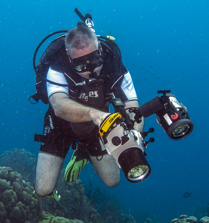

  11. The fish portraits are made with a single strobe pointing forward (see attached photo for strobe position). Topside macro photo's with ambient light only (dragonflies backlit by early morning light).
    --Rob
  12. I will spend at leats a couple of days diving with the 150mm in Wakatobi. I will post subsea shots when I return. Thanks for the strobe placement shot. Generally I use dual side view (z240) at the same level as the lens.
