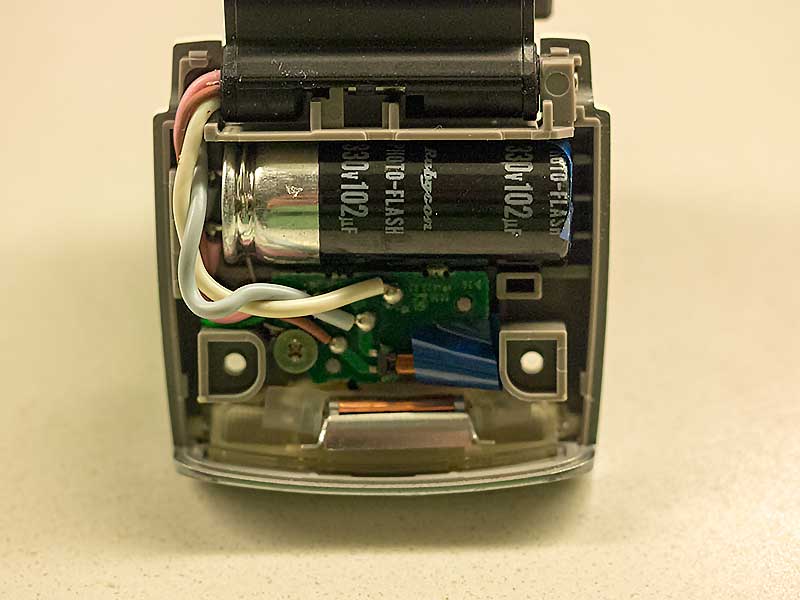

    our flash is FL-LM1 or the FL-LM2. if you disconnect it from the camera, you will see there are two small bolts, when you open them up, you can see the whole flash system, there are two capacitors, one is the triggering (small one, can get to 4000v) and the second one, the one that we are interested in is the big one, 330v 102uf.
    THE FLASH:
    BEFORE YOU TOUCH IT! the capacitor is charged! that means it has 330v in it, be careful, you should discharge it first (how? if you don't know better not to do it :)).

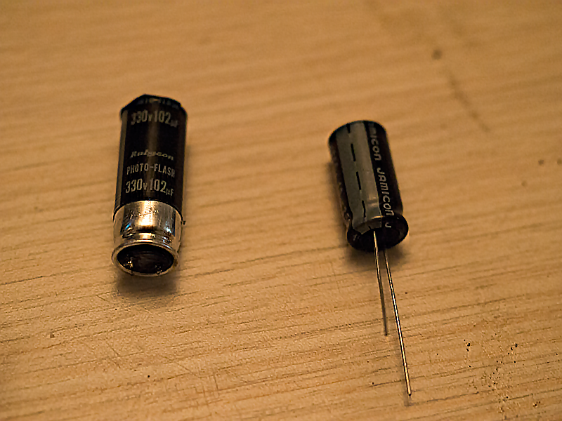

    so you can see all you need to do is take a new capacitor, solder it to the same wires with the same connectivity, and you are done, I've checked few capacitors before I ended up with this one - 350V 10uF, (No need to go higher - 10uF works 100% I get green light on my strobes every shot) I've tried also 1uF, it was too weak, you could see the flash firing, but couldn't get TTL to work 100%, so I guess you can find a better value between 10-1 but I'm happy with the 10uF.
    Old capacitor Vs New capacitor (smaller one is the new one)

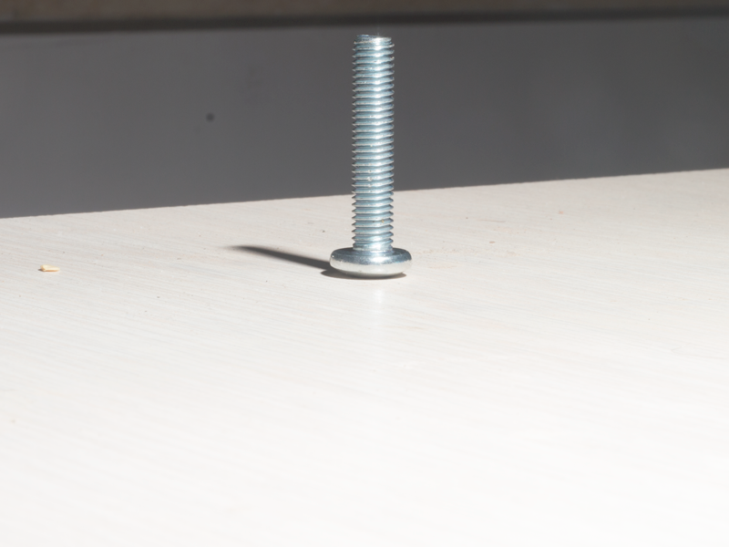

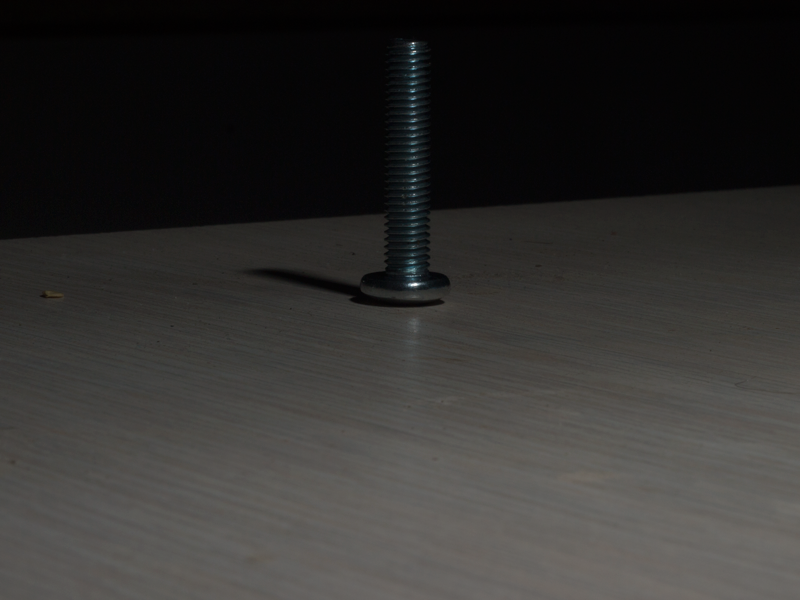

  10. OK, so I was very curious about the solution... so I made some time to test it, this is not 100% test yet, but here are some of the results:
    I did not image editing other than re-sizing
    1/160 f22 NO EXTERNAL FLASH:
    Set the camera on 1/160, but camera limitation changed it to 1/100 f22 EXTERNAL STROBE ON MAXIMUM POWER (SLAVE):
    1/160 f22 EXTERNAL STROBE ON TTL:
    VIDEO OF THE FLASH SHOWING TTL SIGNAL (Green light is TTL was ok).
    I still didn't check to see if I can get the FULL POWER of the strobe but I wiil :).

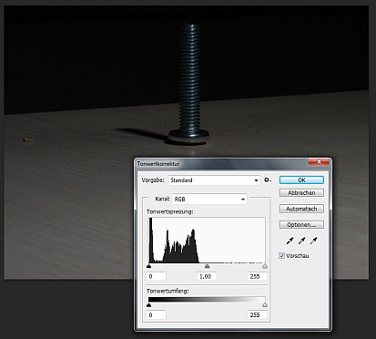

  11. Hi, thanks for your tests.
    Whatever the green TTL Signal may say - IMHO the photo is underexposed. See also snapshot with histogram.
    Did you use spot metering? Matrix? ESP? Maybe a larger, non-reflective object and spot-metering will give more significant results?

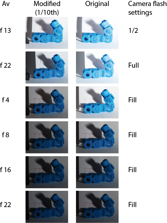

  14. As an E-PL3 owner, I thought I will give it a try. I modified one of my two strobes, and indeed got a much weaker light. To test the effects on TTL, I did a semi controlled test (see attached pictures). My conclusion is that there is little difference between the two strobes when using an external strobe in TLL mode. The differences are mainly at the extereme ranges of apartures.
    Setup:
    E-PL3, Olympus 60mm lens, T 1/160 throughout.
    External strobe YS-D1, set on TTL with the TTL dial on 0. The strobe was on the right of the camera facing so that the edge of the beam was on the object. The strobe was connected with fiber optic cable. I was holding the other end of the cable about 2cm in front of the camera strobe. I checked that the hand blocked any light from that strobe (you can also see that from the shades in the images).
    I varied the strobe setting of the camera and aperture, as noted in the attached picture. I converted the images from raw to jpeg without any adjustments.
    My conclusion is that the camera changes output by modifying duration of the flash. The modified strobe had slightly lower exposures throughout the test.
    Edited by ProfF
  15. Hi ProfF,
    is there something wrong in your settings? With camera flash set to "Fill" and the YS-D1 to "TTL" there should not be such a big difference between f/4 and f/22, exposure should be almost the same - that's why you use TTL!
    F/4 looks good, the other ones to me seem underexposed.
    Jock
  16. Jock,
    I am not sure. Actually, I was surprised to see this. I just revisited the YS-D1 manual (I usually don't shot TTL, so never checked this option), and it seems that maybe I should have used the Slave-TTL rather than the normal TTL mode (which assumes preflash). I don't think the E-PL3 pre-flashes.
    Nir

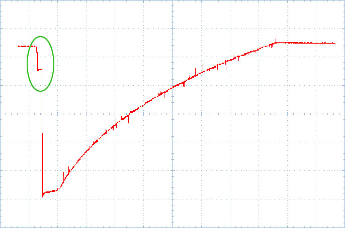

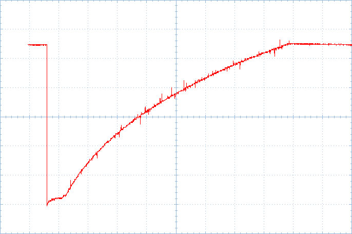

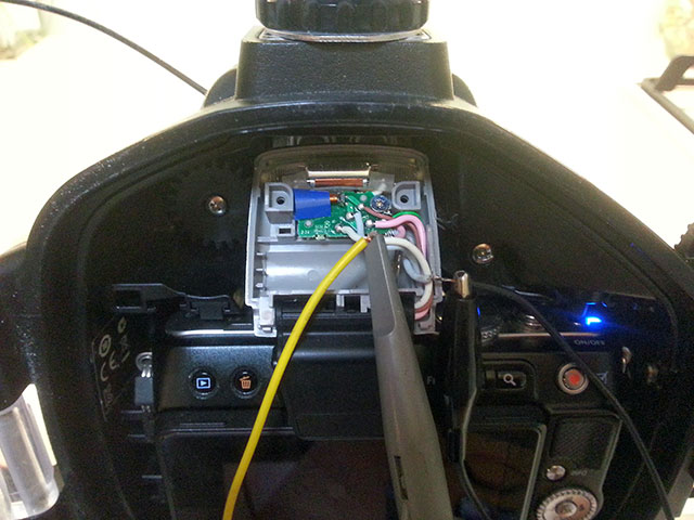

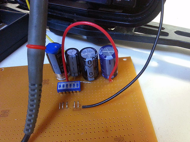

  18. OK, so I finally had sometime to check what is going on with the TTL.
    I thought that the problem was that the capacitor is not big enough to supply the "full" duration of the pulse needed, so I setup a small test to verify it.
    I will not upload all the info & data, since I don't think it will interest anyone, I'll cut to the results (if anyone want the full report, contact me).

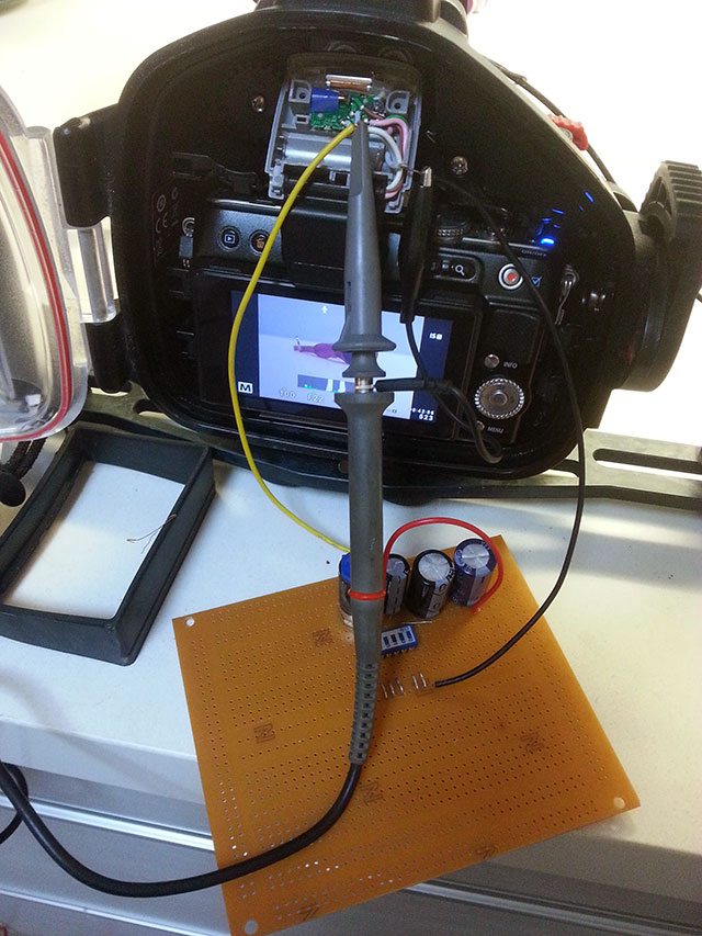

    This is the setup:
    A small circuit board with 4 capacitors on it, Original 102uf, 10uf, 22uf, 33uf, A small dip switch to select the current capacitor.
    And a OSC connected to see the signals.

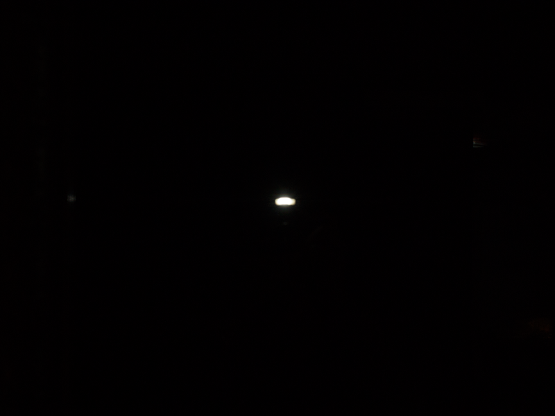

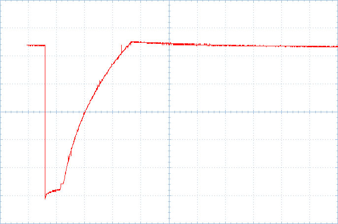

    Also about the preflash that we've talked about:
    NO TTL, full flash:
    TTL ON:
    You can see the small pulse before the flash, this is the preflash.
    33uf NO TTL, full flash:
    you can see the fast charge time.
    OK, so if I cut to the chase, I've tried all the capacitors with different settings on the camera, the 10uf was always underexposed.
    the 22uf worked well until the f18, this was the maximum that I was able to achieve with the correct exposure.
    and the 33uf gave exactly the same results as the 102uf.
    if we compare timing (charge to full):
    10uf: 350ms
    22uf: 1662ms (or 1.6 sec)
    33uf: 1277ms (or 1.2 sec) (I think the difference here is due to different manufacturers, you would expect this to be longer than the 22uf).
    102uf: 3796ms (or 3.8 sec)
    I can upload the images of the test if anyone wants.
    Conclusions:
    I think that if you wish to use TTL than cutting down from 3.8 to 1.2 is good enough preserving the TTL signal, I'm sticking with the mod for now :).
    If you don't use TTL (god know why) than you can go even lower than 10uf, I think even 1uf, this will give you very good results: super fast & low battery usage. (on second thought you can use 1/64 flash, so maybe 10uf is enough).
    I'll soon be testing it on RX100 ii that my friend is asking me to MOD to allow faster shooting, I'll update you all.
    Have fun!
  19. I am not sure if I understand the graph, but I assume the y-axis is capacity and the x-axis is time (it would help to have a scale :-)
