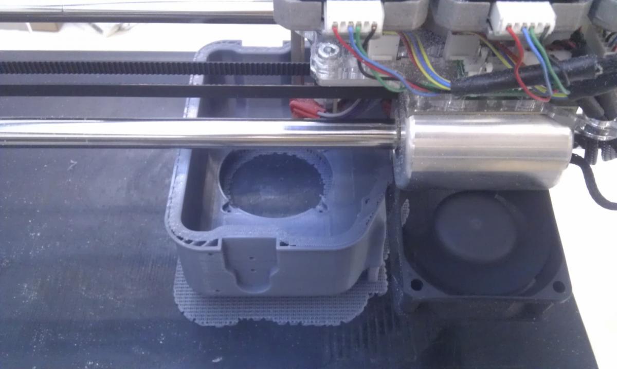

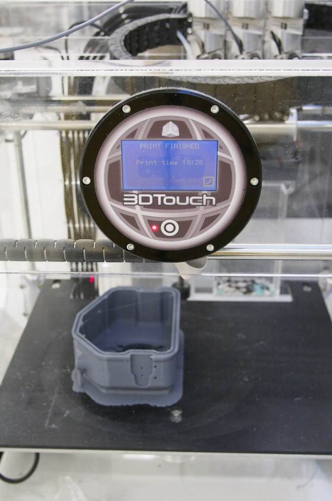

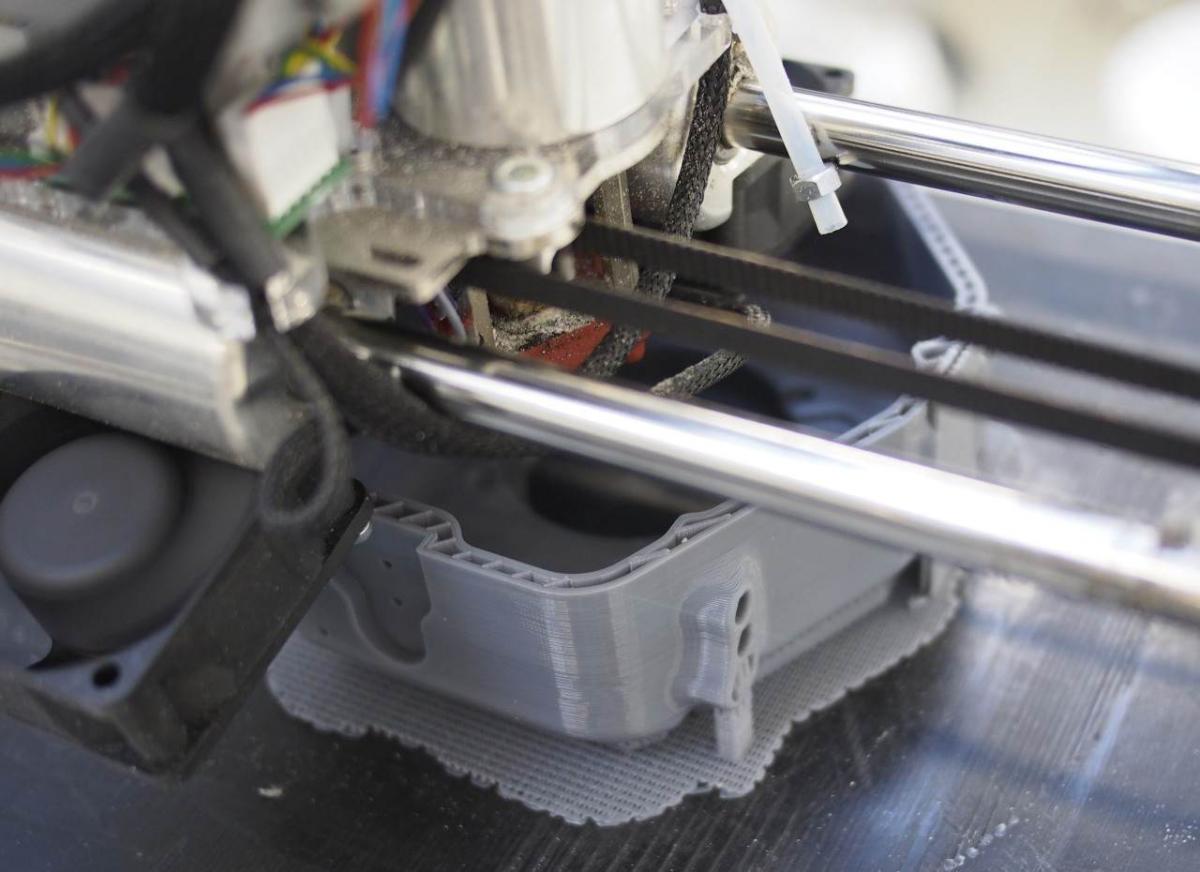

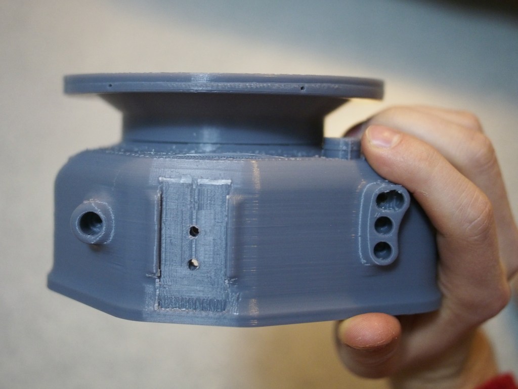

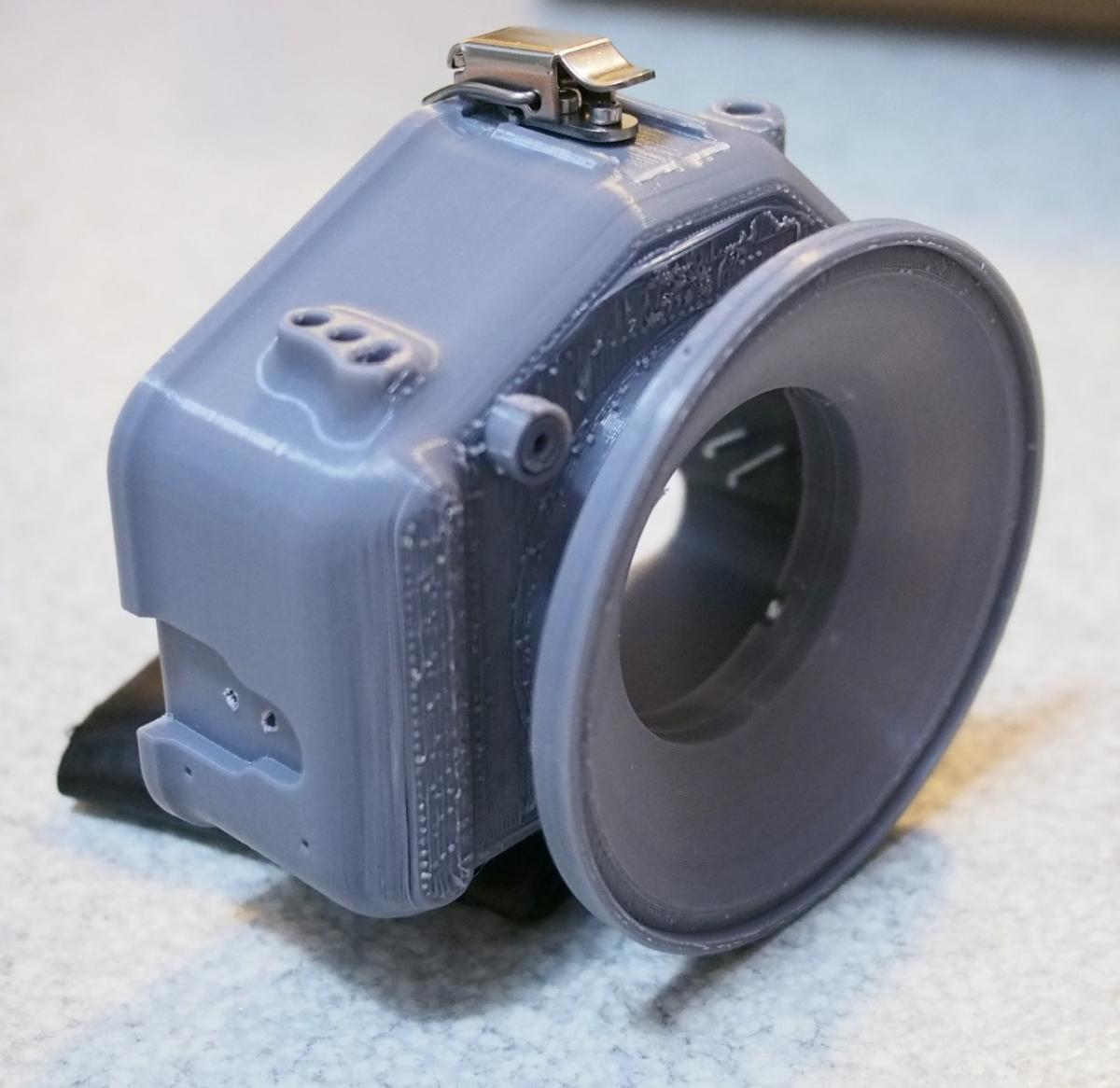

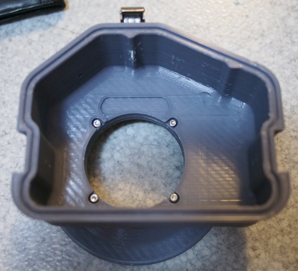

  11. Here come the pics of the 3D printing process.
    Even though the walls are only 4 mm thick, the printer (or the software controlling it) makes them hollow to save material and speed up the printing process.
    After 19 hours and 28 minutes, the printing is done.
    And this is how the body and the port look like when the port is attached. The port/dome looks huge compared to the body but that is just how it is. If the body works properly, I may later make a smaller dome port. The front surface of the the body is very rough because that is where the supports were printed during the printing process. The rest of the body is printed on top of the supports because the machine can't print on air, there has to be something on which the plastic is extruded. Anyway in this case the surface finish is of no concern. The inside of the body is more important
    And here is the inside. The port is mounted on the body with four screws. The screws are inside the port O-ring so they do not have to be sealed in any way. In the final part the holes for the latches do not penetrate through the walls like in the printed part so they do not have to be sealed either.

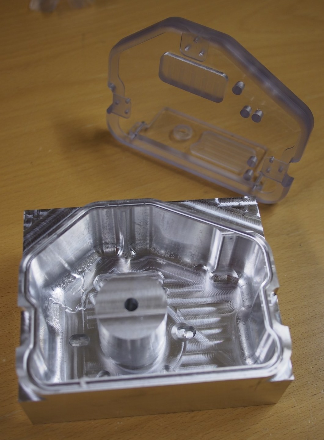

    The main reason for printing the prototype was that I could test how it fits my hand. As you can see I can fit my fingers between the body and the port which is of course important. Here the problem with the trigger button is visible. Even though the button on the housing is already moved a lot to the left compared to where the button is on the camera, the natural position for the index finger is even more to the left and forward. I will move the trigger button still a little forward and left in the final design.

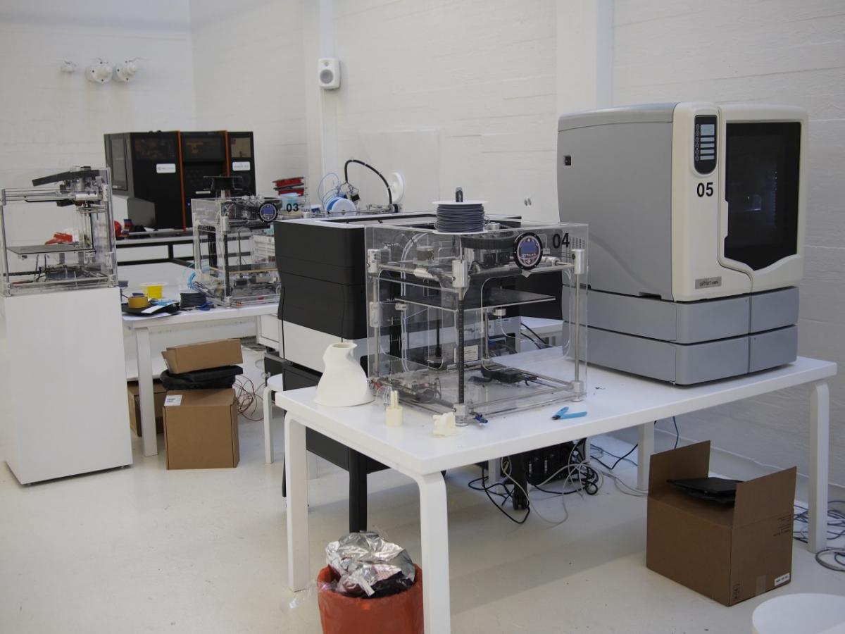

    And this is the environment where I was printing. It is next door to the laboratory where I work and now I can basically use it whenever I want for free. Nice.

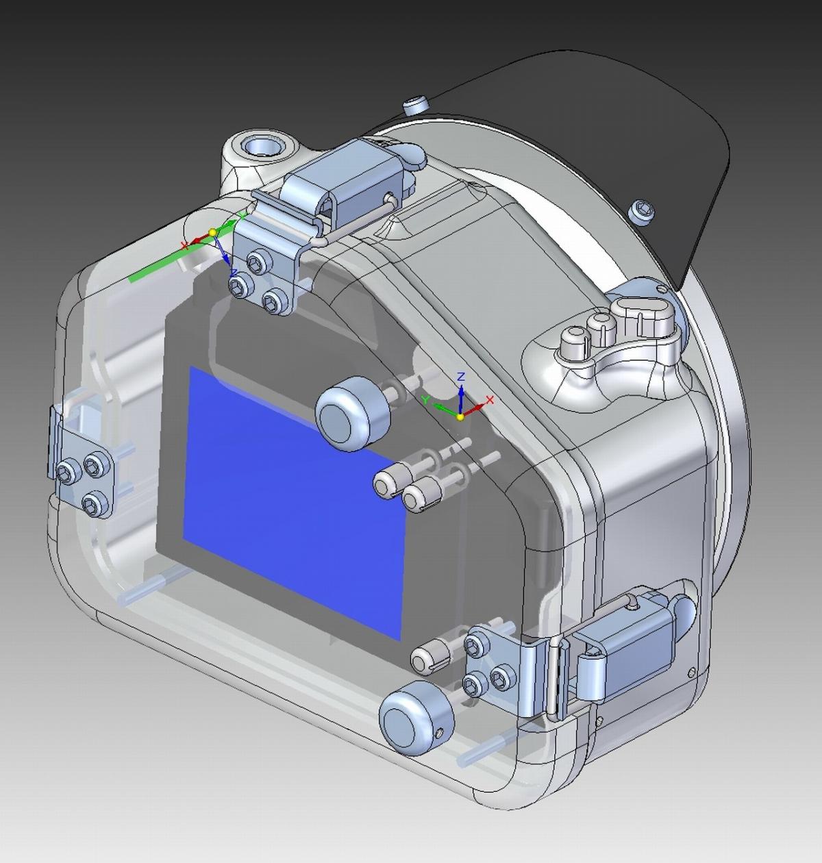

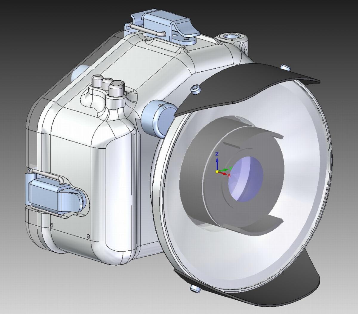

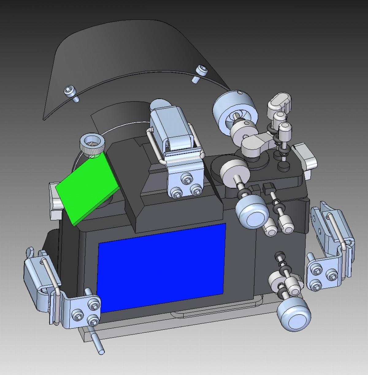

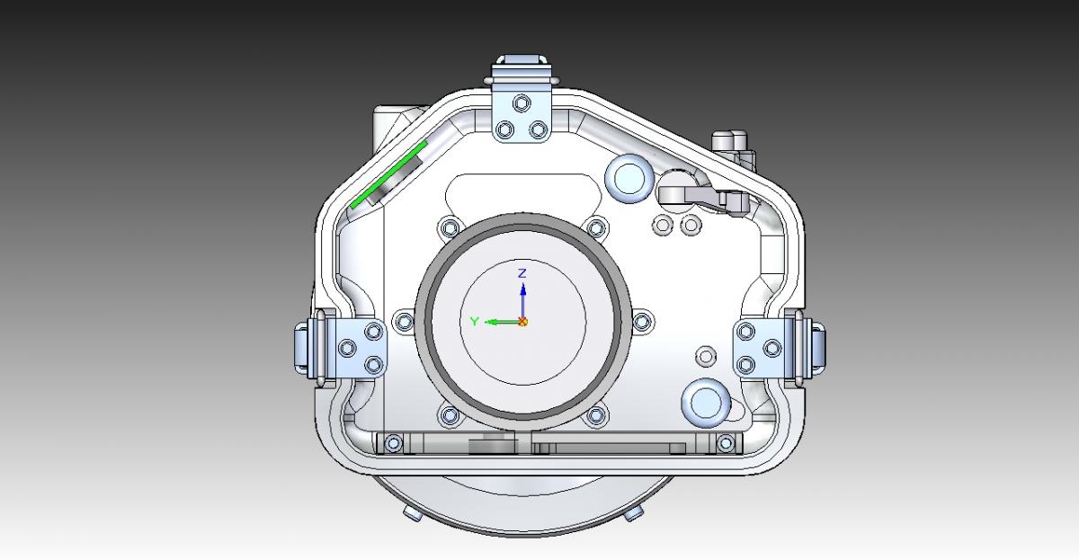

  12. And a couple of more images of the more or less finished CAD model.
    Front side.
    Back side. I'm pretty sure I will manage without the arrow buttons when I have the dials. It'll save me some work.
    Here is the CAD model without the body, port and back cover so that all the small parts are visible. The green part is a mockup of a PCB where I will maybe later make a DIY trigger flash. The only parts I have bought are the latches and the stainless screws, all the other stuff I will have to manufacture. I will soon start to panic, since in two weeks we will already be in Hong Kong. So tomorrow and Sunday will be spent machining and I hope that I will get a lot done. Sadly, it always seems to take more time to machine something than what you initially thought...
  13. Looking good! I must need a new project of my own because I'm really enjoying your progress reports. Thanks a lot for posting.
    By the way, are you sure about using only 4 screws to attach the port? It looks like it leaves a lot of unsupported circumference to possibly flex. Since the screws are inside the o-ring (great idea) why not add a few more?
  14. By the way, are you sure about using only 4 screws to attach the port? It looks like it leaves a lot of unsupported circumference to possibly flex. Since the screws are inside the o-ring (great idea) why not add a few more?
    You just might be right. My previous housing had 5,5 mm thick walls and I always thought that the body could withstand anything. This one has 4 mm walls and it might be possible that it could bend a little under pressure. I don't think that it will be a problem, but the pressure force 30 m deep is pretty large, it equals about 300 kg of mass on a 10 cm by 10 cm surface.
    I added two more screws for the port. There is no space for screws on top and bottom, but I moved the screws in the "corners" a little closer to each others and added screws to the sides. Although I guess the commercial housings do not have anywhere this rigid mountings for the ports. Actually, I don't know about that since I have never held one in my hands :lol:.

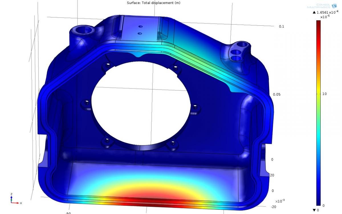

  15. Fascinating project. I hope all goes well. You discuss the pressure capability and possible deflection. What looks right often is right, but there is a free Finite element analysis program Z88 Aurora which will give you the answer in seconds. If you have produced the model for the 3D printer I think you could feed it straight in and check the stresses and deflections. Not at all difficult.
    One question, you do not show any springs on the buttons, does the camera alone release the button or have you just not shown them?
    Rod
  16. Fascinating project. I hope all goes well. You discuss the pressure capability and possible deflection. What looks right often is right, but there is a free Finite element analysis program Z88 Aurora which will give you the answer in seconds. If you have produced the model for the 3D printer I think you could feed it straight in and check the stresses and deflections. Not at all difficult.
    Rod
    Actually even the CAD program I have been using, Solid Edge ST3, does FEM analysis. I had just totally forgotten about it. I tried to make a quick analysis with it but did not get a sensible results so I imported the model to Comsol Multiphysics. I did an analysis with only the body of the housing and a 300 kPa (30 m depth) load on the outer surfaces. The inner surface of the port was selected as the fixed part of the body. The resulting displacement is shown below. The maximum displacement is about 0.2 mm in the edge behind the buttons. On the other hand, this part of the housing is partly supported by the pressure force on the back cover, which is now not simulated. The displacement on the bottom of the housing is probably real and there is not much I can do for it besides increasing the thickness of the walls. I think a 0.15 mm displacement there is just fine.
    The CAD model does not show springs since I have not had time to model them. There are springs under each button and there are stainless steel washers between the springs and the o-rings. In addition to those, there will be pieces of plastic at the ends of each shaft of a button so they do not scratch the camera buttons. Otherwise, the CAD model should be complete.

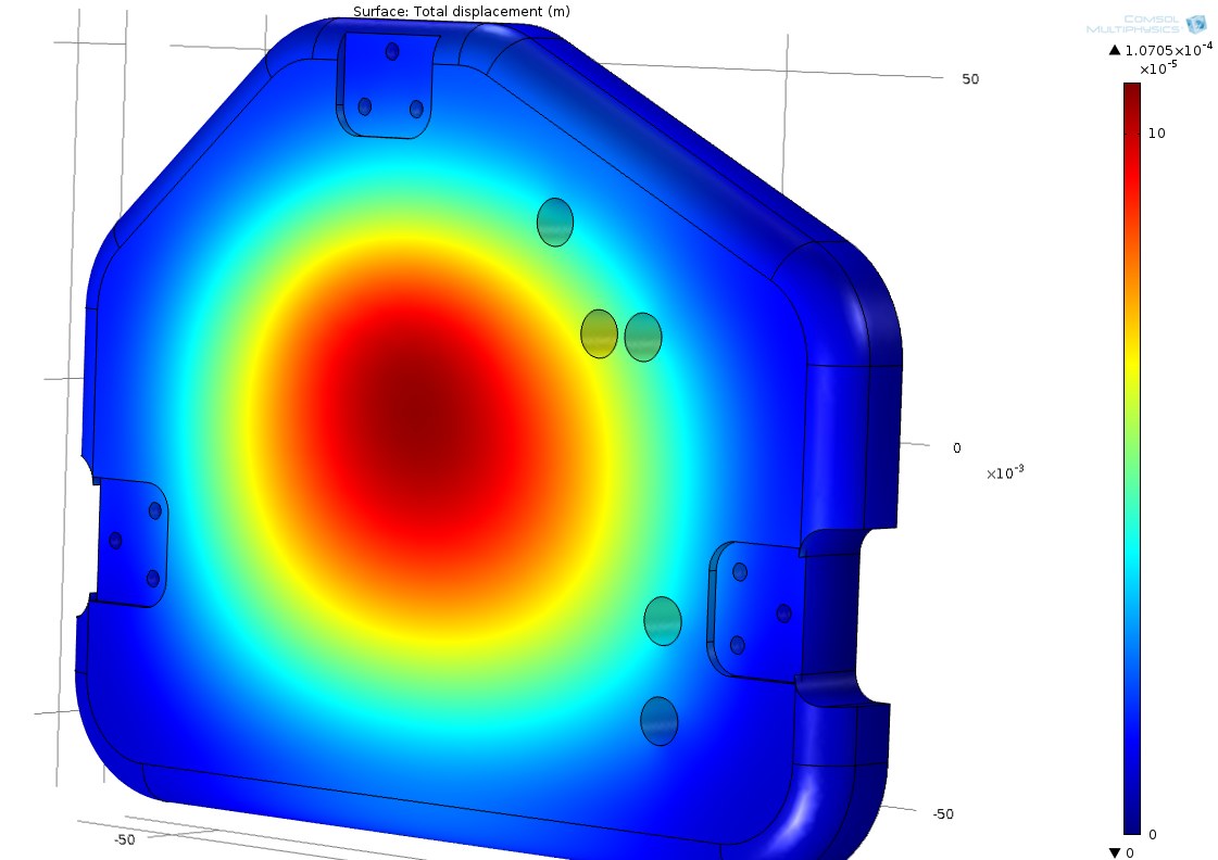

  17. Well, I modeled the back cover also. 15 mm polycarbonate is thick enough (surprise...). Maximum deflection 0.1 mm which has little significance.
    I also added a 3600 N load on the contact surface of the body and the back cover to simulate the pressure on the back cover. It removes most of the deflection in the upper part of the body. The bottom deflection (max. 0.16 mm) remains.

    P.S. Are You sure that at 30m there is 300kPa??
    Yes I have also been wondering why am I even doing this, especially now that my schedule is tight and I know there will be long days, evenings and probably nights of machining ahead. Probably it is a symptom of some mental disease. I think I also just want to prove to myself that I am able to do this.
    The pressure in 30 meter depth is about 400 kPa and inside the housing the pressure is 100 kPa so 300 kPa pressure difference.

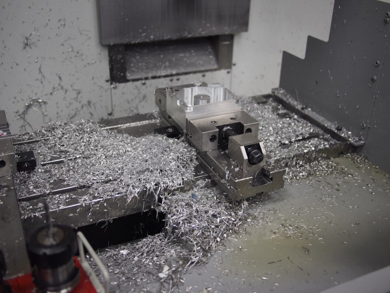

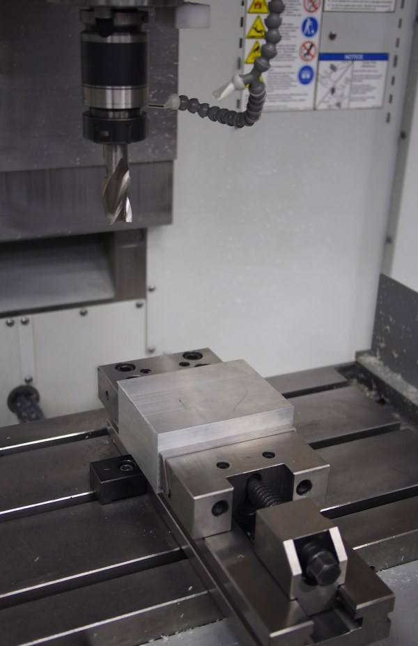

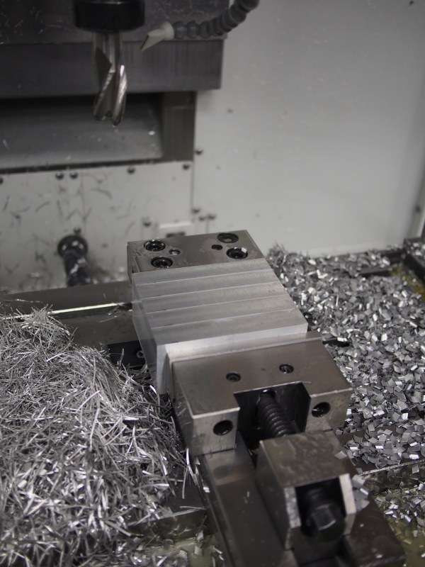

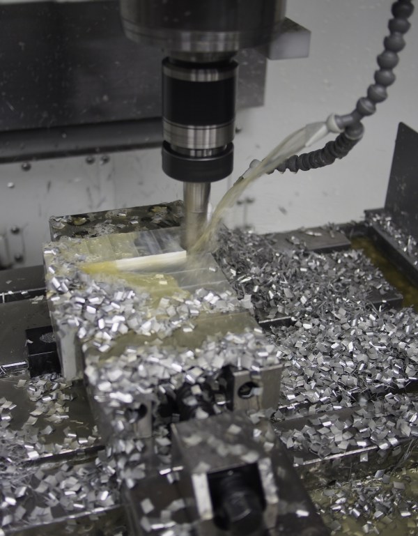

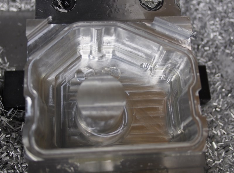

  20. Here's a step by step story of machining the inside of the body. I always enjoy machining pics, I guess there must also be others with this kind on personality disorder.
    Here is where the machining starts; a rough 3½ kg billet of aluminum. Of course before starting, the milling paths have to be made (took me like 5 hours for this part) and the tools have to be set up. The milling process itself takes less than an hour.
    First, the billet is machined to as precise as possible a rectangle with the desired dimensions. Now when the orientation of this rectangle is changed and it is clamped, it will always be accurately in the desired orientation (as opposed to the initially not-so-rectanglish billet).
    Then, the back cover o-ring groove is machined with a 2.5 mm end mill.

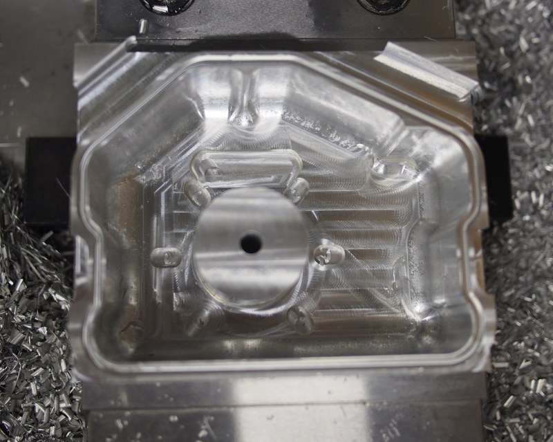

    Next the main job i.e. digging the hole for the camera with a 12 mm flat end mill. The middle part is for mounting the part during future machining steps. This was as pretty messy part of machining since the pit was full of cutting fluid and I had to empty the chips from there with pressurised air. There were chips and fluid everywhere within 3 m radius of the machine.
    Then finishing the sides and chamfers with a 14 mm ball end mill and some pockets to the bottom with 8 mm flat end. The tools had to be long so they vibrated a little. Therefore, I did not get exactly the surface finish I wanted. I guess I will sand also the inside of the housing if I have time. That was pretty much it for now.
    The worst part is always the cleaning. This time it took about an hour. It seems that half a liter of solid aluminum turns to quite a large volume of chips. At times like these I really love our industrial vacuum cleaner which can handle the chips and the cutting fluid.
