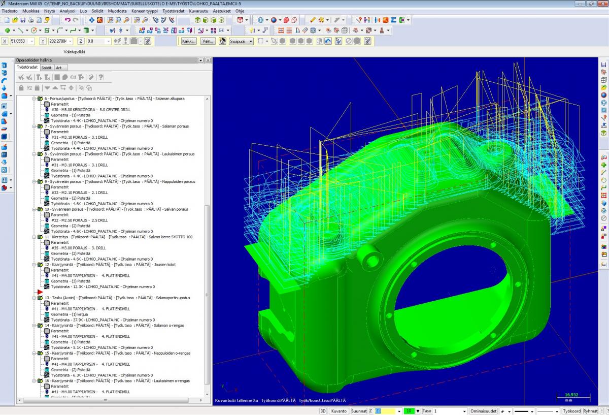

  2. Damn it takes a lot of time to make these toolpaths. I spent again several hours in making the toolpaths for machining just one side of the body. Its partly because I do not have much experience in making double curved toolpaths so I don't know all the tricks and I don't find Mastercam particularly easy to learn. But there are also a lot of variables to consider when making more complex toolpaths. Below is an image of the Mastercam program with the almost ready toolpaths in blue.
    It doesn't help making the toolpaths that everything has to be perfect. If I ruin this part, it will cost me 40 euros in material, and a day in time, which I really wouldn't like to loose. Also, the carbide cutting tools are not exactly cheap and they can break if you run them too deep or too fast or into the table.
    Tomorrow is going to be a full machining day again. I hope to get the body ready but I seriously doubt that. I will also need to start machining the port tomorrow or at the latest on Wednesday so I can get both parts to anodization on Thursday..
