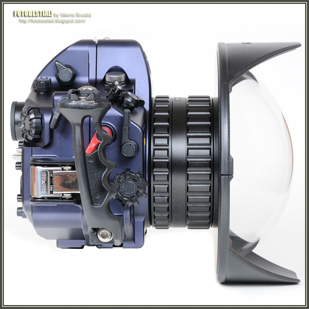

  16. Ok guys,
    I've read all the discussion, but I don't understand why no one makes the consideration that if an achrylic dome is completely scratched you simply have to change it with a new one! With the price of a glass dome you can purchase 4 achrylic S&S 240 mm.
    This is mathematic, no opinion.
    This is my 240 on mdx d800 the picture showed the 17-35/2.8 setting. At the time my dome is in good condition and allows me to make direct sunlight picture.
    Chris, are you in Orosei in June?
    Bye

  18. Yes Tim,
    You tell the truth, but I'm not sure that a port like the 230mm Glass super-coated Zen dome can give me a really appreciable quality improvement (compared with the good S&S 240mm). Probably after one or two year of use my acrylic dome will be ready for the trash bin, probably. I'll be happy to restart this discussion at that time!
    There is another factor: in any case our systems (dome+ extension) are an approximation. The correct optical "centrature" needs a specific calibration. There are some systems (ie, Seacam) that offers a wide choice of extension rings (with a very complete lens chart) but not the Sea&Sea System, in other words for s&s users this kind of calibration is absolutely approximative.
    In this contest the research of the pure highest optical quality could became a Chimera.
    But I'm very curious, I'd like to compare a Zen 230 to the S&S 240 on MDX D800 with my favorite lens the (old) Nikon 17-35 using a different set of extension rings.
    Ok, I've the housing, the camera, the rings, the acrylic dome, the Nikon zoom and a friends of mine ... the swimming pool :)
    Missing only the Zen 230 Dome for S&S, sorry :aggressive:
    bye
