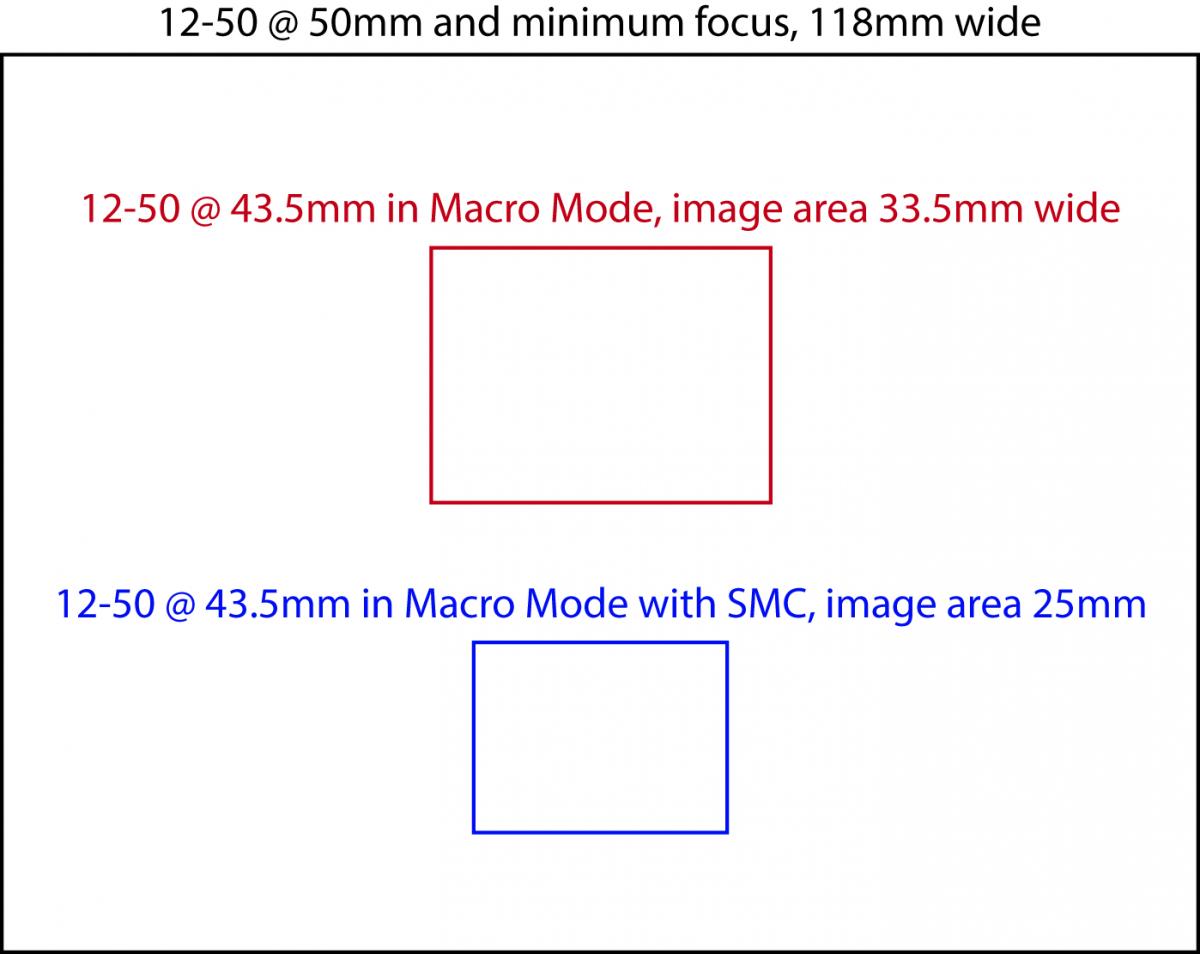

  10. I disagree with Moses's strategy of using the 12-50 in Macro Port 65, which doesn't allow use of the lens' built in macro mode. This is a really compelling advantage, depicted here:
    It probably isn't the highest quality lens available, but I don't know of any lens on any other format that gives the underwater photographer this range from almost wide angle to almost macro, then with the flip of a switch pretty serious macro. For someone looking for flexibility on a dive this is hard to beat.

  15. Note that the 12-50mm in macro mode is 1:1 equivalent (25mm wide). Olympus specs on this lens are wrong. There are a number of threads here that discuss this and i've checked this myself.
  16. Macro 1:1 is 36x24 if it was 25mm it would be super macro
  17. I'm an idiot.
  18. Ryan diagram is correct it is 33.5mm wide in macro mode so slightly better than 1:1. If there was a way to keep the 24mm equivalent in water this would be terrific for video. My only concern is the lack of stabilisation the 12-50 is not stabilised and am not clear if the GH4 has a sensor shift stabiliser or not
