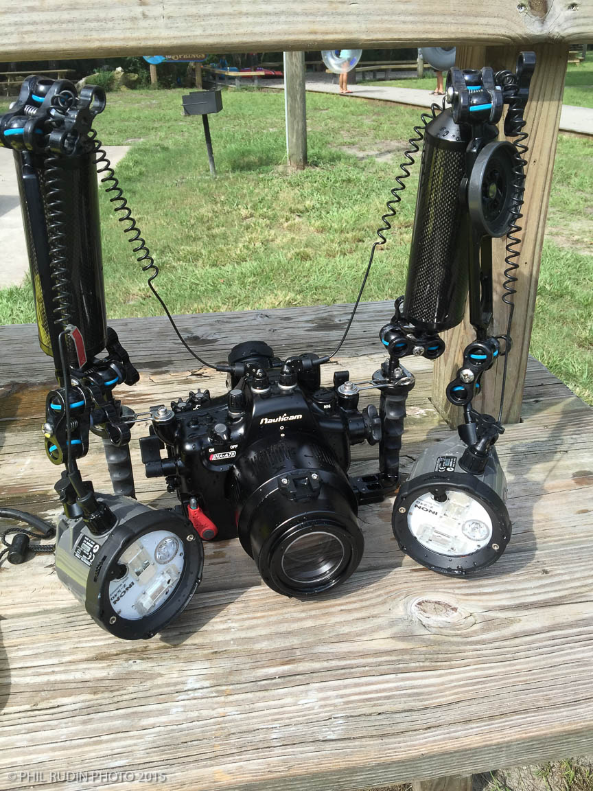

  4. This is the Nauticam port for the 90mm macro and NA-A7II housing. Has a mounting point at the front for a focus light. Seems very well balanced when used with the attached float arms and Inon Z-240 strobes.
    Edited by Phil Rudin
  5. Wow...that's what I have been dreaming of...just got my A7r II...
    BTW, the low light focusing ability of A7rII is still behind that of D810 or 5D3...so...video lights need to be placed somewhere on the housing along with two Ions Z240s
