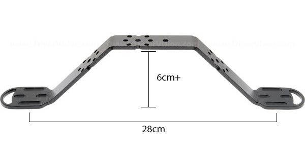

  1. I emailed DiverVision and provided specification of the FlexiTray II and they said they could provide one to fit (Handles 28cm apart, not like the big FullFrame housings which are 35cm++ apart)
    I'm out by 93€ - lets see if the gamble pays off! :)

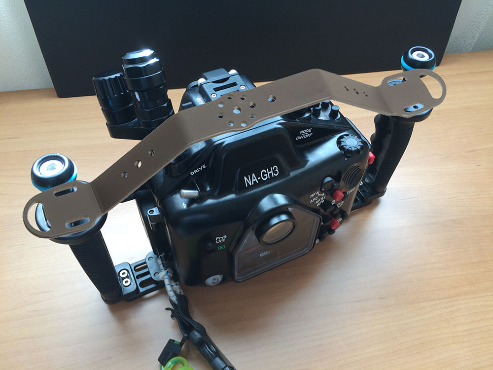

  5. It arrived. Unbelievable!! 2 days from Taiwan.

  7. Yeah, I've had to go with the different type of ball arms (the ones with 4 holes and round base) (and the additional flat bases....)
    As to Focus Light - you are completely right this could be a problem (not with camera till Saturday)- but as you can see there are 3 mounting points on this carrier so, if needed I can get something to screw to this and then clip on focus light on. The righthand side I've will put a ball joint on for the Ninja.

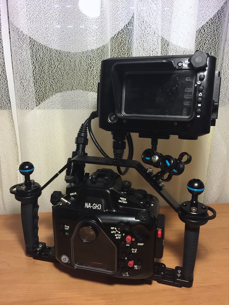

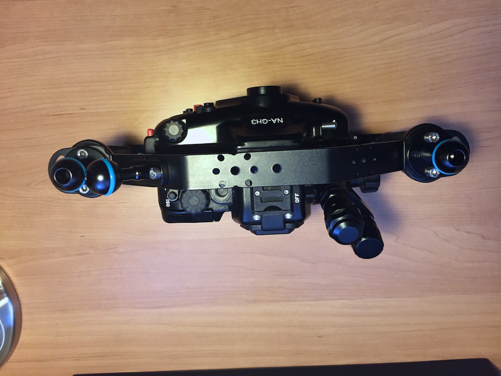

  8. Finally got home to see if indeed it was the right size :)
    Had to buy some more Nautical pieces (3 flat bottom ball joints and 2 mounting bases)
    Bneed to spend some more money, as as predicted cold shoe can't be used, so need a YS female base that can screw directly into a M5 bolt hole)
    But super happy with the result. Compared to trying to make something - or upgrade to the NA-GH4.
  9. Hi Richard,
    I don't know if that setup it's well balanced underwater.
    Thinking to my dive style I could not keep the monitor on the top of the housing. Would be a sail.
    Moreover, respect to the classic camcorder shape I find keeping it steady very difficult. A camera is not designed for video shooting.
    I would prefer a configuration like this:
    http://wetpixel.com/forums/index.php?showtopic=53795&page=4&do=findComment&comment=354915
    It seems somenone wrote about this in some thread
    With the monitor behind the camera: much more streamlined and (more important) balanced for steady shots.
    I use a scooter even when I do not need it. The camera is rock steady :)

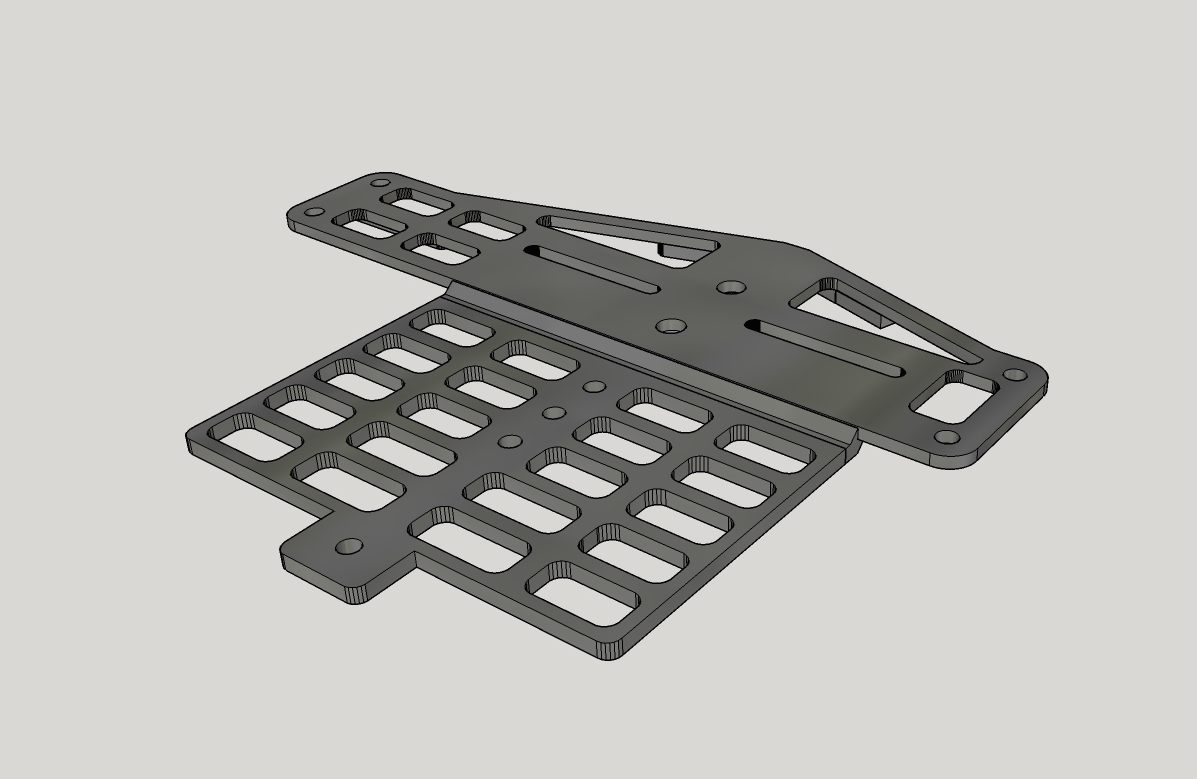

  11. What is that grid plate in the photo posted by EunJae?
  12. I've emailed ReefPhoto already about that cheeseboard plate - but no answer yet.
    I can see that adds a lot Alu to the unit (tray + this) thou
    It would be good, if they did a new FlexiTray - BUT with the plate already intergated. That would save all that excess, as the camera could bolt straight to that and the arms also... I wish I was mechanically minded and had the skills to make all this stuff :D
  13. Looking at the FlexiTray base - Looks like a relativity easy modification.. to get a tray on the back of it...

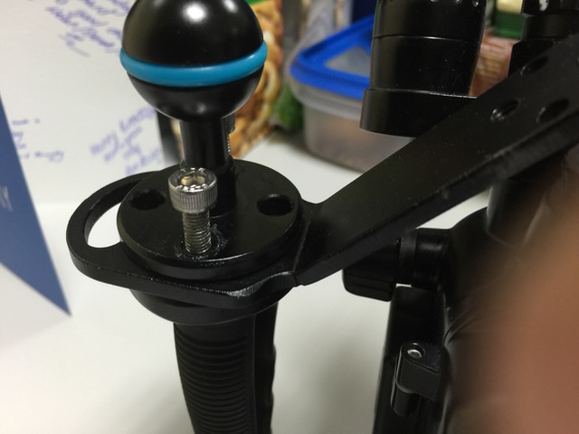

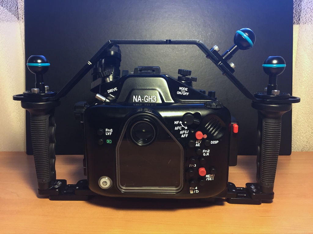

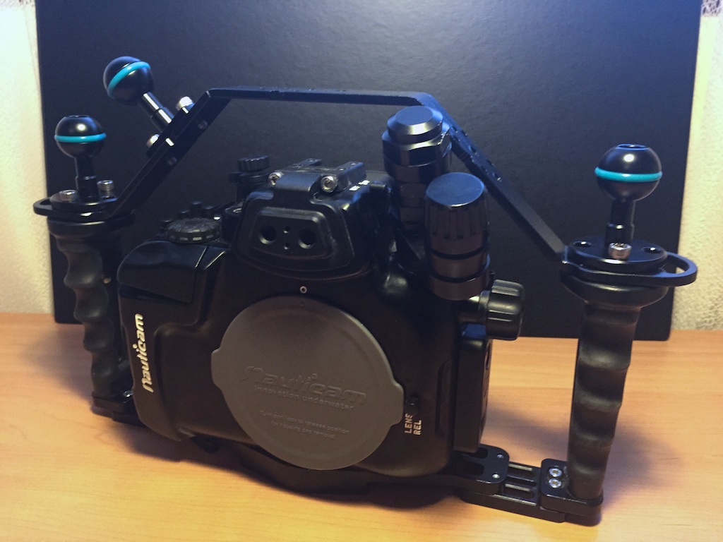

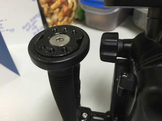

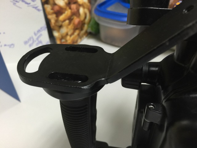

  14. So looks like the nauticam balls fit on top of the handle's attatchment, where you screw it in on top of the grips?
  15. I have the rig at work. Will take some photos for you in a few hours.
  16. Thanks
  17. Hope these help
  18. Richard, how much does the bar/handle weigh?
    Bye
  19. About 110g at a guess
