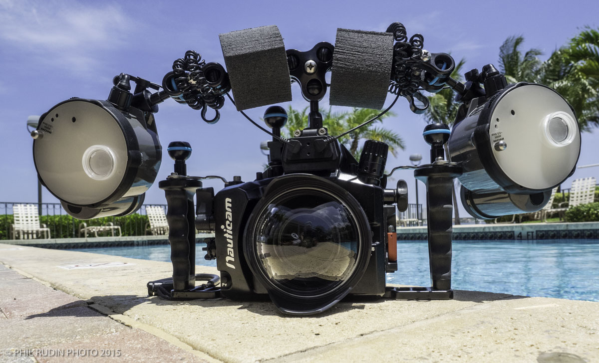

  15. I think the issue of glass V. acrylic has been going on since the beginning of U/W photography and you will find pros and cons. to both with more of the "pro or higher end shooters in the glass camp. Any of these ports on the Nauticam housing can make a very small package for fisheye photography. I use the ZEN Underwater 100mm optical glass port which is actually a Subal type III 100m glass port on a Subal to Nauticam Mini adapter. The upside here is that you can also mount other type III ports to the adapter. I also use the ZEN 100mm with my Olympus 12mm F/2 lens. For over/under I like a bigger port but you can get by in very calm water. I did a review for the ZEN port in a back issue of uwpmag.com. This is one of my configurations for shooting the 8mm fisheye.

  19. This is one of my configurations for shooting the 8mm fisheye.
    Dang, those strobe arms are short. Aren't you bothered with backscatter?
  20.
    If he is shooting right in front of the port for CFWA that will work well. If instead you shoot 3+ feet away and the water is murky probably a bit on the short side
