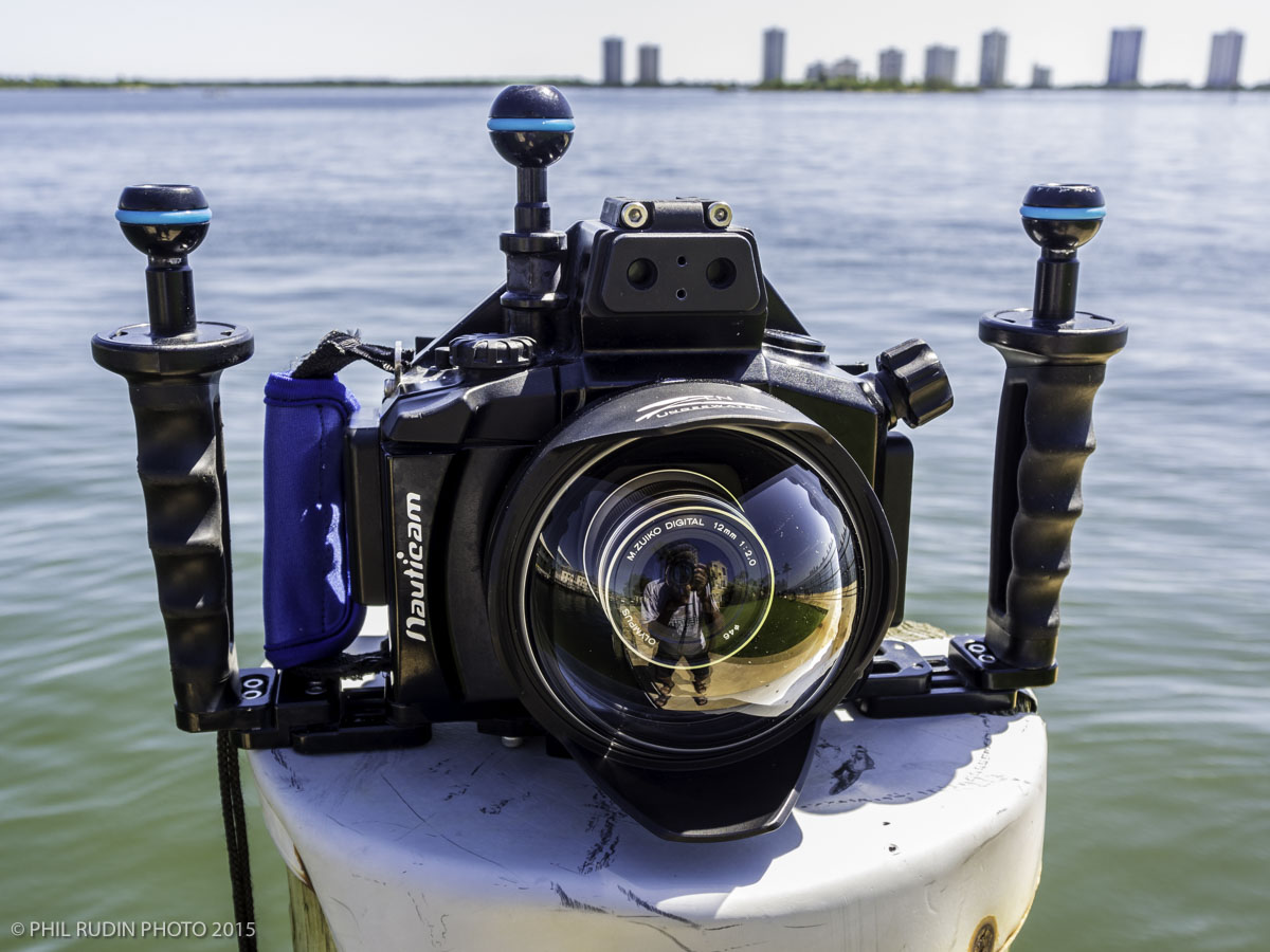

  8. Regarding the ports listed above the ZEN port is for the Olympus housing not the Nauticam housing. The Nauticam version of the ZEN 100 mm fisheye port is different. Nauticam now also offers a 140 mm optical glass Fisheye port that works with the Panasonic 8mm fisheye. Not all of these ports are equal and if you look at the Nauticam port chart and the ZEN listings you will see that some of the ports are listed as FISHEYE ports this reflects the differences in the shape of the dome compared to those optimized for rectilinear lenses. I use the ZEN 100mm port for both the 8 mm and the excellent Olympus 12mm F/2 lenses. Both work quite well with the port for close up subjects. Both of these lenses focus very close 10cm for the 8 mm and 20 cm for the 12 mm which is measured from the sensor. So in effect both lenses will focus all the way to the glass or mm's from it. Using a +2 or +3 diopter closeup lens on the 12 mm just reduces the AOV of an already excellent lens with little to no upside since the lens will already focus within the focus range created by the curved port. For over/under shots and those taken from more that 2/3rd's of a meter you are better with a larger port like the Nauticam 140 mm or 180 mm or the ZEN 170 mm.
    Shooting very close with the 100 mm dome using the strobes pulled in very close to the housing actually reduces the amount of backscatter for two reasons. #1 the strobes can be placed well behind the dome port and #2 they can be turned outward to reduce the amount of light going to the center of the image. These are issues of technique and require much practice. When the port is within a few mm's of the subject you need only light the foreground subject and the rest is A/V light. With a larger port or even the 100 mm port from more than 2/3rd's meter I would be inclined to move the strobes onto longer arms. The strobes can also be mounted directly to the strobe mounting points on the tray or grips with no arms. If you don't intend to do CFWA with the Panasonic 8 mm you may want to consider the Nauticam 140 mm optical glass port.

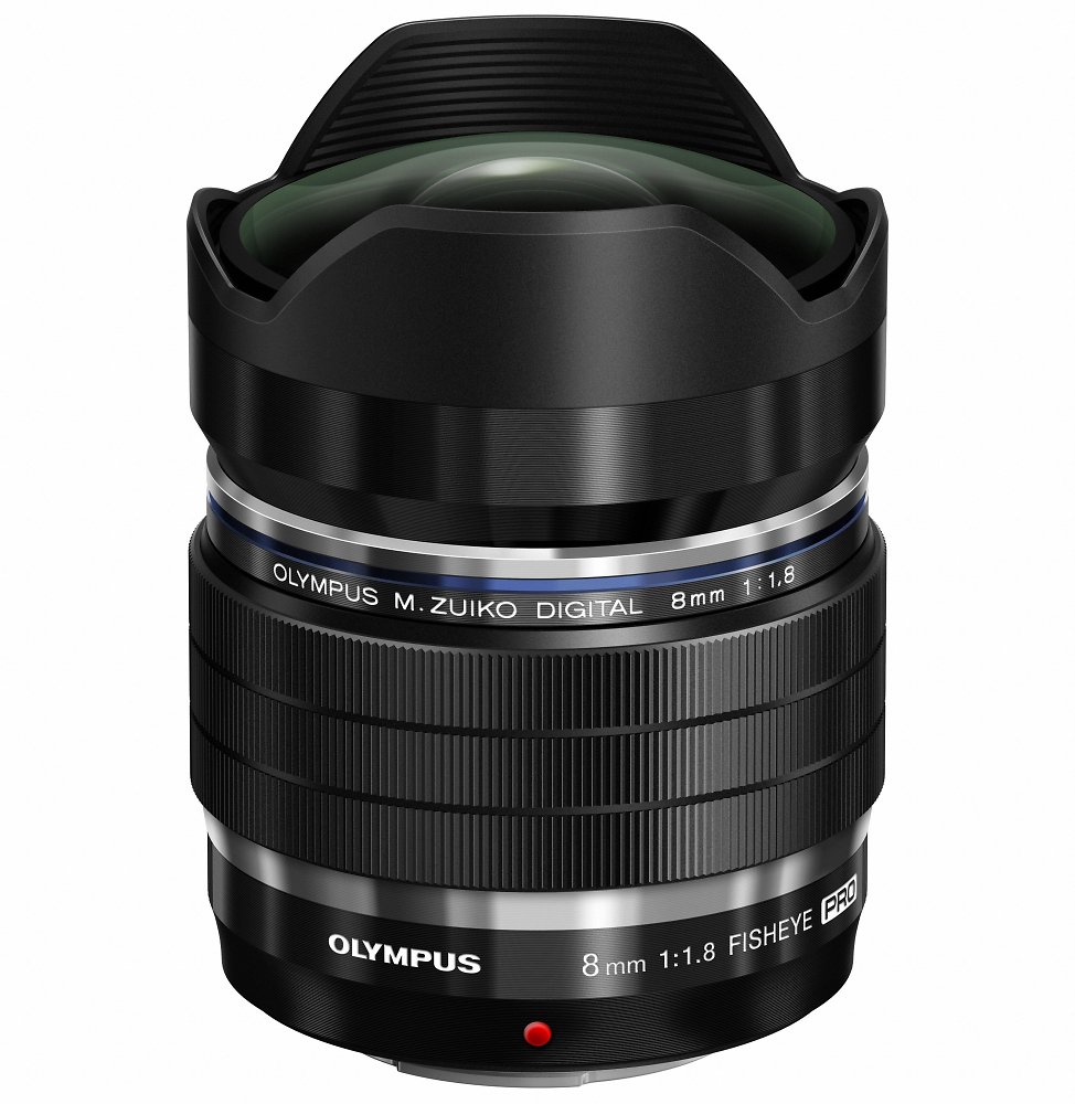

  13. I have attached a link and photo for stoker regarding the new Olympus 8 mm F/1.8 fisheye PRO and you can also see the new E-M4 MKII and other new releases. An Olympus 7-14 F/2.8 PRO zoom is also coming in the next few months.

    Interceptor, In regard to the Nauticam 140 mm optical glass dome port I was answering a question from theatricster regarding his interest in extreme W/A wreck shooting. What I said is that for that type of shooting I think the 140 mm may be the best choice. For CFWA the lens would basically be focusing inside the port and very close to the lens. In the case of extreme CFWA a smaller fisheye port like the ZEN 100 mm optical glass would be the better choice. The 140 mm fisheye is also recommended for fixed focus fisheyes for Canon, Nikon and if Sony FF ever do a fixed fisheye (not a 28 mm plus fisheye converter) offering I would guess for that as well. Regarding the new Olympus 8 mm fisheye I am sure it will be close focusing.
    http://www.43rumors.com/page/3/
    Edited by Phil Rudin
