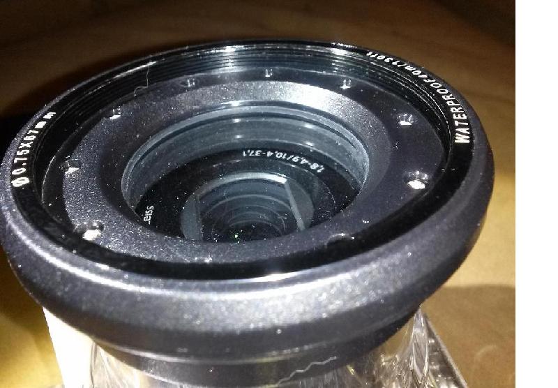

    Here is how the lens fits on the RX100's plastic housing:
    You can see that the lens sits much further back probably 7-8mm from the rear of the glass port (at 28mm, when zoomed to 33mm (or 12mm, as picture specs indicates)), it is maybe a mm or 2 further back. It seems that Meikon was on a learning process in their design of housings, with the earlier housing the least thought out in terms of design and lacking the most features.
    Strangely, the beveled recess of that lens port mates perfectly with the UWL-100 28AD's rear lens protrusion. I did some measurements of the type 2 vs the bayonet mount depth and if I put a type 2 mount on the 28AD, the 2 lenses could mate almost perfectly once it is screwed down, avoiding the vignetting from the UWL-100, and being a much smaller lens. I tried to do the swap, but my screwdriver stripped and didn't want to do harm to the screws, so I will be using the UWL-100 for the upcoming trip.
