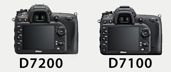

    The D7200 looks very, very similar to the D7100. These two photos come from the Nikon website:
    Maybe this will slot straight into D7100 housings. I know a some housing manufacturers were annoyed that the Canon 5DS fitted into 5D3 housings - meaning no sales for them and also for the manufacturers who are fast to market - no early sales boom over other brands.
    Might the D7200 be the same?
    As a D7100 housing owner, I am particularly interested. Especially as I only have one D7100 body and nearly bought a second earlier in the year.
    Alex

  7. Dimensions of each are the same:
    136 x 107 x 76 mm (5.35 x 4.21 x 2.99″)
    At first glance from the top, it seems like the grips seem might have a very slightly different shape. But it's very close, hard to tell.

  8. Still not seeing or hearing anything to suggest that the D7200 will not just simply slot straight into D7100 housings. Here are some more comparison images from the internet, as such the reliability and provenience of the images are unknown:
    Alex

  10. The button looks a bit taller on the D7200 in all views. Hope that doesn't screw up the housing fit, like the multi selector button on the D300S did for the D300.
  11. seem identical to me, I have no doubt that the D7200 is 100% compatible with all its housings. I do not think for underwater use there are differences so obvious, perhaps for the video.

  13. I was at Oztek in Sydney over the weekend and the guys from Nauticam Australia had a D7200 in the D7100 housing and it all seem to fit perfectly.
  14. I was at Oztek in Sydney over the weekend and the guys from Nauticam Australia had a D7200 in the D7100 housing and it all seem to fit perfectly.
    Were you able to try out all buttons or was it simply that they had a 7200 in 7100 housing?
  15. I didn't test every button, but they assured me that they all aligned and all worked. I believe the D7200 is being released in the USA tomorrow, so hopefully someone will be able to confirm this.
  16. Sofar it looks like the Nikon designers had mercy with the UW photographers!. :cake:
    Edited by albert kok
  17. I can confirm the D7200 fits in the Nauticam D7100 housing. I was working on the Nauticam Australia stand at OzTek over the weekend and I personally put the camera in the housing and tested all the buttons.
    Everything works.

  20. I can confirm the D7200 fits in the Nauticam D7100 housing. I was working on the Nauticam Australia stand at OzTek over the weekend and I personally put the camera in the housing and tested all the buttons.
    Everything works.
    Does this mean that the D7200 will fit into the other D7100 housings that are on the market as well? It would indeed be exceptional that a camera upgrade not automatically necessitates a new housing.
