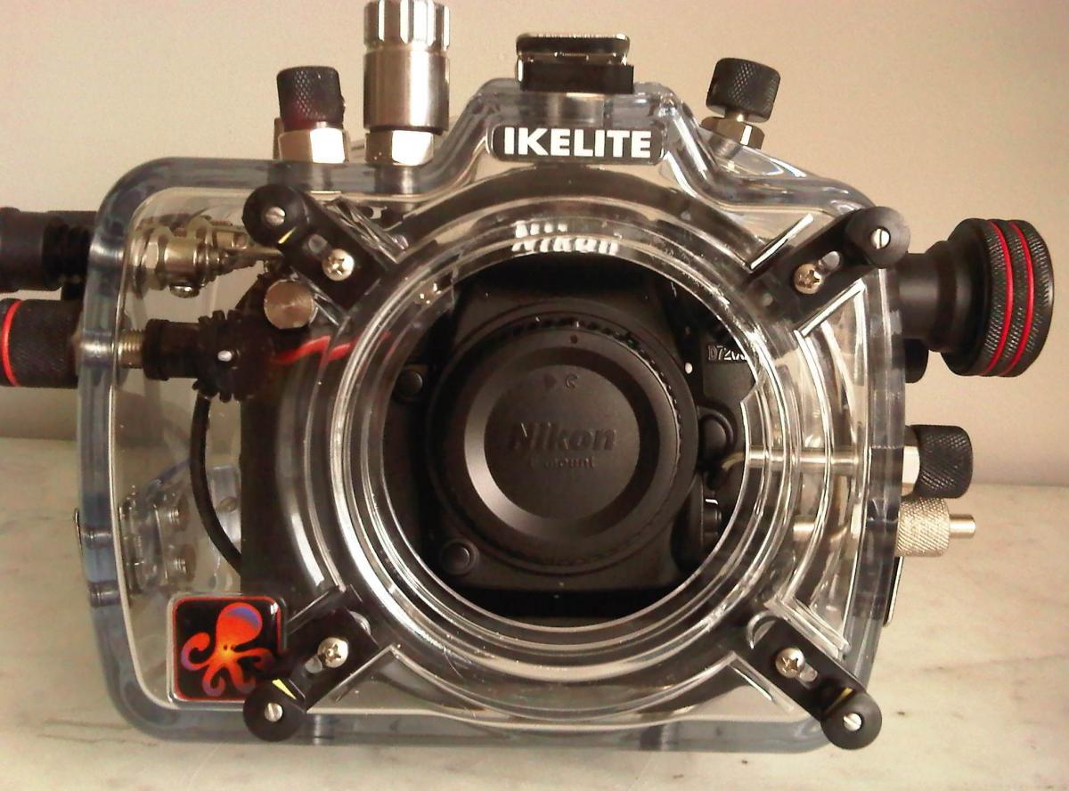

    I took my Ikelite D7100 housing to a camera shop and put in the D7200. Al push buttons seemed to fit nicely.

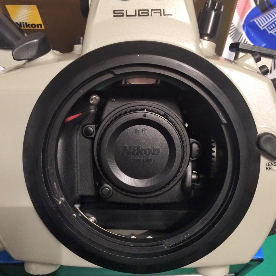

  7. I'd love to know as soon as anyone puts one into a Subal d7100 housing. Thanks!

  9. Thanks Alex. Then there shouldn't be any slight misalignments if it's an identical body? I'm really happy as it was hard to afford the d7100 upgrade for me last year, but now it looks like it was a really good decision. If it serves me as well as the d300/ND30 Subal has, it will be awesome! I love the d7100/Subal & now the d7200 will be even better. BTW, your review of Nikon d7100/Subal really helped me decide Alex, thanks!

  10. No problem. I’ll probably order a D7200 in the next few days or so, been too busy so far. And since I have the same housing as you - I can let you know 100% that it fits perfectly (which I 99.9999% fully expect it to) - if you are not instantly going to buy the camera.

  14. Thanks for this info. I just got the D7200 today and tried it in my D7100 Ikelite housing. All controls seem to work nicely. Havent tried TTL yet. But I wont mind if it did not work like in the D7100 housing, since I never use TTLpost-7335-0-40352700-1428426367_thumb.jpg

  15. Ikelite now has announced a new housing for the D7200. Customers with existing Ikelite D7100 housings can have an upgrade for $150 plus the cost of shipping to adapt their old TTL wiring.
