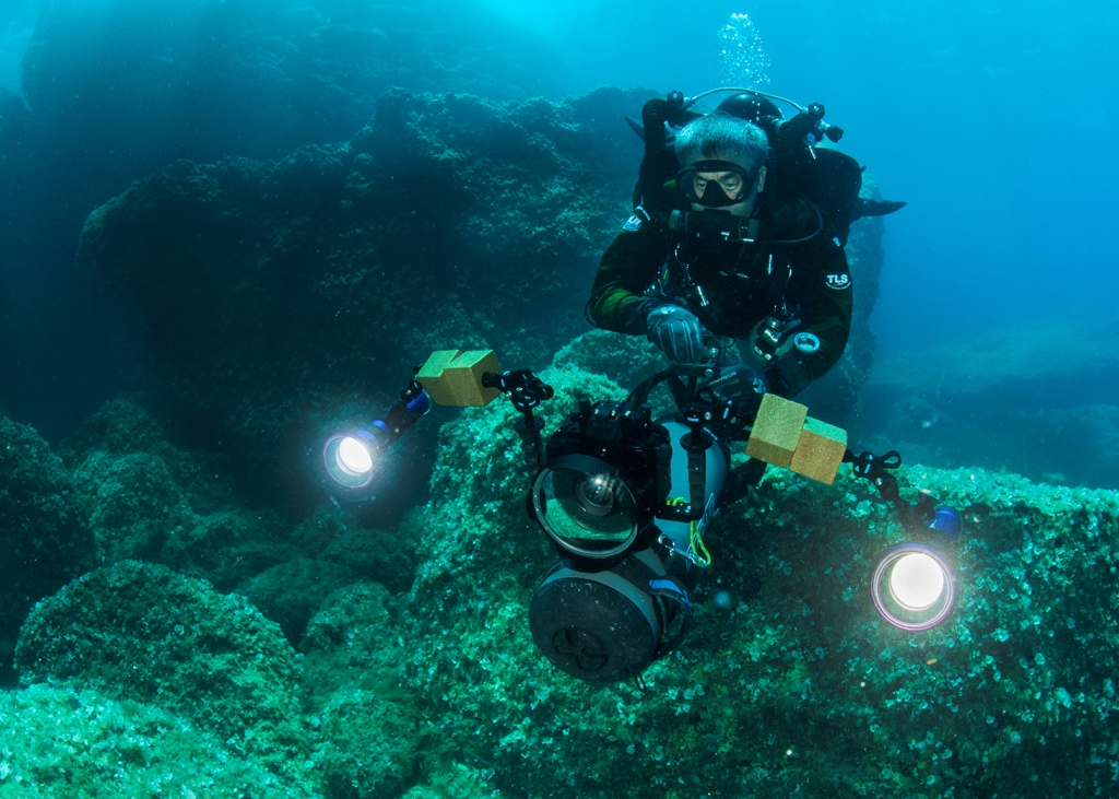

    Mybe my filming style is a bit off topic... but same problem here.
    I'm using 2 x 20cm nauticam segments hence 3 clamps per side.
    It's a PITA to get them right. I try to adjust them on the boat as much as I can. Once they are set I move them backward like in the photo placing the light on the scooter. Otherwise the Nauticam handle get stressed and cracks (I already changed thwo of them). On the mirrorless line they havent the upper metal connection like on DSRL line, hence all the weight applies on two small screws in the handle body...
    Once on the spot, before I can start filming I need at least one minute to get them in position. For my dives (>60m) I haven't all this spare time.
    Now I have a couple of lighter Luna 8 and I'm trying to avoid a segment:
    But I'm not fully convinced of this solution. I dive often in low viz water and long arms help to minimize backscatter.
