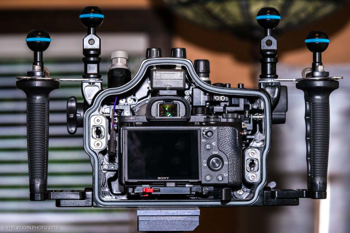

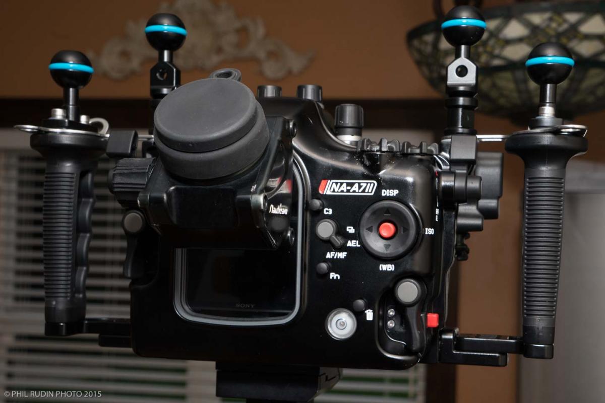

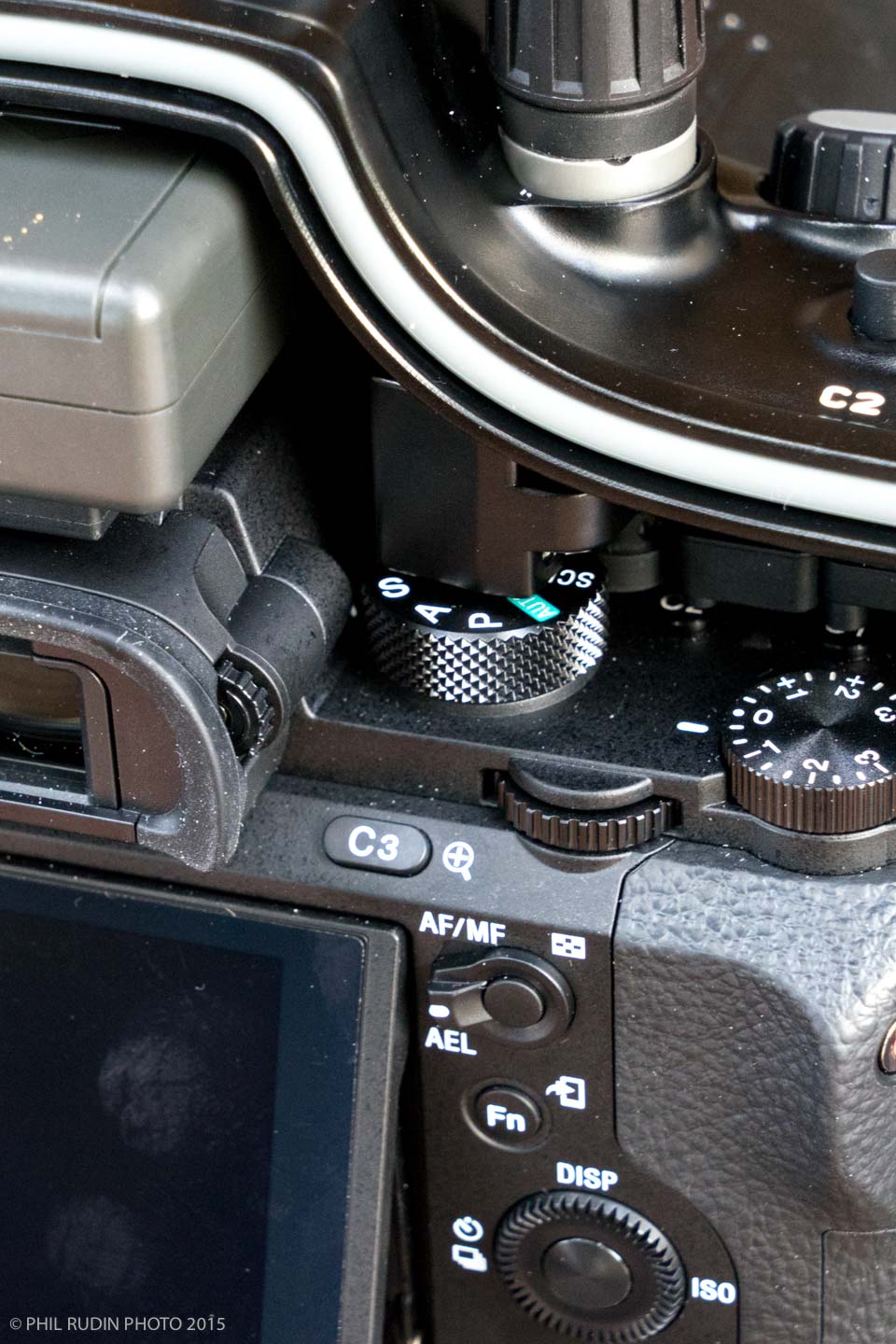

  2. Nauticam NA-A7II housings now support both the A7 II and A7R II camera bodies. All housings going forward from serial number A151096 will have the upgrade to support the A7R II mode dial and past housings can be upgraded. I received my housing yesterday ‪#‎A151098‬ with the upgrade installed. Nothing about the housing has changed other than the mode dial upgrade. Photos attached.
    My Sony A7 II/ Nauticam NA-A7II review should be posting on 1 Sept. in the Sept/Oct issue of uwpmag.com, this is a free PDF download.

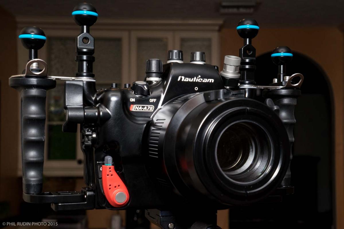

    Since yesterday i have my Nauticam NA-A7ii housing! Tomorrow i will make the first dive with it!
    I have some questions to you or other owners of an NA-Aii housing:
    - Is your LCD to VF switch working perfect?
    I can switch from the LCD to the VF but not back, if i switch from the VF back to the LCD, the LCD remains dark. I have to turn off the camera so that the display runs again. At the moment i have set the FINDER/MONITOR SEL to a custom button, but this works only with the A7rII not with the A7II
    - What lenght of the Nauticam float arms you use on your setup with the 90mm Macro (on your pictures in the NEX Macro Option post)?
    Thanks for your answers and a nice day from Switzerland,
    Tino

    The EVF/LCD control is just a mask that covers the EVF when you want to use the LCD. If your camera switches from LCD to EVF when you raise it to your eye above water it should do the same thing when you move the control underwater.
    The Nauticam float arms in the photo are ten inch.
    Griff
