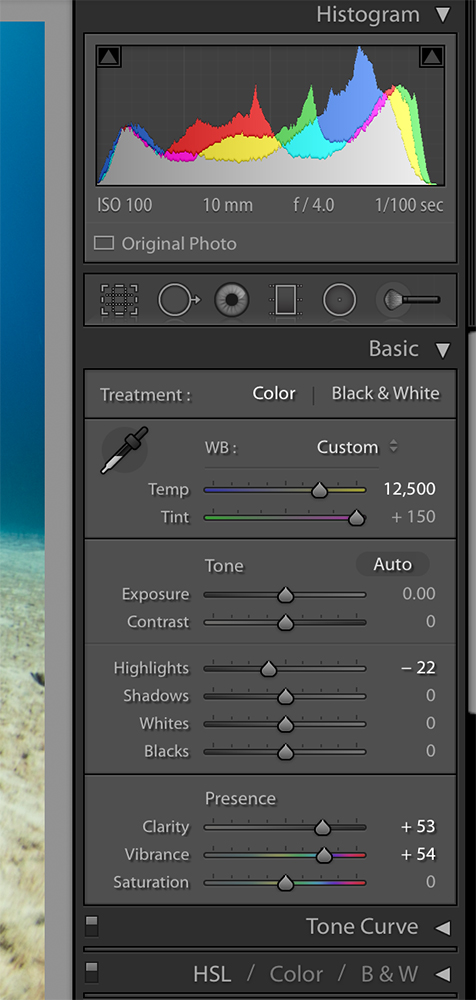

    From Lightroom/ACR the white balance slider is imported as this:-
    Its an issue because the original JPG looks good, importing the preview jpg (embedded with RAW) displays as per the camera. Then when its thumbnailed and finished importing the lock to the green with maxed out tint and balance settings.
    It means i can do very little or no colour correcting editing in the Adobe products. Canon DPP imports it looking pretty much as per the JPG with full adjustments allowed. Exporting the RAW from DPP as a TIFF then importing that TIFF into lightroom allows full adjustments to be made.

  5. I think you have reached the limited of what Adobe can do in color correction. I looked at some of my Hawaii pix. 150 is the max correction for tint - hit a wall as well when shooting though a lot of water and no flash. Most shots require less than 150. For example one was at +64 for a school of fish at a distance but with flash.

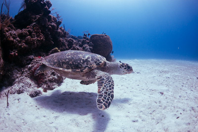

  8. Here is a version of the turtle unprocessed and processed in Lightroom and only in Lightroom with a few clicks - (this is just a virtual copy of the original file):
  9. Here is a version of the turtle unprocessed and processed in Lightroom and only in Lightroom with a few clicks - (this is just a virtual copy of the original file):
    So what exactly did you do? I gather something beyond the tint slider since it was already at the maximum setting.
  10. I'd really like to know, too.

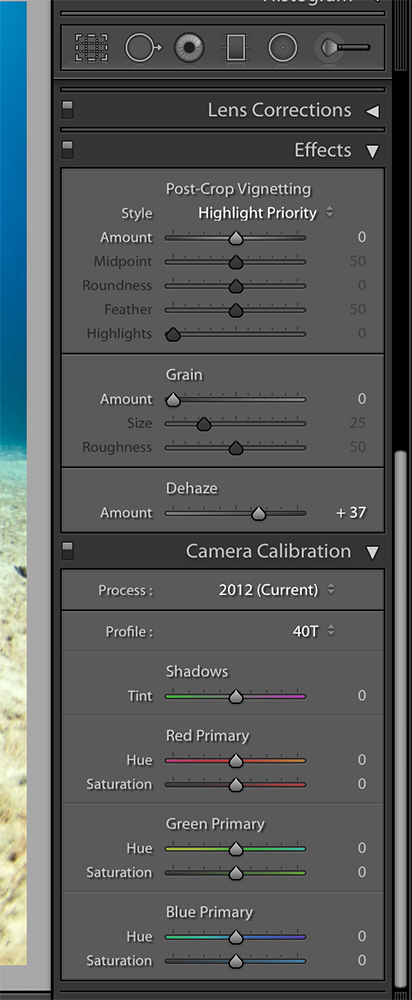

  13. These are the Lightroom adjustments I made. It was only a quick process - so these were all I bothered with (the answer is in there - although not easy to spot):
    Alex
  14. the answer is in there - although not easy to spot
    OK, I'll bite.
    Is it your custom calibration profile?
  15. Yes. The solution is to make a profile with a higher Tint starting point. This one was called 40T - as it adds an extra 40 units of Tint before you start using the Lightroom controls.
    String’s problem is that Canon cameras in particular can add more tint in camera (more than +150) than you can in Lightroom (limited to +150). DPP supports this in the Canon RAW file. Lightroom does not. It is why I always tell Canon shooters to use RAW + JPG when shooting filters. Or use this work around.
    You can also achieve a similar affect with the sliders in the Camera Calibration module - but I find them fiddly to use. The Custom profile solution is one click simple and it s stored in Lightroom for future use. The profiles are Camera specific.
    Alex
  16. Yes. The solution is to make a profile with a higher Tint starting point. This one was called 40T - as it adds an extra 40 units of Tint before you start using the Lightroom controls.
