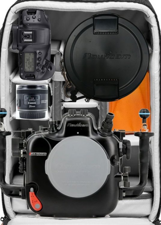

  7. Here is an in-scale  visualization of the Protrekker 450 with the NA1DXIII, WACP, 1DXIII and lense. It looks doable, if I remove one handle. For the air travel that is ok. Total weight about 14kg with laptop. Perhaps I'll take with me a plastic bag. If weight or size becomes a problem, I'll check in the empty backpack and carry my gear in a plastic bag;-) The Keldans will have to fit elsewhere, e.g. my coat pockets or carried by a friendly mule...

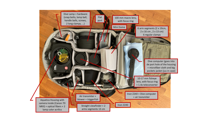

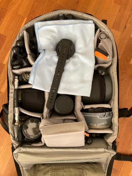

  11. Finally I was able to take a picture from my backpack with the equipment. Much easier to explain how I pack my rig for air travel.
    Total weight is 14.6 kg without computer and 16 kg with the computer. The backpack is a Lowepro Computer Trekker II.
    Besides this, I take the remaining important equipment at my wife's carry-on: 8 inch dome port, port extensions, housing handles, chargers (camera, strobe batteries, dive lamps batteries, computer), vacuum pump, focus light, 2 buoyant segment arms, Sixt buoyant collar for macro port, and 2 regulators (one and hers).
    If she is not going, it goes to the checked luggage.
