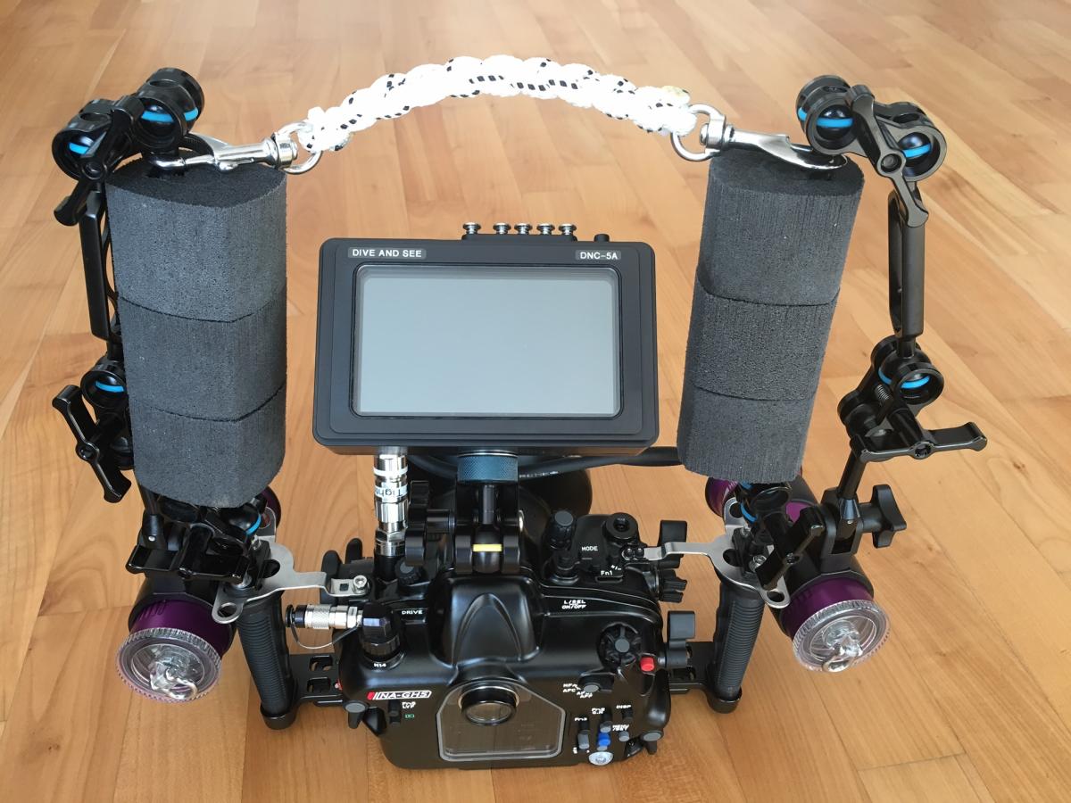

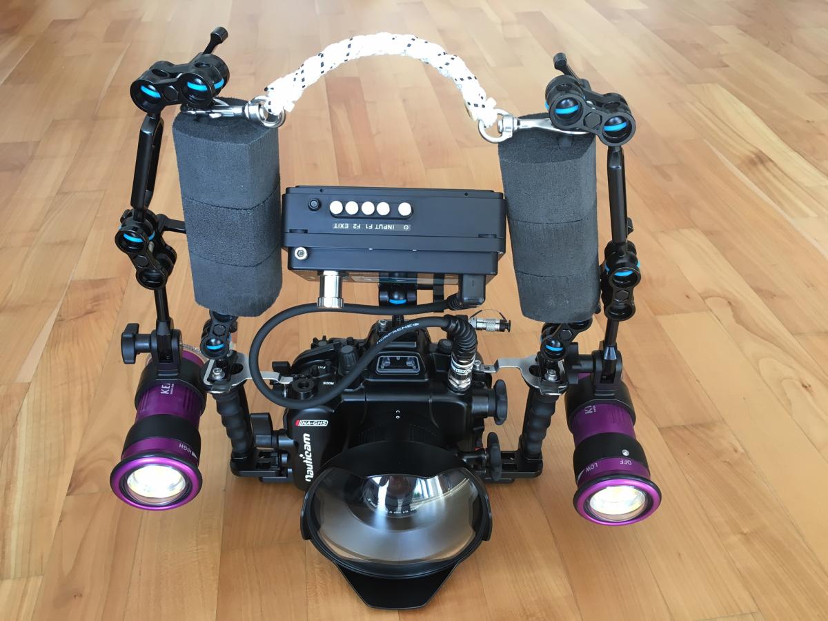

  8. My own GH5-Rig is slowly taking shape. Today the brand-spanking-new DNC-5A Monitor from DiveandSee has arrived. It is so new, its not even on their webpage yet :) I am certainly gratefull to Alex for shipping me a unit for my upcoming trip before official release date.
    5.5'' full HD resolution. Looks splendid on land, so it should underwater. Quite a bit heavier at 1.3kg (appr. 250g negative in water) than the earlier DNC-5 but I guess the larger and brighter screen just needs a significantly bigger battery and more electronics.
    Size relation to the GH5 housing looks just right. I'll happily report more once I got it sufficiently wet.

    That Dive and See Monitor looks ACE. Much smaller than my 7" NA-Flame - and appears to be in a better viewing position too.
