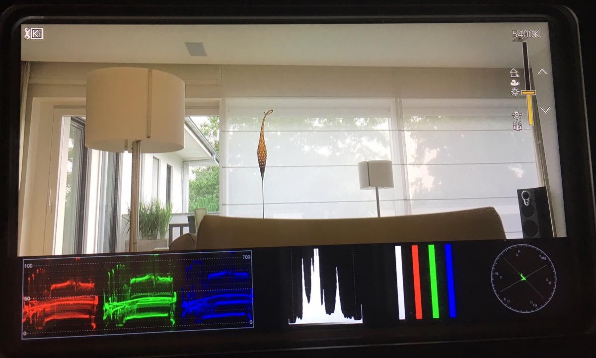

  6. I have to admit the new Atomos screens (in the Flame and Inferno units) are to die for underwater, ultra bright and sharp and using the RGB parade, I can manually adjust the WB using Kelvin instead of using slates while eyeing the Red channel.
    Richard, you can do Kelvin tuning on the GH5 natively. Put on the RGB overlay on the DNC and you get the same tool - maybe not as effective as with the Atomos, but it works (see Kelvin in upper right corner with up and down arrow to adjust)
  7. oooooh that is even better than the Atomos displays! WOW
    Is the overlay at the bottom of the screen generated by the DNC monitor, or by the GH5 itself? Does the DNC have any options for displaying false color or zebras (for exposure)? How about peaking/punch-in and/or other focus aids?
  12. the overlay is generated by the DNC. You also have the option to overlay false color, vectorscopes, various zoom-ins etc. Peaking and Zebras as well, but I actually use both of those from the GH5 and have them displayed on the DNC as they work so well and I got used to them overland :)

    One (serious) grain of salt: the GH5 only seems to be able to tune in Kelvin up to 9900 - which would not be of much use for underwater. How much can you tune in on your Atomos?
    Same on the GH4 - up to 9900k. There is no WB adjustment possible on the Atomos units, just eyeballing to make sure the RGB parade levels roughly.

    Manual WB is supposed to work very well on the GH5 underwater. I am planning to use that primarily, just wanted to see whether that Kelvin tune-in Richard mentioned might be another option. I'll try it out in August when I get underwater anyway...
    I just find using the up/down buttons and looking at the scopes a lot easer than using something to WB off.
