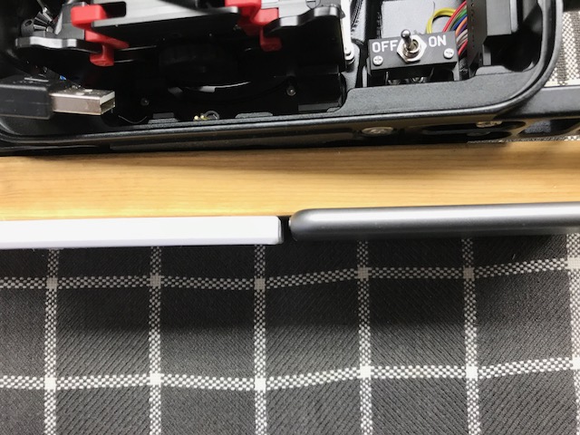

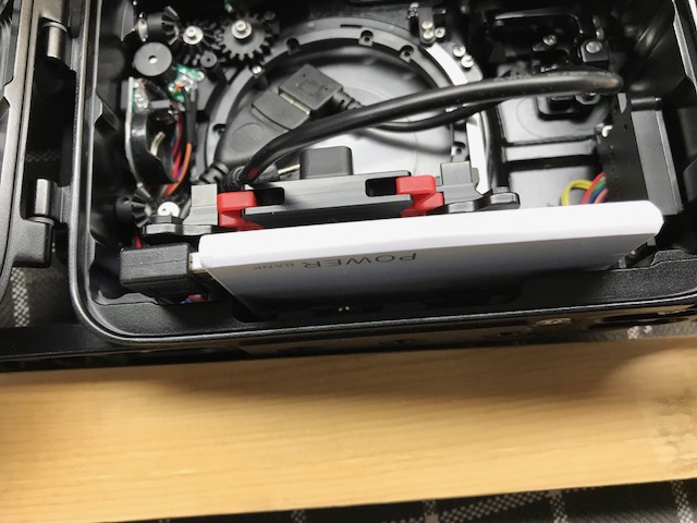

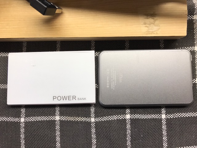

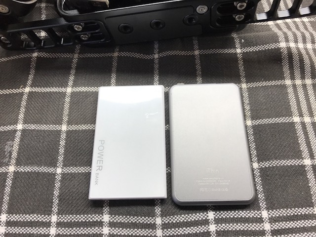

  9. I found this battery for $12 on Amazon https://www.amazon.com/dp/B01M19ZRKZ/
    It's a snug fit, but it works. See pics below.
    I also ordered the USB Battery Pack Keep-Alive Load Kit (link above) and this USB 2.0 Extension Cable-Right Angle A Male to Female- 3.9 Inch(10 cm) for $8 on Amazon https://www.amazon.com/gp/product/B06XRW713L/
    I'll give an update if it works and fits. - Colin

  18. One thing I forgot to mention, I tested the $12 battery I found on Amazon (see post above) and it stays active all the time.
