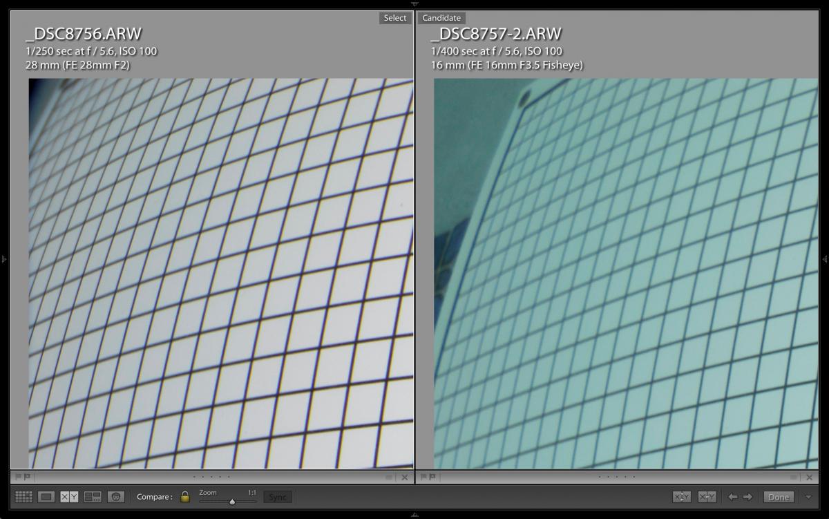

    Would also love to see a test of the Sony 28mm f2.8 on a Sony FF behind the WACP.
    Do you mean 28mm f/2? If so, this hasn't ben a priority because it is very well supported by WWL-1, but I would expect that it is also quite good or better with WACP. This is my assumption, and has not been tested to my knowledge.

  18. @Ryan: "At any given field of view WACP (with a compatible lens) will be sharper in the corners than any lens behind a dome resulting in the same FOV at the same aperture."
    Is this true for rectilinear WA lenses only - or is this also the case for fisheye lenses?
