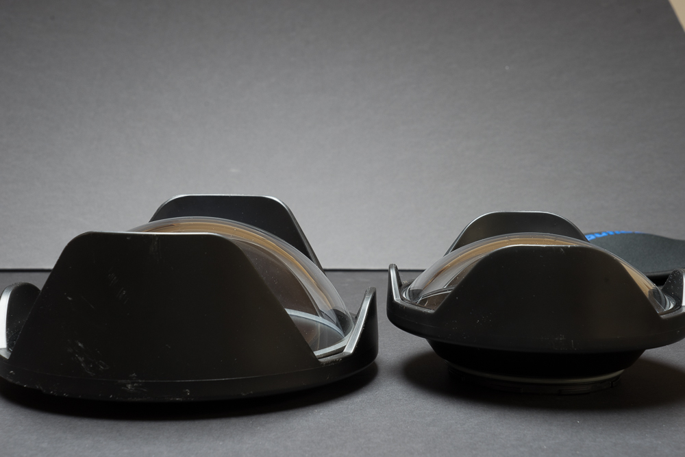

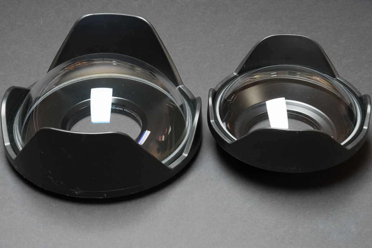

  16. 230mm vs 180mm domes - corner sharpness wise I wouldn't expect a significant difference with the 16-35 f/4. The actual curvature of the domes is very close, if I recall correctly it's 110mm vs 120mm radius and the center of the 230mm dome is positioned maybe a centimeter or so forward of that of the 180mm.
    Wider lenses - there will definitely be a difference, but not the 16-35 IMO.
    Here are the two domes side by side to illustrate my point:
