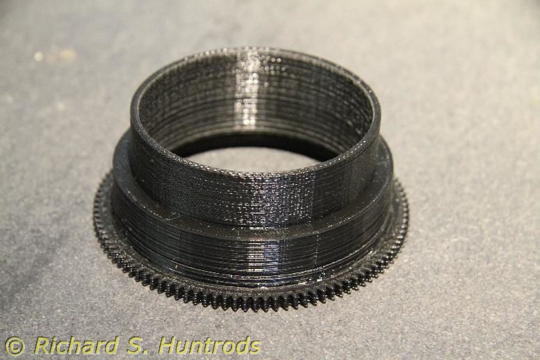

  14. The focus gear (I had a photo). It's a friction fit on the Canon EFS-60mm f2.8 macro lens. The fit is snug and it works very well.
