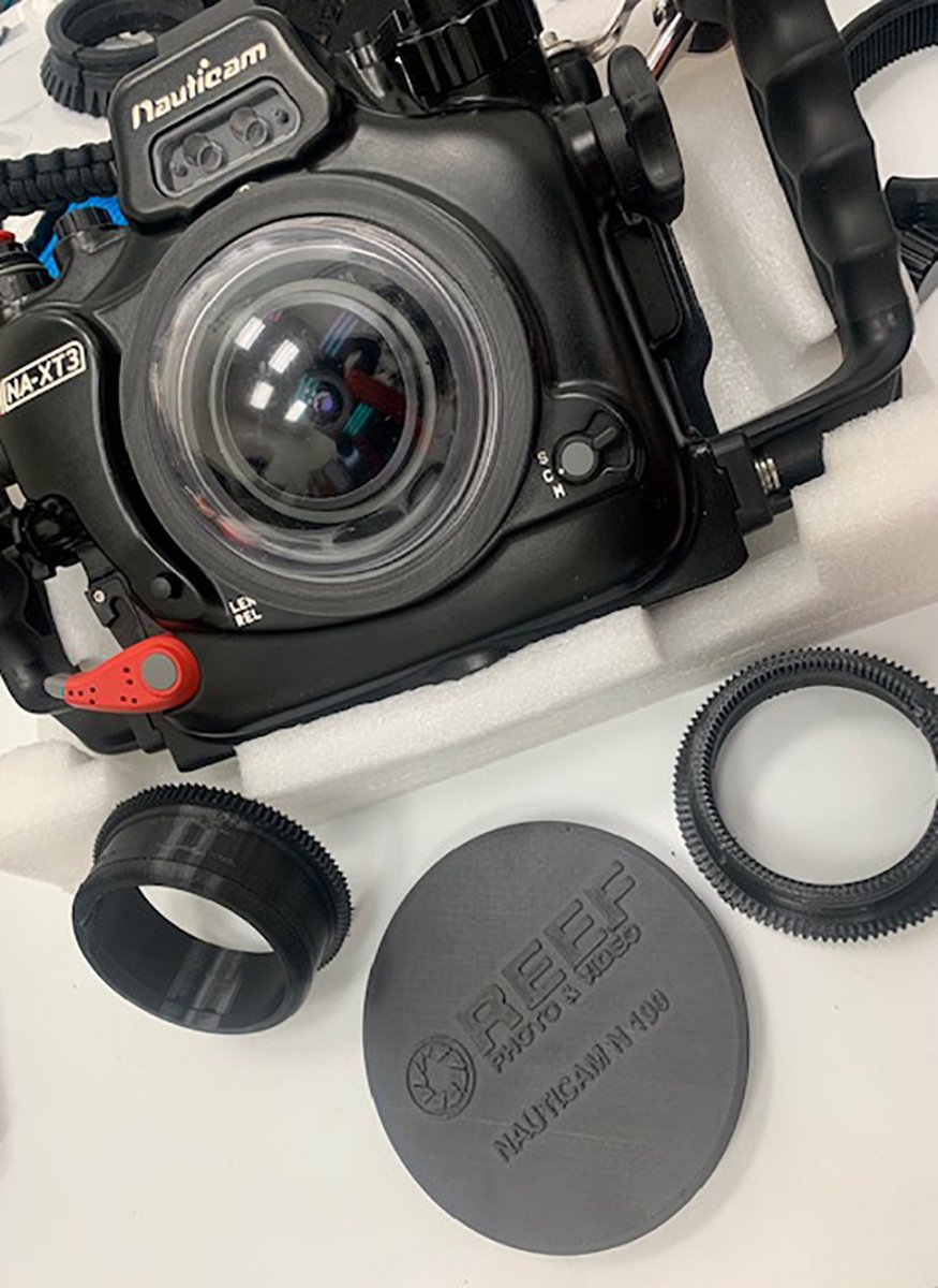

  11. Just saw this post. I am heavy in to 3d printing. I print all my gears. I use FreeCad as a design platform. A little learning curve but works great. Good tutorials from"Mango Jelly Solutions for FreeCad" on YouTube. I have already printed a watertight 3d housing for a Osmo pocket 2. I am now working an adapters for Nauticam housing to other ports.

  12. Those look like some very nice gears, obviously high-quality prints! I'm just getting into 3D printing now and bought a printer a few weeks ago. I got a Creality 3 S1 printer. I've done a couple of original designs and printed in PLA and PLA+ to date. Results have been pretty impressive, but there was some adjustment to move from one material to another.  I did my designs in FreeCad and Fusion 360 so far, and may poke around with OnShape. My impression so far is that Fusion 360 seems to be quite a bit more sophisticated than FreeCad, and not any harder to use.
    I'm curious what your are using for your prints, can you share some details?
    Edited by davehicks

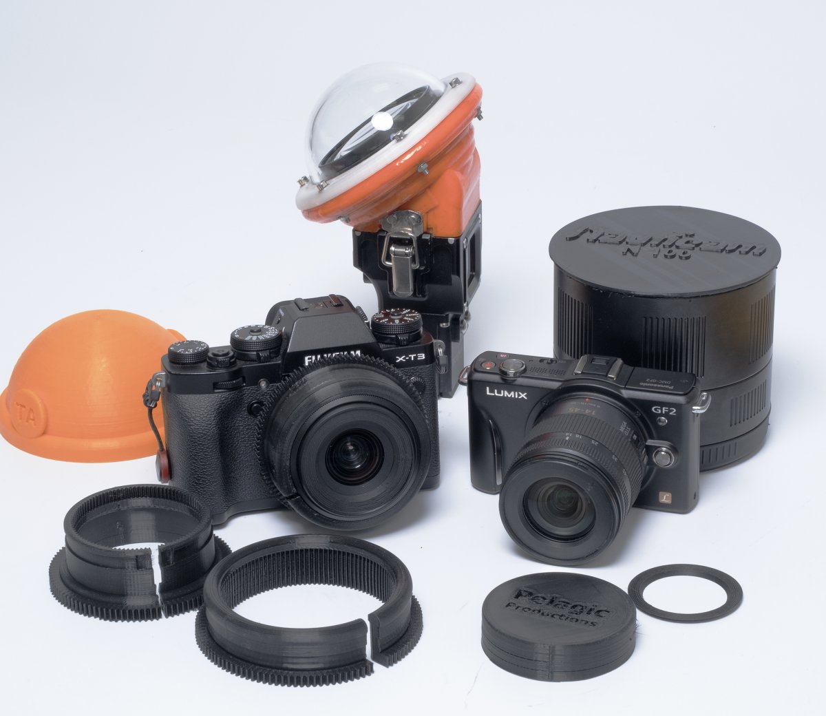

  13. For gears I use a semi flex material, Colorfab nGen flex .For rigid parts I like California filament matte black petg. The  printede circular discs, to block out writing on the front of lens, uses this matte PETG. Parts are printed on  a Creality cr-10 v2, .04 nozzle. Freedad has a gear envolute gear in the parts design menu. Add the modulus, number of teeth and angle of gear and the extrude in the parts menu. I think PLA does not have the UV and heat stability of PETG.
