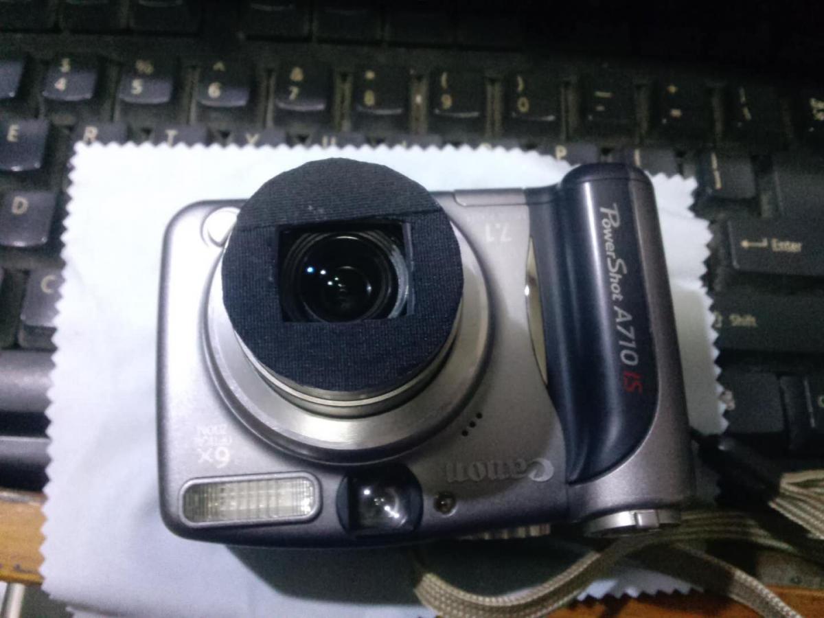

  4. Stick black cloth around your lens,Light absorbing cloth,like thispost-70299-0-52336200-1547888092_thumb.jpg

    A top tip is to block off the light coming back into your camera. It stops weird reflections coming back into your sensor. I normally place the camera in the housing then use a cardboard business card. Insert it over the top of the lens and push it as far towards the glass of the housing as possible. That stops light getting in and (if you use your internal flash to trigger external strobes, or just use the flash on it's own) the internal flash light escaping through the front of the housing causing extra backscatter. I also covered any clear plastic on my housing with black electrical tape for this reason.
