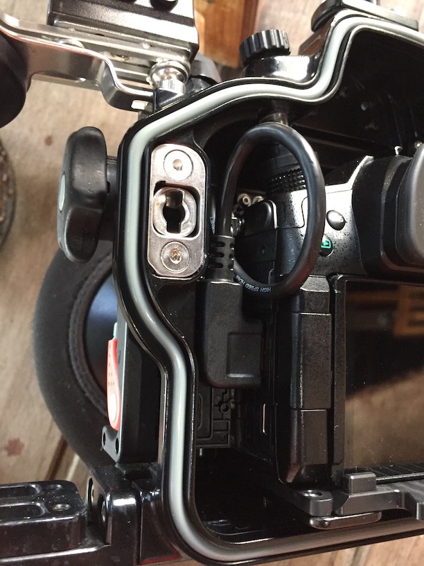

    Do you mind showing the picture inside the housing with internal cable connected? I just receive the housing but realize i have to order the cable for GH5 separately. Also got me thinking why didnt nauticam reverse their standard hdmi so it doesnt have to bend down and up again just straight up.
  16. Do you mind showing the picture inside the housing with internal cable connected? I just receive the housing but realize i have to order the cable for GH5 separately. Also got me thinking why didnt nauticam reverse their standard hdmi so it doesnt have to bend down and up again just straight up.
    Hi, sorry I've been "out of range" in Raja Ampat.
    Do you still need a picture?
    The cable does a loop inside the housing, which allows the camera to slide out enough for battery and card change.
    No problems with the cable during 5 weeks of heavy use, but I have been careful...

    I’d be interested in seeing that pic. So far I’ve always taken the cable out of the camera to swap batteries and memory cards.
  18. This is how I loop the cabe in the housing, and it (just about) allows me to slide the camera out enough to change battery and card.
    Its close to the focus zoom mechanism, but doesn't foul it.
