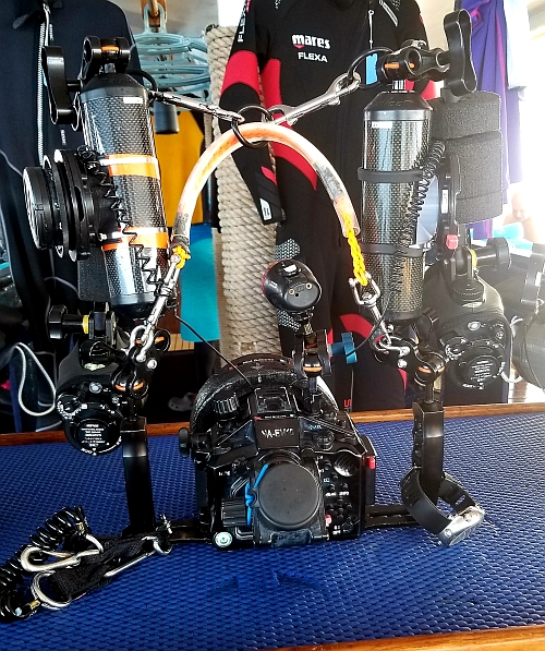

    From a recent trip. (Sorry for the confusing background.)
    The left float arm has a CMC-1 on a bayonet dock. The right float arm has an empty dock for the WWL-1, currently mounted on the port.
    That right arm needs to be long enough so the WWL-1 in its float collar will fit. Mine are 10 inches, I'm not sure 8 inches would be enough....it would be tight.
    Also, right float arm needs to be rotated so that the dock is facing outwards, so the WWL-1 will bayonet on without hitting the outside arm (with the STIX floats).
    My float arms are the old 60mm, and the dock mounts are from an old WetPixel thread in which TheTrickster developed the 3-D printed dock base. http://wetpixel.com/forums/index.php?showtopic=57299 Itis for sale at https://www.shapeways.com/model/upload-and-buy/5506941.
    However, Nauticam now makes its own bayonet docks for its newer 70mm and 90mm float arms. https://reefphoto.com/pages/search-results?q=boyonet-holder+float-arm&type=product.
    I've got a couple of the 90mm 8-inch float arms, and would love to try the Nauticam bayonet dock on it instead of the longer, thinner float arms I'm using, but it is an expense I don't really NEED to make!
