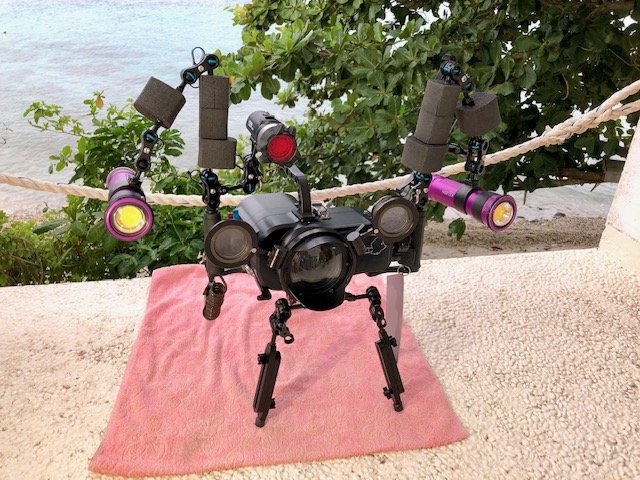

  1. Here is my first video using Sony camcorder  HXR-NX80 taken during the last diving trip in Philippines this August:
    I have not mastered this camera yet, and on a few occasions I inadvertently used wrong settings (i.e. the internal ND filter was on on a few dives).  Also, playing with different settings and filters resulted in some color inconsistencies between different clips.
    While I am still trying to master this camera, I will greatly appreciate constructive criticism and recommendations.
    The following equipment was used to make this video:
    Camera: Sony camcorder  HXR-NX80
    Housing: Gates AX700 / Z90 with Gates GP34A Wide Angle Port and internal UR Pro Red Filter (on most dives) and UR Pro Pink Filter (on a few dives)
    Tripod: Gates Tripod
    Diopters: SAGA +5 Diopter Achromatic Close-Up Macro Lens, and SAGA +10 Diopter Achromatic Close-Up Macro Lens
    Video Lights: Keldan Video 8X 11,000 Lumen CRI 92 (5400K) with Keldan Ambient Filter M1 (10-20m) for 4X/8X
    Camera Settings: 4K, 30 FPS, Picture Profile: BT709.  I followed the following article for recommended camera settings: AX700-Z90-Housing-Recommended-Settings-R2.pdf
    In my decision to buy this camera and housing,  I followed an advise from Juan Monterey, who convinced me through his articles that this Sony camcorder is one of the best cameras for underwater videography:   http://wetpixel.es/mi-actual-equipo-submarino/

    One things that puzzled me with this Gates housing is providing a control knob for ND filters, as I have never been in a situation yet when there is too much light under water. Maybe someone could enlighten me about this.

  2. Excellent and a great improvement over the A7. The URPRO filter works well with Sony cameras for some reason
    The camera is also held very steady don't know if you have stabilised in post the port with the diopters together with the camera 12x zoom work a treat
    In some cases the colours look a bit cold maybe you wanted to keep the natural look or the keldan filters were in action and they result cold
    If you only shoot video there is no need in my opinion to go for a camera the ergonomics are just too hard compared to a nice camcorder
    Also the iPhone seems to be a winner!

    Thank you for watching my video and your feedback, Interceptor121.  I am not sure if I could blame Keldan filters for cold colours, as I used them together with the internal red filter.  Most probably I over-did blue colour in post-processing.  I will pay more attention to this in the future.  Thank you again.  Your comments are very valuable.
  4. I was referring to the close up shots being cold and actually have a blue cast from the keldan filters
    Your system with a flip diopter is great you should limit the use of ambient filters only to shallower water to eliminate shadows or when you swim through a cave
    I would recommend the 6 meters blue green filter that matches better with the urpro filter and definitely remove everything in close up shots to take advantage of the high cri of the lights

    Thank you for the clarification.  I have to re-read your article about the ambient filters.  I see that, in addition to  6 BG filter, Keldan has 12 BG filter for a depth of 10-18 meters, but from your post I understand that you do not recommend using ambient filters below 12 meters or so (the limit of the  6 BG filter).  So, in this case if I am using video lights I should not use red filter, and rather focus on subject that my lights could light up.  Is this correct?

    The way I work is to use filter in the first 12 meters where the color rendering is good. Actually the URPRO can go deeper however you have a great housing with a flip which means you can get rid of the filter and use the lights
    The ambient filter becomes useful in situations where you are at shallow depth and are in the shadow or you want to have colors in the foreground and background that are homegenous
    For a close up you are going to use the lights as primary source so take filters off because you can
    If you keep the filter on at close range on both you need to make sure you white balance for the dominant light not on ambient because the light with the filter will be predominant. For example you are at 10 meters and your ambient filter is 12 if you balance for environment you set for 10 but at close range it will be like 12 meters because of the lights and you end up with cool colors or  cast which is what happened to you
    With a housing like the gates you have the flexibility required use the ambient filter only in mixed light situation and skip otherwise
    Great information.  Thank you very much.  I will  look up at buying the 6 BG filters, and will experiment on my next dive trip.

    I am thinking of buying another set of Keldan ambient filters, but not sure if blue-green (BG6) or green (G6)  filters would be better in my case.  The one set of ambient filters that I have is B6, which is for blue water.  With my Gates housing I have to URPRO filters - one for blue water and another one - for green water.  I do not dive in cold water, but even in Raja Ampat the water is  greenish. So, for diving in places like Raja Ampat would G6 (rather than BG6) work better with my URPRO filter for green water?  I realize that it will never be perfect, but I am trying to be close.  Thank you for your feedback.

    Thank you for your recommendation, Interceptor121.  I just ordered a pair of GB6 filters, and I am planning to do some testing during my next trip to Raja Ampat in December - January.

    Val for Raja Ampat may want to also get a pair of 9 meters? As far as I remember the water is pretty dark

  15. Very nice. I use a very similar setup these days, just using the Sony Z90 camera, which is almost identical to yours. I fully agree with your comments re. advantages of a dedicated video housing / camera. After I sold my Sony AX100 I used the GH5 and never really warmed up to it. Nice camera nonetheless.
    On ND Filters: I have used them underwater. When you are shallow on a sunny day, it can get very bright. Also on muck dives I sometimes by purpose use the lights on a higher level than needed and then put ND Step 1 on. This gives often a richer color spectrum.
    On color profiles: I use my own profiles based on the Cine1/Cine4 Profiles. Other profiles work as well. Just NEVER use HLG underwater. Looks pretty ugly. But I do use it overland.

  19. Hi Laval,  my channel name is the same as the user-ID here, so when you search in youtube for it, you'll find it ;-)  But I have only published some overland stuff (Antartica, Patagonia) shot on the Z90. I have quite a bit of underwater footage done on it in the Maldives - unfortunately I've not had the time to publish anything. Just played around here with grading to see whether its any good. And I am mostly very pleased with it.
    ON HLG, I disagreee with Juan - I had some exchange on this with him. I like a lot of stuff he's done but I am not convinced of his HLG stuff.  HLG works absolutely fine overland. But as soon as you need the slightest corrections - and thats almost always the case for underwater stuff - the picture is falling apart very quickly.  The codec is just too thin: Wider color gamut, 8 bits - good for WYSIWYG, not for grading. And HLG was actually never designed for grading in the first place.
    Even with the GH5, which does 10 bit, i have not been able to produce any really good looking output with HLG underwater. And I know of nobody else who has.
    Custom profile: I need to look them up and post separately.  Nothing major. I remember I changed the Black levels and scaled down sharpness in 4k mode. I get back on that.
