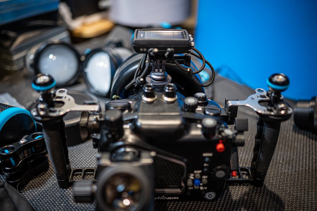

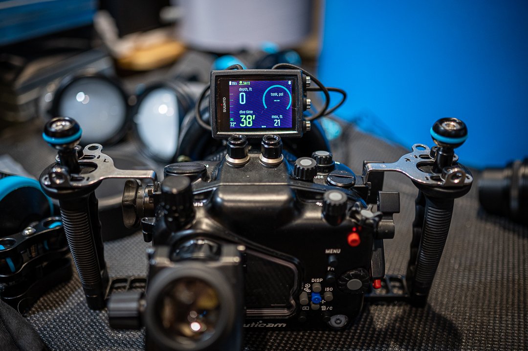

  20. old thread but found it useful so thought I'd share what I came up with... Used a cold shoe mount, a GoPro Quick Release and an adhesive mount to attach my computer to my housing. Rotates horizontally which makes digital compass use a bit easier.
    Once in the water, the carry lanyard for my rig gets clipped to the bungee wrist straps should the mount fail for some reason.
    It's still wrist mountable via the bungee straps, but the adhesive GoPro mount makes it uncomfortable to use without a wet/drysuit sleeve.
