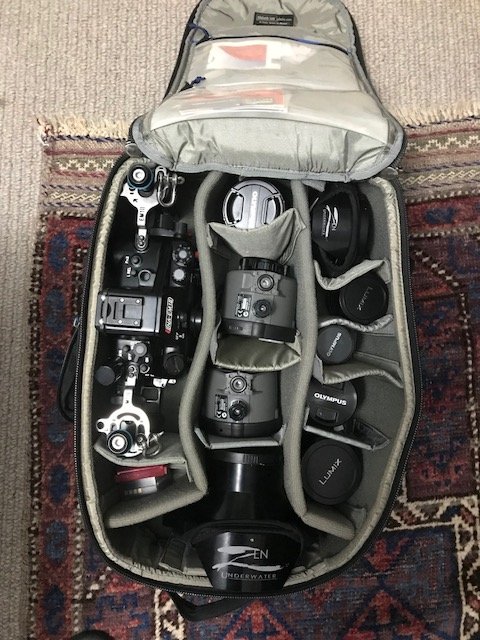

  17. For travel the volume is often a deciding factor - large domes are more difficult to travel with.  The size of the dome required for a 16mm full frame equivalent rectilinear wide lens scales with the sensor size as does the required aperture.  You now have an alternative to big domes in the WWL and WACP from Nauticam - but these are heavy and expensive.    Because the aperture scales, flash power also scales with sensor size.    Fisheye lenses though are pretty much the same dome size whichever format you choose.
    Here's my rig in a carry on size backpack.  It contains
    top row: 4"Zen fisheye dome, Pany 8mm fisheye , Oly 60mm macro. olympus 12-40, Pany 7-14.
    Middle row:  60mm macro port, 2 x INON Z-240, Zen 170mm dome.
    Bottom row:  Nauticam EM-1 MkII housing - camera inside spare batteries.  Laptop in sleeve underneath.
    In selecting your camera you might also like to consider battery life; the GX9 is CIPA rated for 260 shots while the EM-1 MkII is rated for 440 shots.  I can get 3-4 dives out of my EM-1 MkII.
