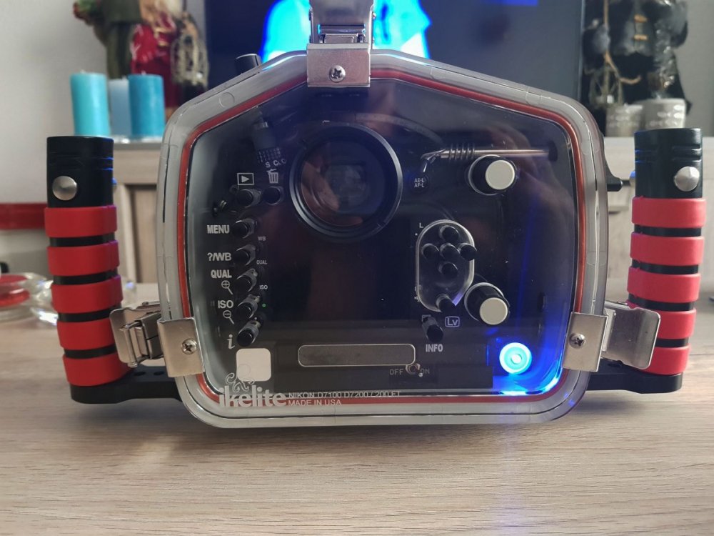

  17. Waiting for the final answer from my dealer if the Nauticam is gonna fit on my housing.   That damn delete button is really close to my original viewfinder.
    Nervous, while waiting.399588038_ikelitewithvacuumsystem.thumb.jpg.fe04e07345d5a57cd12aac29d9298144.jpg

  18. On 7/9/2020 at 2:20 AM, Chris Kippax said:
    I use a Nauticam 45 on an ikelite housing, cost $500 used and around $100 for the adaptor. Works perfectly
    Chris,
    can you measure the distance between the housing and the viewfinder.
    My dealer can't say for sure if it is gonna fit on my housing.
    The delete button is really close to my viewfinder.  The height of the button is approx. 6mm.
    Perhaps you can show it in a picture too?
    Edited by Adri
