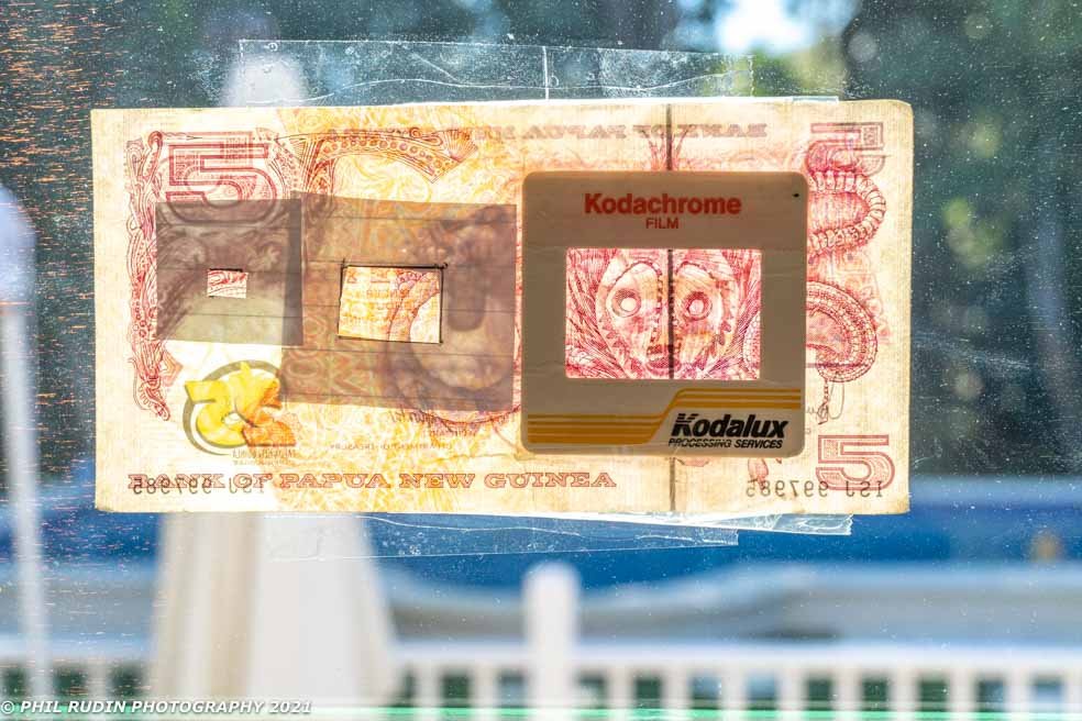

    Regarding the Sony FE 28-60mm with the CMC 1&2 the reason they can work on full frame is the same as the reason they work with WWL-1/1B. The diameter of the lens is very small for a full frame lens and therefore will work with the smaller glass. With the Sony FE 28-70 zoom the lens is larger and will only work with WACP and SMC C/U lenses. If you use CMC on this 28-70 the images will be soft at the edges. With the Sony FE 90mm macro the glass is bigger still and CMC will be softer farther into the frame.
    This has been made a bit more difficult than it needs to be. A macro lens for a given formate at one to one produces an image the size of the sensor. In the photo to the right is a slide mount and the bill inside the slide mount is at 1:1 for the 35mm size sensor, to the left is a paper cut to the size of a M4/3 sensor and bill inside is at 1:1 for M4/3 the very small cutout is a consumer compact size sensor and the bill is at 1:1.
