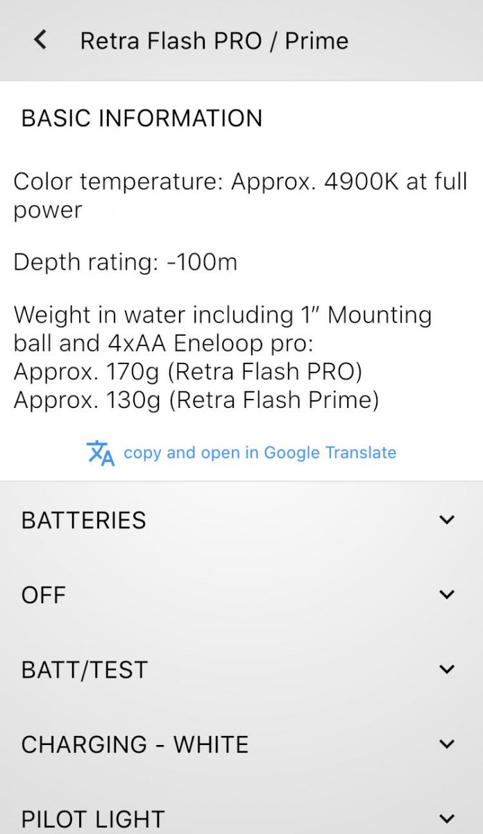

  10. Hi, thank you for the feedback.
    We update the user manual as we get more feedback from photographers reading it or as we add new features. The weight of the flashguns (in water) is already indicated in the "basic information" section of the user manual. We will consider adding more practical tech-spec in there for easier access.
    Thank you Oskar! However I only read the temperature of the light in basic information of the Retra app on Android and depth rating and that is all. Nothing else! Am I looking in the wrong place?
    Regards
    Andrea
    Sent from my LG-H870 using Tapatalk
  11. Thank you for letting us know, there is in fact an error. This information was not updated in the public user manual. We will amend it shortly. Meanwhile please find attached a screenshot of the information. 1833332215_unnamed-2020-09-14T071327_273.thumb.jpg.c1dd47efe4eca16910dbeae787dbb398.jpg
  12. I just want to add that complete technical specifications are available on our website at the bottom of this page: https://www.retra-uwt.com/pages/retra-flash
    Here you will also find information about the battery life at half power, dimensions, weight, etc.
