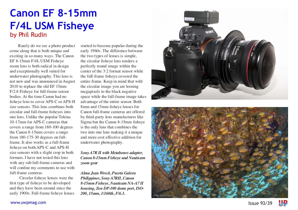

  10. I have attaches the front page from an older review using the Canon 8-15 zoom and Zen 100 port with the Sony A7R II. Higher MP's and full frame add to softness in the corners at F/stops below about F/13. Since this review I have used this lens with a verity of other cameras and dome sizes. Works very well for splits with domes of 200mm or greater. I have also used the Nikon 8-15 with Nikon mirrorless cameras with like results. I have also used the Canon with Canon full frame cameras and see no difference in AF speed or image quality with or without an adapter.
    This is a free PDF download at uwpmag.com at the top od the page in back issues #93/
