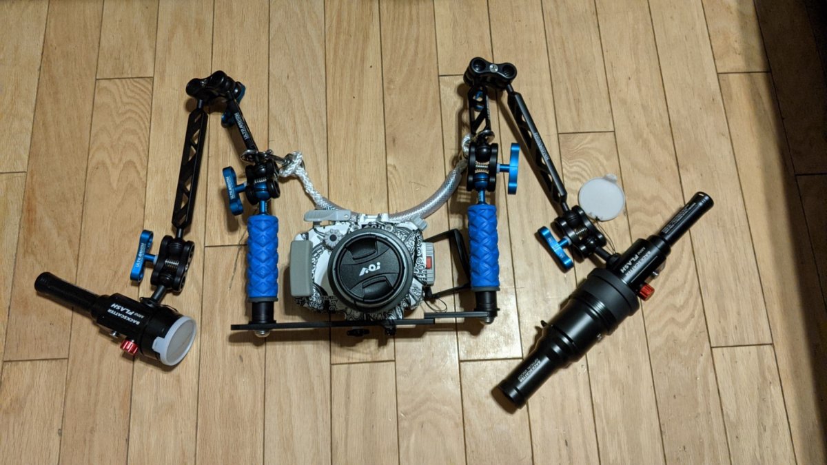

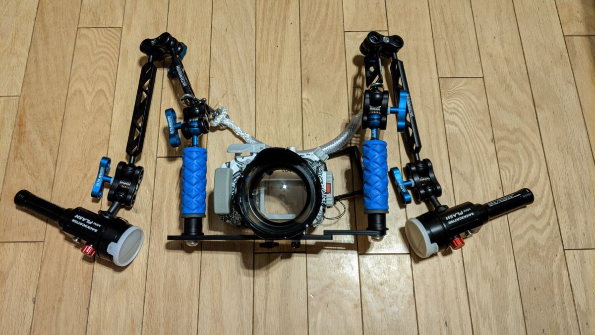

  7. I also just found this thread. I wanted to chime in because I just bought the Olympus E-PL10 and AOI housing from Backscatter.  I also bought the Panasonic 8mm fisheye and Olympus 60mm macro along with associated ports; backscatter did me a solid and got me an extension ring for the standard port for the 14-45 kit lens so that I could use the 60mm macro (its was like half the price as the dedicated 60mm  port).
    I upgraded from the Sony RX100Va (in a fantasea line housing without any strobes) to the Olympus Epl10 kit.  I am pairing it with dual backscatter mini flash 1 strobes.  I have been on 3x dives with this kit and I have really liked the performance of the 60mm macro.  My next few dives will be with the 8mm fisheye to see if I like CFWA or Macro better then I will focus on learning that skill set this year.  I dont find the olympus menu system too confusing (i came from sony so anything is better).  I find the camera easy to handle and straight forward to use.  I really like that I can use back button focus (i couldnt use is on my sony rx).  I am still learning how to use strobes, i havent done any strobe photography in the past.
    If you have any questions feel free to reach out.
    If you do any topside photography then you will also have access to the amazing line up of micro4/3 lenses.
