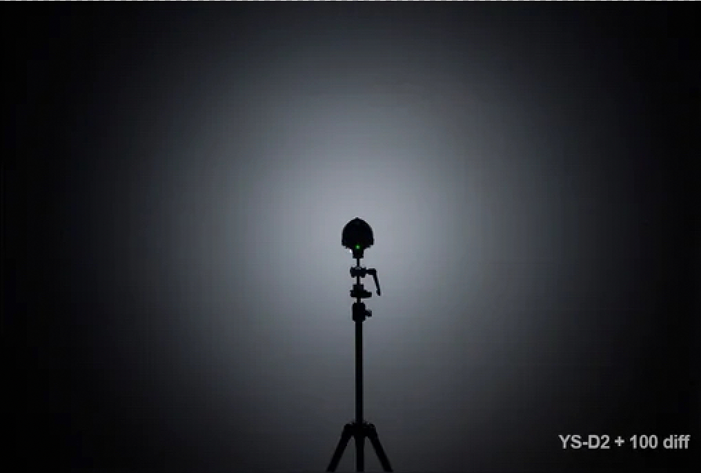

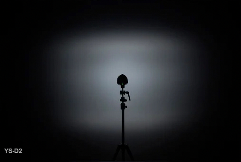

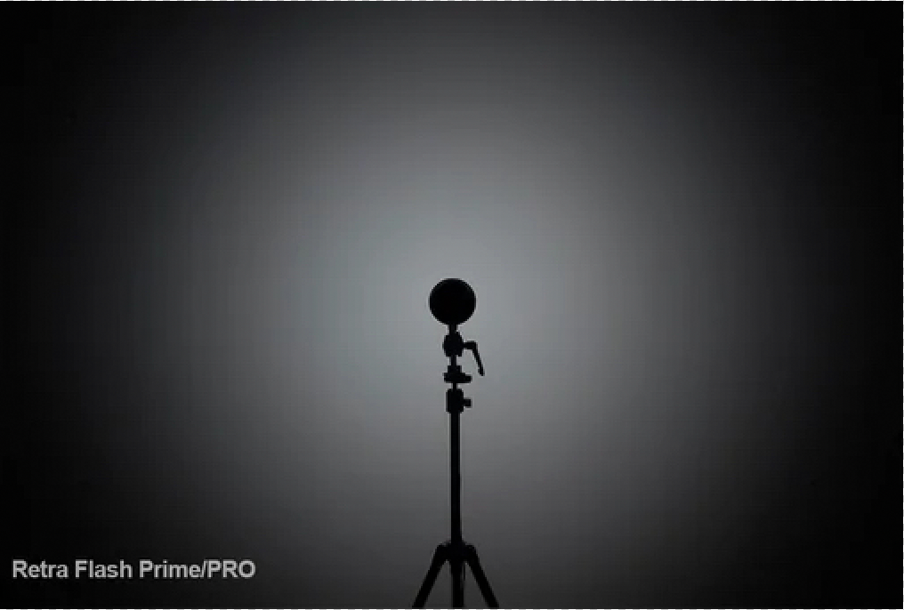

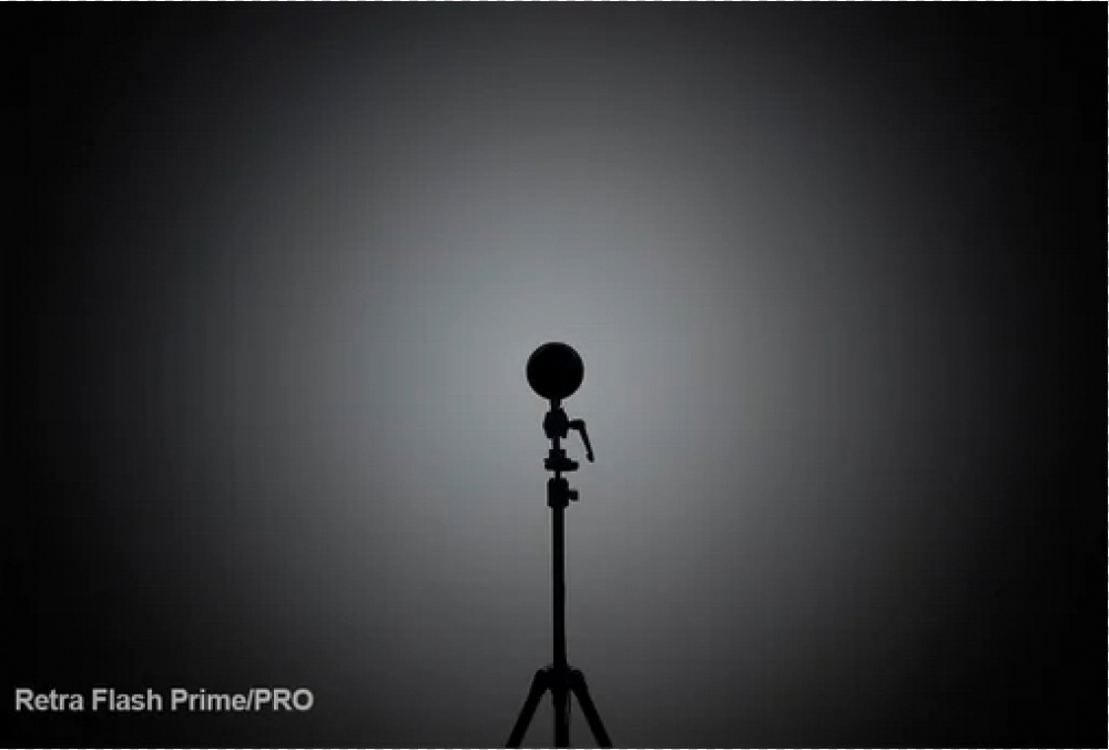

    I looked at your data time ago. If I understand well the image of the strobes is taken so that the power is the same at the center
    So I looked at my strobes sea and sea YS-D2 cropped the test shots and used photoshop to do some analysis
    This is the Retra Pro without diffuser
    311580263_Screenshot2022-09-08at21_28_53.thumb.png.5f2a0b722d6041fac3b224fcdf2b457d.png

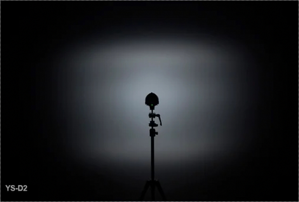

    And this is my sea and sea YS-D2 also without diffuser
    654276751_Screenshot2022-09-08at21_29_35.thumb.png.149eb5b2bb4a41f2862622000f0e28ee.png

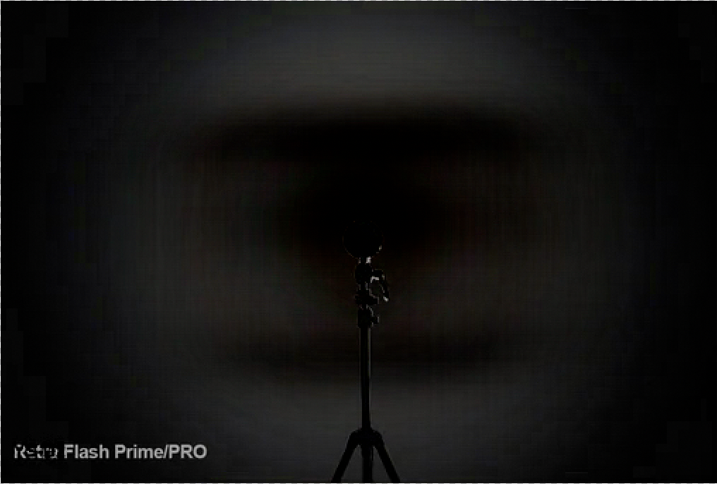

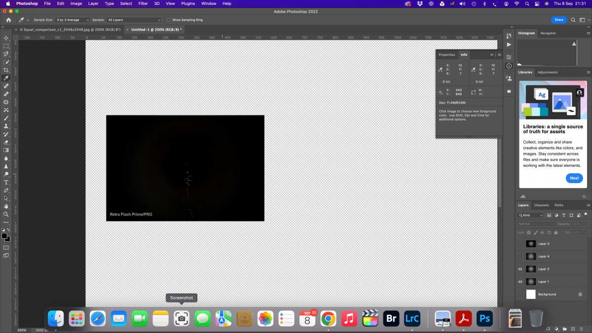

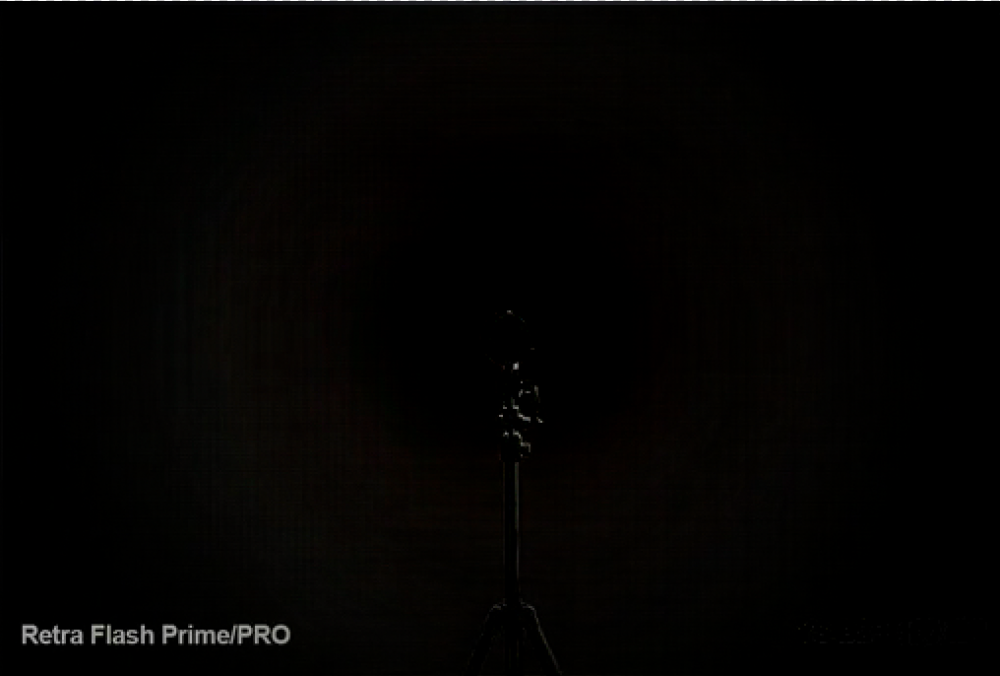

    I loaded those crops as layer in photoshop and I subtracted the sea and sea from the retra pro in effect I can see that there is a difference there are lighter areas where the retra pro is brighter
    218571632_Screenshot2022-09-08at21_29_58.thumb.png.02a2ca88462e2ca08a160e62bad01f42.png

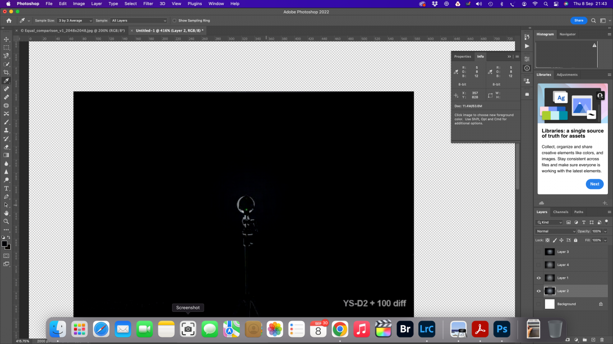

    However when I look at the sea and sea with 100 diffuser

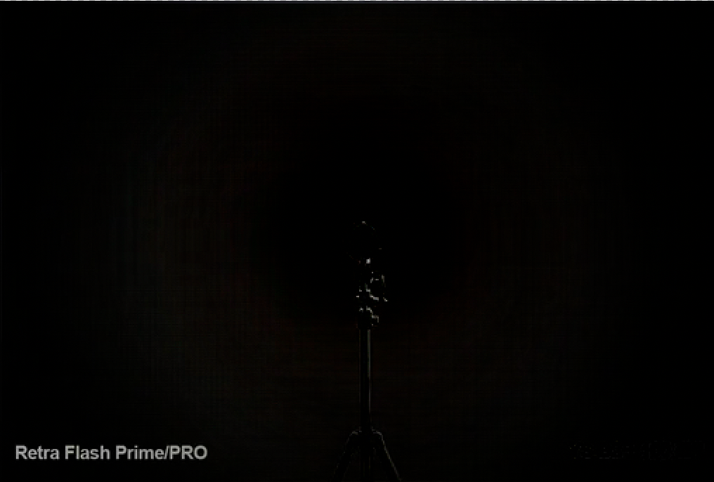

    1749897100_Screenshot2022-09-08at21_30_25.thumb.png.f82a22f15a18b8955d57e6edce60ebfb.pngI load it as layer and I subtract from the retra pro I obtain this result
    68391217_Screenshot2022-09-08at21_30_38.thumb.png.2a29664d3eccbcae7bcb100d31349839.png
    The frame looks pretty dark as if there were no differences between the two cases
    So I used the sample to see what RGB values I get and enlarged the image to 400%
    1659118242_Screenshot2022-09-08at21_31_10.thumb.png.57b90c9c5080ea65aff1e8bd192d104d.png
    There is a tiny circular halo midway between the strobe and end of the frame where luma measure at best 10/255
    If I subtract the retra from the sea and sea instead I have a little difference in the centre around the same 10/255 in total
    1601443787_Screenshot2022-09-08at21_43_44.thumb.png.bd3dfe0d0cc944e8f2be0916e3f14c4a.png
    It would appear that in your test conditions the differences between the retra pro and the YS-D2 are substantial but when you use the YS-D2 with the diffuser the differences are negligible. So my conclusion was that in those test conditions a powerful simple strobe with a plastic diffuser would perform quite well. If we consider that your peak measures indicate a difference of 1 stop between the retra pro and the sea and sea and the diffuser power loss is less than one stop than I would argue the table would turn.
    Tests of diffusers on land indicate that the spreading of the beam is quite effective using simple opal acrylic with various level of opacity. This simple concept that is extensively used also in commercal lighting seems to apply here as well.
    As flat strobes are always used with diffusers I do not see the point of comparing your device that has an opaque cover on the bulb with others that have a clear front.
    I also have to say that applying a diffuser to your strobe seems to have zero benefit in terms of light distribution because the strobe itself has in effect an integrated diffuser by design

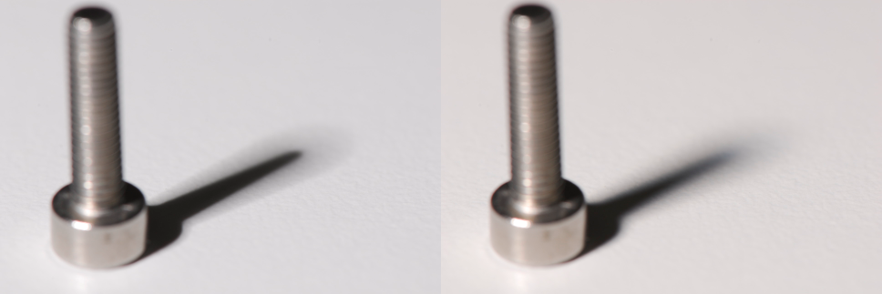

  9. There is no opaque cover/integrated diffuser on the Retra Flash PRO/Prime or the X models, the front port is completely transparent. An unaltered beam without hotspots and a wide coverage is our goal.
    When applying a diffuser to an already wide beam the result will not be obvious on a flat subject because the main difference is in the way the shadows are produced:
