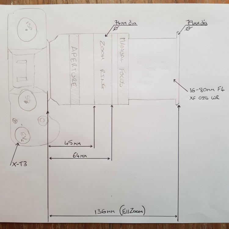

    I am looking to get a housing for my X-T3.
    I am on a bit of a budget (I know this game is expensive) so the Nauticam is out of my price range. I have seen the SeaFrogs SF XT3 housing ( https://www.aditech-uw.com/en/shop/4898-sea-frogs-sf-xt3-for-fujifilm-x-t3.html ) but am not sure how good they are.
    The lens I have is the 16-80mm F4 XF OIS WR and I can't seem to find any info on if this would be compatible with the housing and port options.
    I ave attached a diagram of the body with lens attached (my drawings aren't the best) to see if maybe someone has the housing and could possibly judge if my set up would fit.
    Any help would be really appreciated.
    Thanks Joel

  2. Personally I'd steer clear of Sea Frogs, some people love them but the port availability is pretty poor.  Plus some controls are not accessible:
    Some functions are not accessible:
    • Front command dial
    • Rear command dial
    • Aperture control of the lens
    • Focus stick (Focus lever)
    If you're on a budget look at Ikelite, their port chart is here:  https://docs.ikelite.com/reference/port-chart-dl-fujifilm.pdf
    They say:  Controls are not provided for Fn1, Fn2, Touch screen, Focus mode selector, Focus stick tilt or Diopter adjustment knob; Front and rear dials may be rotated but not pressed
    This is probably part of the reason Fuji are not that popular underwater - the housings are hard to build to get at all the controls and lens availability that are really suited to underwater is limited.  You'll note ikelite doesn't have a port for the Fuji 60mm macro lens ( which in any case only gets to half life size by itself) so you would need to go with the expensive 80mm macro if you wanted to branch into macro.  I believe Nauticam provides full access to controls- part of the reason for the price.
    You will note that Ikelite recommend a +4 diopter with this lens and 8" dome - that will be because the lens doesn't focus close enough to focus on the virtual image of the dome port.  This will of course degrade your image quality a little.  The sea frogs has a 6" dome which would have even more problem reaching focus on the virtual image, so probably need a more powerful diopter - probably why Seafroggs don't list it.
  3. It may be more financially viable to go with a different system for UW than for above water...
  4. Thank you for your feed back and advice it is really appreciated.
    I think I may be better off selling up and changing to a Sony system.
    Seing as the market seems to be flooded with them at the moment, second had stuff should hopefully be fairly easy to come by at reasonable prices.

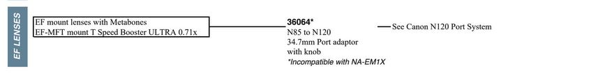

    How prescriptive / complete are the Nauticam port charts?
    Eg, on the Fuji-X chart, it shows that CMC-1/2 are available for the Zeiss 50M on the N100 flat port, and the SMC-1/2 for the 80mm macro on an N100 flat port, but neither is available on the 60mm macro. I would've thought that with the 60mm being only a 0.5 macro vs the 80mm being a 1:1, that it'd be more useful to have the CMC-x in front of the 60mm?
    Is it that the port chart doesn't go into every available option, and just gives from guidelines, or that the combination just won't work optically?
    Also, it doesn't state why the CMC/SMC options are in blue text.

    The port charts represent what has been tested as far as I am aware, so I would expect they didn't test that combination,  perhaps the thinking is that serious macro shooters would use the 80mm lens??    There's no reason they wouldn't work on the 60mm, the lenses reduce the minimum focus distance to increase magnification  and you have about 175mm of working distance on the 60mm macro to play with, but it may be that you just don't get enough magnification to make it worthwhile with the 60mm?

  20. Typically for other camera brands, the solution is an adaptor a zoom knob that is setup to use the Canon zoom gears  for example this line from the Nauticam m43 port chart:
    The zoom gear is in the right spot to accept a Canon Zoom gear.  Such a solution is probably possible but it would involve a bit of testing and trial and error - not least of which is whether or not the adapter works well between the Fuji body and Canon lens for AF.  It relies upon the adapter flange being in the same spot that a Canon DSLR lens mount would be.
