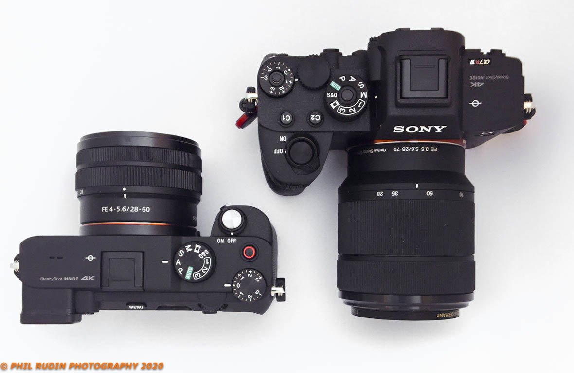

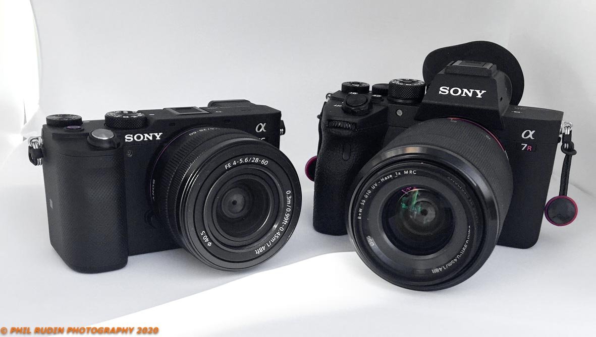

  19. Nauticam added the FE 28-60mm lens to its Sony port chart and Sony owners should be excited. First the lens works with all Sony FF cameras. It also works with the excellent but not cheap WACP-1 resulting in an AOV of 130 to 68 degrees, the older Sony FE 28-70 goes to 59 degrees. The new Sony FE 28-60mm also works with the less expensive WWL-1 which until now only worked on Sony mirrorless with the SonyFE  28mm F/2 so young  have the same added zoom range. Because the 26-60mm lens takes a 40.5mm lens filter the diameter is small enough to work with the sub-full frame CMC-1 and CMC-2 closeup lenses that many M4/3 and APS-C owners now use. At this time Nauticam lists the Sony FE 28-70mm with Techart Sony to Nikon Z AF adapter for use with WAPC-1.If you want a zoom lens for the Nikon Z system and WACP-1combo the Sony 28-70 is the only choice. Sony and Nikon Z both use the same 120/20mm port extension for the Sony FE 28-70mm and WACP-1. No port extension is required with the Sony FE 28-60mm and WACP-1 so I would expect the same may be true for Nikon Z and WACP.
    I would also point-out that Nauticam WWL-1 was designed for full frame even though it has been widely adopted for sub-full frame cameras. Even on high res full frame cameras like the 62mp Sony A7R IV results are excellent and superior to any wide angle lens and port combination I have tested. You can read my review of the WWL-1 on full frame in back issue #114 at uwpmag.com.
    I have attached photos of the Sony A7c with 28-60 zoom and A7R IV with 28-70 zoom for a size comparison.
