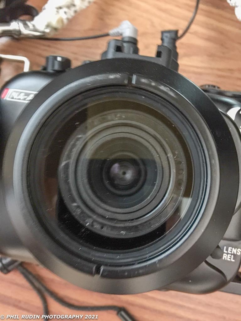

    What I’m wondering about is the 28mm end of the 28-60 behind the flat port. My understanding is that the lens extends as you zoom towards 60mm, therefore leaving more room between the lens and the flat port 45 at the wide end.  Has anyone noticed any difference between the 2 lenses on the wide end with the WWL?
    No what happens is it's a retracting design that you need to extend before you use it.  It is shortest in the middle of the range and gets about 5mm longer at the wide and tele ends so no problem getting the full angle of view.  Phil Rudin has posted a lot about it here and no vignetting is reported that I recall.
  2. Not a very sharp photo but you can see that at 28mm the lens is very close to the port glass and the difference at the 60mm end is almost identical 1mm +/-. As stated above the lens retracted around the center of the range, this is common for a lot of the newley designed mirrorless lenses. So you do get the full 130 degree AOV with both the WWL-1/B and WACP which uses no port.
    To answer the question regarding the difference between WACP and WWL-1 on A7R IV I have not done any extensive tests in that regard but my limited observations are that the WACP is better in every way. The question is a bit like asking which is best WACP or the S&S conversion lens. You get what you pay for and eliminating the port and the need to shoot through the flat port glass bumps  image quality noticeably in all areas.
