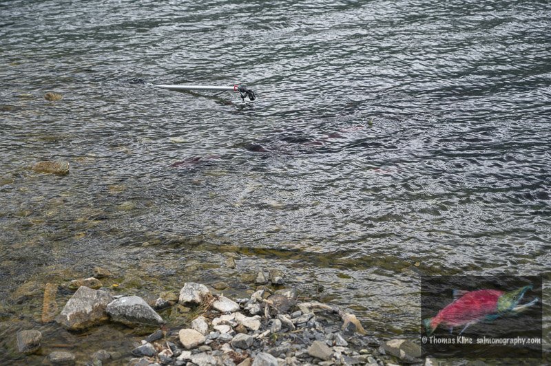

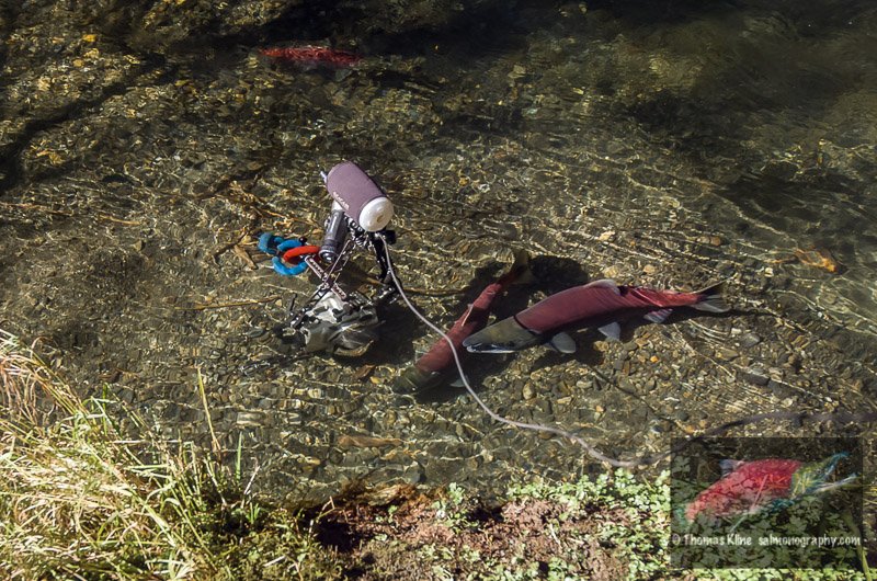

  4. One of the main reasons for me to use small dome ports is because the water is too shallow to use a large one. I have used the Seacam fisheye macro port FMP and wide port WP for this with the Nikkor 10.5, 16, and 8-15mm and Canon 8-15mm fisheye lenses. The WP is not made for fisheyes but when the fisheye lens used with it is focused very close, it will not vignette. The WP is also the least expensive Seacam dome and given that the ports are often scratched by rocks being tossed at them by my photo subjects need to be considered expendable.
    First attached shot shows a Sockeye Salmon pair preparing to spawn. The other pix show Sockeye Salmon gathered at the mouth of a creek located about 2 km away from where I am sitting. They are gathering here prior to final maturation to beach spawn in the lake around the mouth of the creek. I planned on staying here several hours to do the shoot..... The creek as you can see is very shallow - Pink Salmon spawn here. Even the FMP is too big to fully submerge at some some spawning locations in the creek. I have used this creek to do a number of tests over the years (because it is so close and fairly clear).
