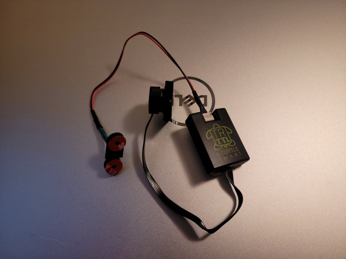

    Hi Balazs,
    I emailed this question and never got a response. Maybe I can learn here.
    There are 3 images of the S-Turtle Trigger for Sony Mirrorless from your website. Can you please explain what the difference is between them?
    Also, how do I know which is the correct one for my camera and housing?
    Also, when trying to order one from your website, it does not give me an option to choose between these 3 different triggers, so how do I know which one I will receive?

    I sent you an email that said:
    "Hi Balazs,
    I received my S-Turtle Smart trigger for Sony Mirrorless today, from Bluewater Photo Store. Picture attached.
    This is for use with my Sony a7rIV camera, in a Nauticam housing.
    I have a couple of questions:
    First, it appears they sent me the Mobie version. What I received has the hotshoe separated from the trigger with a short cable.
    Should I return this for the non-Mobie trigger, or does it matter?
    Second, your website says these triggers come with a charging cable. There was no charging cable in the box.
    Did they send me an old version of the product that didn’t come with the cable? Should I have gotten a charging cable with it?
    Third, the LED emitters on this do not look correct for my setup. Your website has pictures of LED emitters that are set in the top of stalks that would stick up inside the ports of my housing.
    Don’t I need a version of the trigger with that other type of LED?
    Thanks.
    -    Stuart"
    The email had this picture attached.

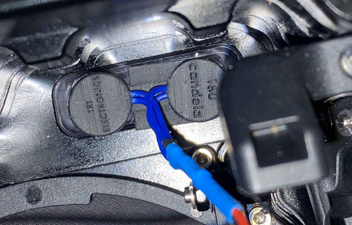

    I am using a Sony A6400 in a Nauticam housing. I bought the S-Turtle Mobie to use fiber optics over a long run, think underwater studio and don't want to use the pop up strobe.
    OUT OF THE HOUSING I've triggered my Sea & Sea YS-D3's over 20ft using Asahi 613 multicore with the end directly touching the Turtle. LED's. IN THE HOUSING I've had absolutely ZERO luck trying to get the YS-D3's to fire. ZERO.
    Also there seems to be no way to easily align the LED pads of the Mobie to be exactly centered. I am open to all suggestions. The A6400 housing seems to have a prism built in as well?
    -Scott

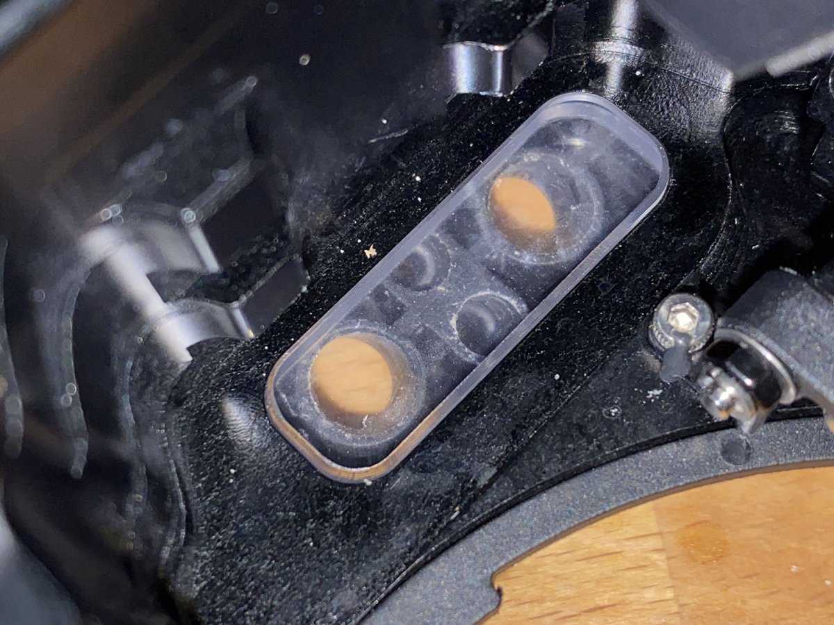

    Just to confirm you cannot trigger the YS-D3 over any length of cable when the trigger is in the housing?  Certainly would seem to be an alignment problem.  How are they attached - it looks like it uses stick on pads?   It seems it would be critical to centre the LED directly over the fibre.  The prism is probably not helping  if indeed it is a prism as you would need to centre the LED optically.
    Questions about the flash window - looking at pics in the manual to it looks like the flash window is flat on both sides and the plastic moulding with the ports for the fibre optics looks like it is sloping upwards.  It is impossible to confirm this without the housing in the hand.  I would suggest to take off the moulding with ports to check.  You can undo the two allen screws above.  See this pic:
    Then try to align the fibre end over the LED in the window and try triggering again.  If this works you need to come up with a way to hold the fibre optic ends square on to the window and aligned with the LEDs.   I know other housings have fibre optic port plate that holds them square on,  The arrangement probably works with the built in flash as there is so much more light.

    Hi Chris,
    That's exactly right. Any length of cable outside of the housing. And yes, it does use stick pads to attach. Probably going to need to find more as these already not sticky from all the fussing around.
    So, the tubes on the front are angled down to what looks like a glued in prism I will remove the front tomorrow and see what I actually find.
    -Scott

    First thing to do would be to try and trigger holding a bare cable on the prism - square on - before you remove the pads on the inside - if that doesn't work you are going to have a struggle triggering them in any way.

    Hi Chris,
    Took the molding off and tried firing off the glass with a fresh cut of wire. Zilch, nothing. It's crazy because I have the newer 150 LEDS on it the cord and they are BRIGHT. But something is happening in the glass that is diffracting the light.
    I can even get cheap toslink cable to fire outside the housing.
    I have an older YS-D2 that I tried with too. Fires flawlessly outside, put the glass between it and nothing.
    I guess next step is to reach to Nauticam. I've spoken to Balazs at length as well. And this has stumped him.

    4 hours ago, ScottAudette said:
    Hi Chris,
    Or finally kit out my 1dx II housing i bought this summer. LOL.  (but I really love this A6400 kit its been a lot of fun!) And using the strobe pop really isn't an option because of the pre-flash. I'm shooting manual and need the ms of shutter lag to be short as possible.
    -Scott

  13. 22 minutes ago, stuartv said:
    Are you saying that the YS-D2 also does not fire when the LED is going through the housing's glass?
    that is correct. once the LED's are behind the glass in the housing i get nothing. I've tried three different cables. And I'll have to ask around about another strobe. I don't have anything else handy.

    Is the window flat or is it indeed a prism?  With the housing in hand you should be able to tell by inspection.  Have you tried moving the cable around on the outside surface, if you place it over where the LED appears to be you would have to think that would be fine.  The other test you could try is to see if it will fire through window glass.  Do the LEDs appear to be square on to the glass?
    Just to be complete have you tried triggering through the housing glass window with the onboard flash?
    edit, your reply came in when typing :
    it certainly seems like the transmission through the glass is marginal if a bit of dirt gives you trouble.  I imagine that window would get rather grotty as it is never gets cleaned and has water drying on it all the time.
    Edited by ChrisRoss
    Hi Chris,
    Not a prism, it looks like. Fired with flash. Tim, hit the nail on the head. Cleaned the glass and the trigger started working! LOL
    -Scott
  18. 3 minutes ago, ScottAudette said:
    Hi Chris,
    -Scott
    good that you've got it firing,  seems odd that dirty glass was enough, your photo showed it looking grotty but not terrible.  Keeping it clean might be a challenge, I assume it's because water has dried on their leaving deposits constantly, because you can't wipe it down like other windows on the housing.  I use a blower bulb to blow water out of there when drying off the housing after rinsing.
