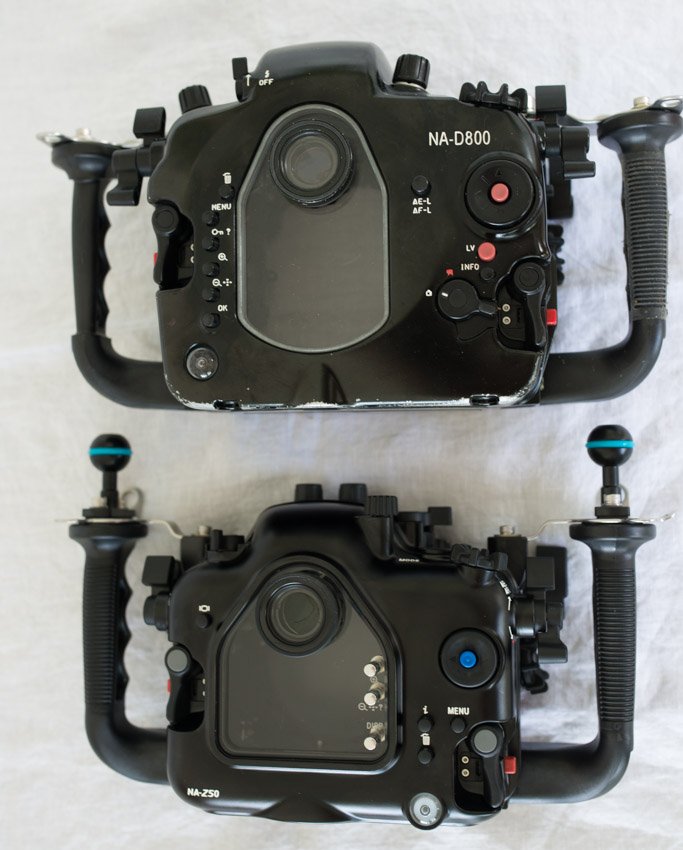

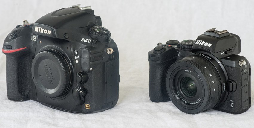

  4. Another size comparison, D800 and Z50. For me the attraction was being able to use the WWL-C rather than a dome and extensions. Having used a 12-24 on a D7000 with a big dome (and the 16-35 on a D800) I would much rather deal with a little barrel distortion (usually imperceptible)  than all the grief big domes and extensions bring to the party. The Z50 set up with the WWL-C weighs about 3.5kg less than the D800, 16-35, 230mm glass and extension. The Z50 uses the same sensor as the D500, but has a pop-up flash for optical triggering.
  5. Just a word of warning... The on-board flash of the Z50 appears to work only when the fully charged light comes on. So on continuous high it comes to a halt very quickly, even set on manual 1/32 power. And then you have to wait. With a flash plugged into the hotshoe, it will shoot at continuous high. The D800 also has this issue, but has quicker recycling time. So maybe a hotshoe flash circuit board has some merit!
