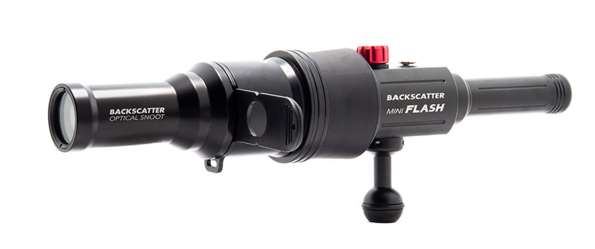

    I picked up the Backscatter MiniStrobe/Snoot combo last year during the 1st Wave Covid fire sale for about $315 (it's $499 right now).  It is MUCH easier to use than any other snoot setup that I tried before.  It's precise and has zero offset from the aiming light. It's purpose designed for snooting and it far more precise and flexible than any other product I've seen from Retra, Inon, ReefNet, etc.  If you can borrow or buy one I highly recommend giving it a try.
    I pretty much always use this when I set up for macro, paired with one of my Inon 330's.  I put a little bungie clip on the snoot part connected to the ball mount so I can add or remove the snoot at will.  It's easy enough to use that I can take snoot shots of even swimming fish pretty simply.
    The Backscatter Ministrobe is also a very good choice for a beginner starting with Macro photography.  It's a great little strobe for only $399, or $499 with the snoot.
    Backscatter Mini Flash 1 & Optical Snoot Combo Package
